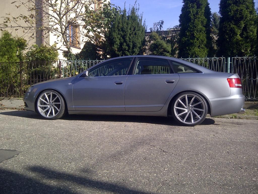

    hey i would like to know if these would fit? I saw a set of vossen wheels front 20x9 et 32 and the rear is 20x10.5 et 42 that im thinking about buying. Will these fit and what size tires can I use? I just purchased a 2005 a6 . It is not lowered yet but I it is in the plans for the future. Any input is welcomed.
  2. #82
    Established Member Two Rings neimaD's Avatar
    Nov 06 2013
    128742
    Poland / Śląsk
    Quote Originally Posted by lazyeye7 View Post
    It's good set. U can use 255/30 size, but if I'll buy new set I will be thinkin' about 2x 20x10
    Wysany z OOOO
    9 x 20
    Et40
    245/35/20
    Bilstein B14 suspension

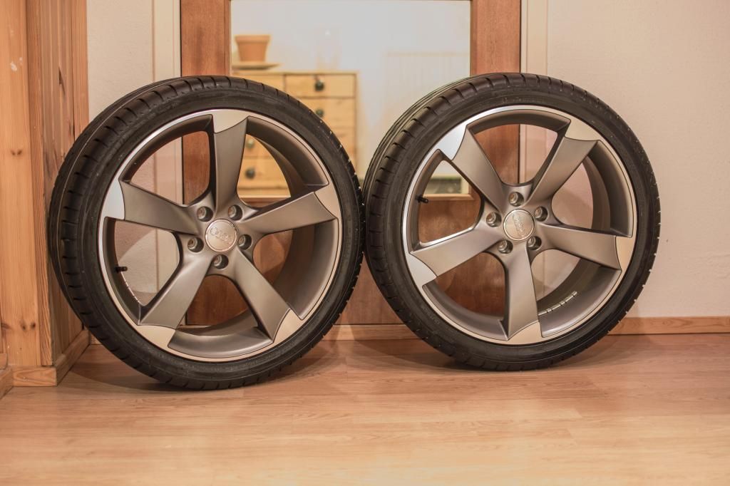

    Anyone tried 19x9 ET33 255/35/19, any rubbing etc?
    Found a set of four RS6 style wheels for A5. Tires are 85% (Dunlop Wintersport 3D) new and the wheels are oem for 1300$
    Audi A6 4F

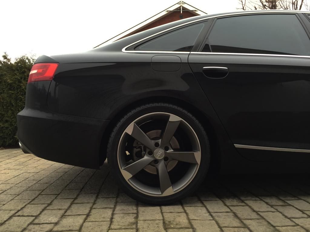

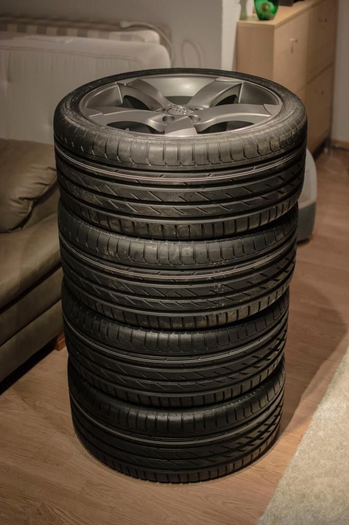

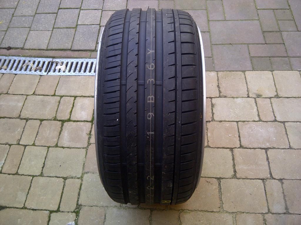

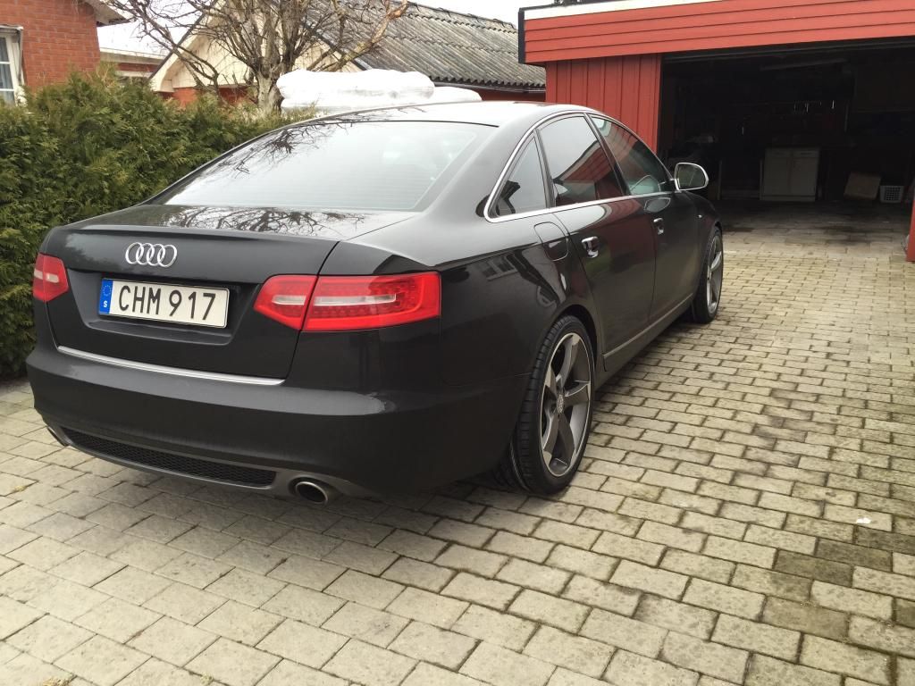

    Tires are here. Nokian ZLine 255/35/19 XL
    Audi A6 4F
    2.0 TFSI - 232bhp / 380nm
    S-Line
  25. #105
    Feb 06 2013
    109039
    CA
    Nokian's are GREAT!
  26. #106
    Senior Member Three Rings vajking's Avatar
    Mar 21 2009
    40178
    Audi A6 4F 2009 2.0 TFSI
    Sweden | Balkan's
    I hope so :) My colleague had the same tires on his 330i 06- Was impressed with them so i dont see that it would be any different on a fwd audi :)

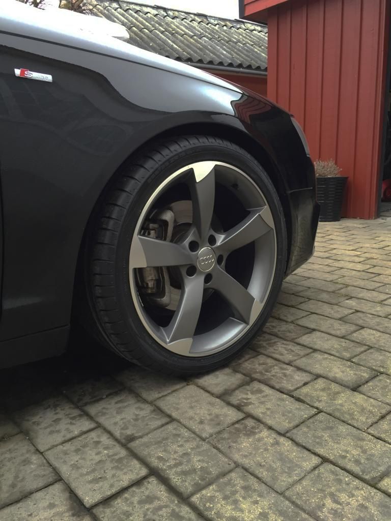

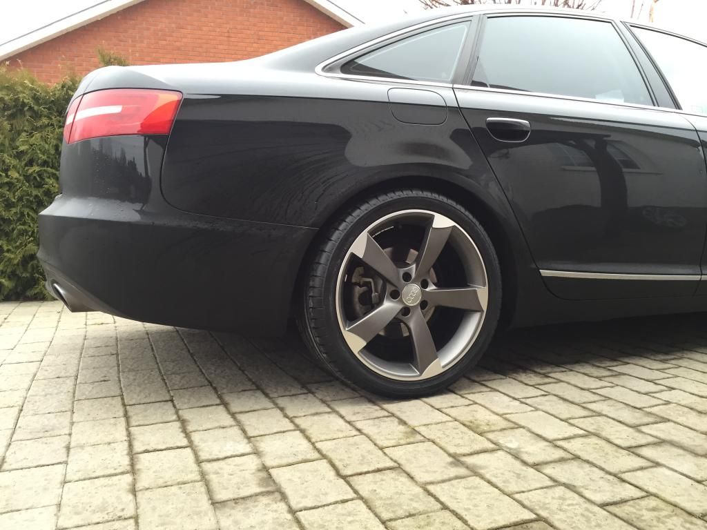

    Tried them on today. Thin it looks awsome. But irl its even better.
    Audi A6 4F
    S-Line

    Quote Originally Posted by vajking View Post
    [url=http://s241.photobucket.com/user/vajking1/media/IMG_3117_zps9oltfams.jpg.html]
    Looks great!! But where do you have your snow?? Shit, we have so much snow up here that we can't barely breath.............. bet u live in the better parts of Sweden. (skåne)
    AUDI A6 2.8 QUATTRO 2008
  29. #109
    Mar 21 2009
    40178
    Sweden | Balkan's
    Quote Originally Posted by hyped View Post
    Blekinge actually :) But right at the border with Skåne. We had snow like 2 times this winter, I dont think it was over 2cm. I want the real nordic winter and not this prolonged autumn shit. :D
