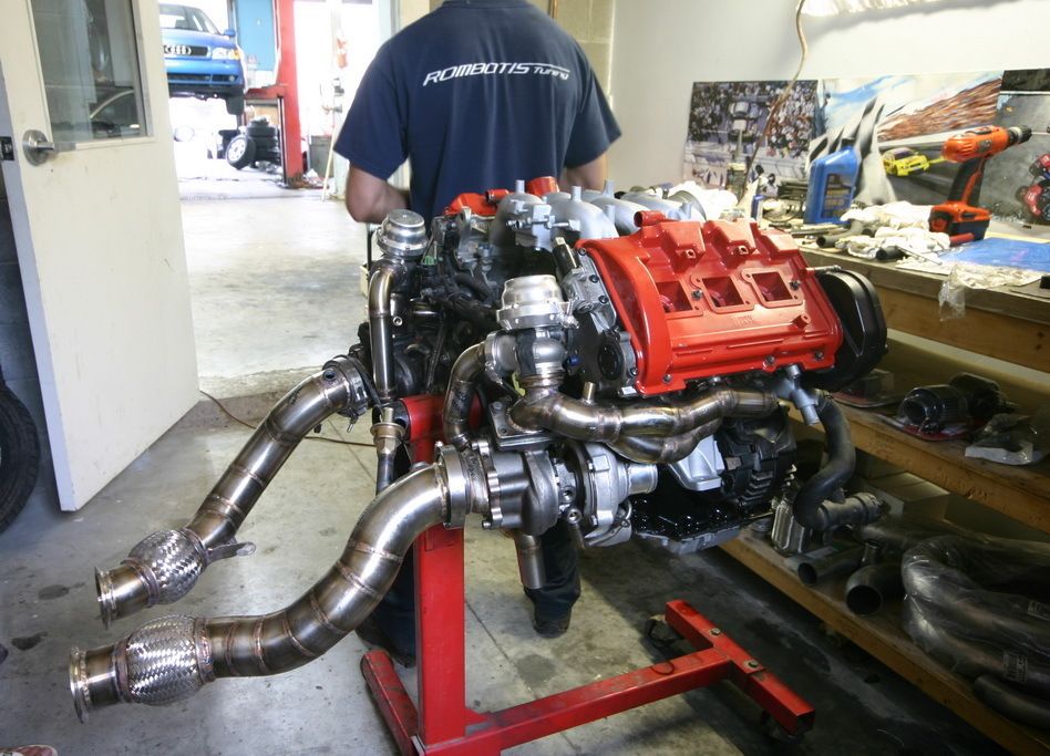

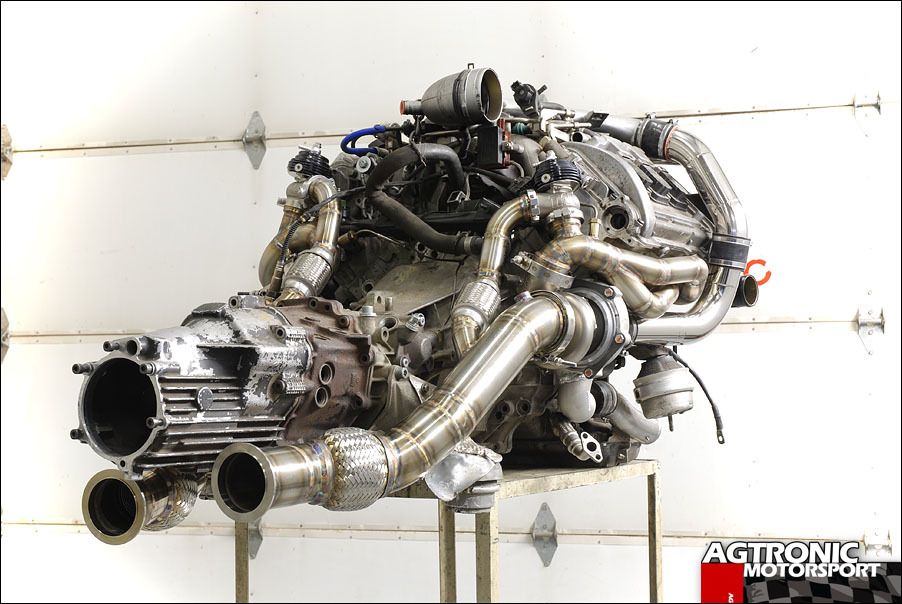

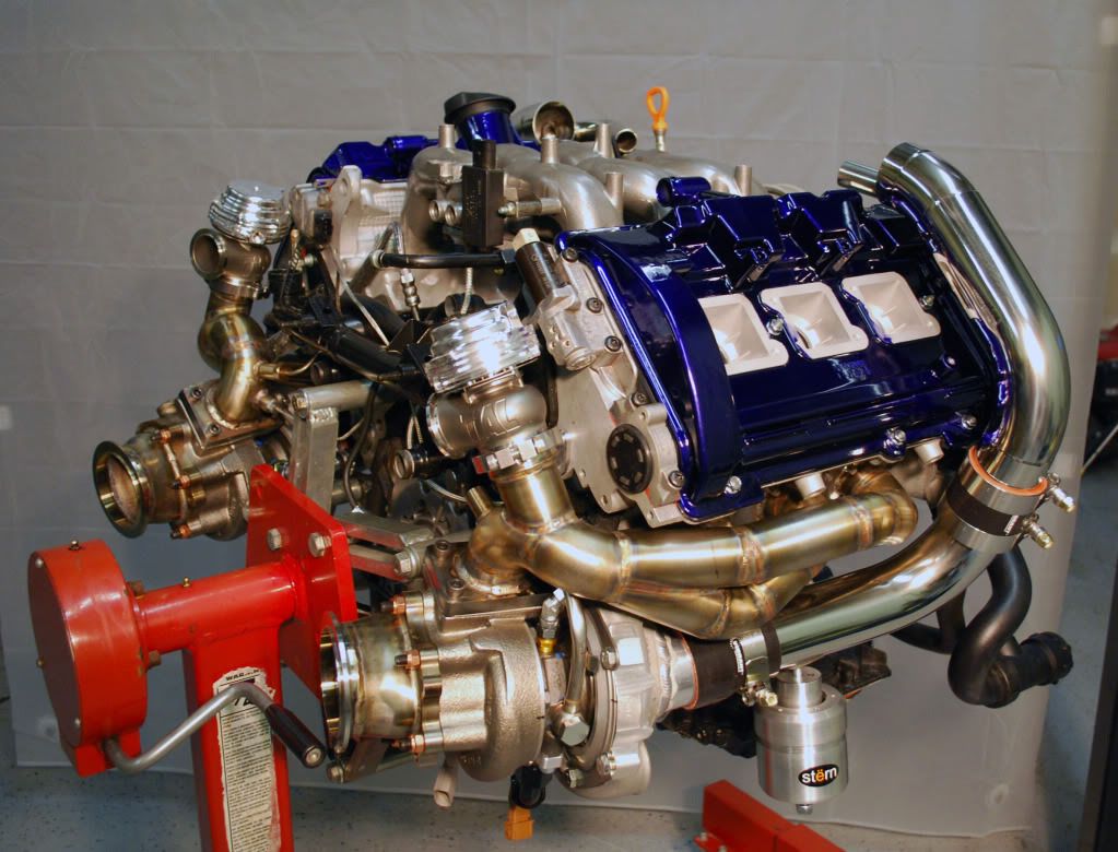

    I'm not the most turbo knowledged but I am learning, so here is what I want to know. I want to do a setup with a external waste gate like in the pictures i have posted. mainly cause i want to do a vent to atmosphere set up, so the first thing I was wondering was are these exhaust manifolds custom or an aftermarket cause they are all pretty similar, but i did see some key differences which led me to believe they were. and my next question was can you take a Turbo set up like the K04's or the JHM RS6R's and use them as external waste gates over the internals they come with stock? any help or info would be great. I also plan on doing my VTA like the guru pic where the wastegates have a pipe leading to underneath the car that way no fumes will be going through the firewall, etc.
    if these are custom exhaust manifolds are their specs i could give a shop to go off of so they could make some without having to pull some off of a junk yard 2.7t or anything of the sort?

    The problem is the gaping hole in the turbine housing.

    yes it's possible but alot of work and I'm not sure if the gains will be worth the effort. However I'd suggest divorcing the waste gate flow via the down pipe not by adding an external waste gate.

    it can be done, but is not ideal with the placement of the turbochargers on these cars...
    You could weld the flapper shut and add an external gate to the downpipe/manifold/wherever... but why.
    The internal gates work fine for this app and would allow for more room, *lol*, than externals....

    I just simply love the sound of a vta. I wouldn't route these to the downpipes, I would have a setup like the gruman one where his wastegates have a small pipe leading under the car.
