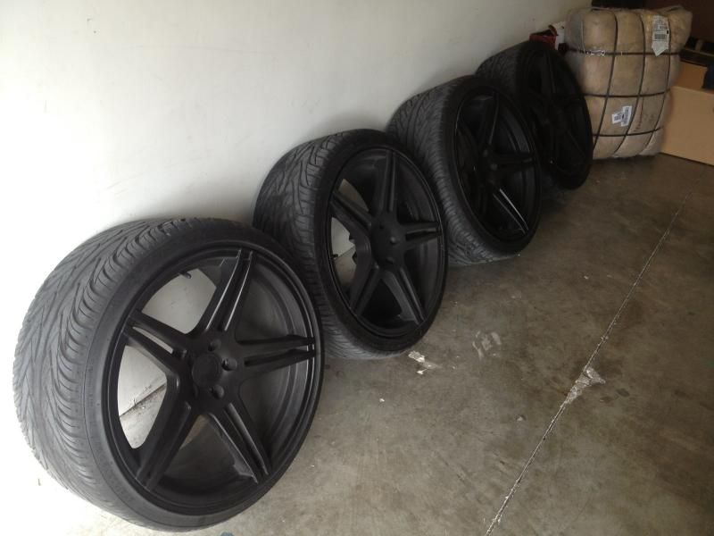

    Hey guys and gals. Im trying to see if these will fit before I make a deal with someone.
    20x9 245/35/20
    20x10.5 rear 275/30/20
    5x112 offset 35 front and 45 rear..
    Will this fit my 2013 s4????
    Thanks

    In short, no, the 10.5 on 275 will NOT fit. Likely not 10.5's period unless you are willing to get really nasty with neg camber and stretch. Still yet, I feel you would rub on the suspension. But im no expert on chariots.

    Like Mops said, the rear wheels will likely have clearance issues but the tires for sure won't fit. The fronts would be okay.
    But why not just get a square set of 20x9 ET40 HREs with tires that will fit for certain

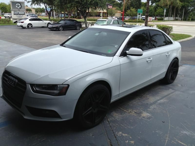

    I agree with you guys and now I just got a picture.. This confuses me because I guess it fit LOL
    What do you think about these rims on my car?
    Sep 28 2010
    64971
    NW NC / DE
    Ahhh, thats terrible. Those do not "fit". The car still rolls with them mounted along with a 1" suspension lift/add-a-leaf kit, but you would never want to run that. That is an A/S5 fitment. Are they Incurve?

    Established Member Two Rings Jonathanb8s4's Avatar
    Aug 06 2013
    120409
    Sunrise, FL
    Yes they are incurve rims. My concern is I am not trying to ruin my car. No.... I don't race the car or do autocross, but at the same time, I don't want to ruin the ride of the car.
    They are currently on an A4
    Sep 28 2010
    64971
    NW NC / DE
    need some help ASAP!
    That person definitely picked those up from 5. Pass for sure. Look for a nice 9"-9.5" square setup and make things easy for yourself.
