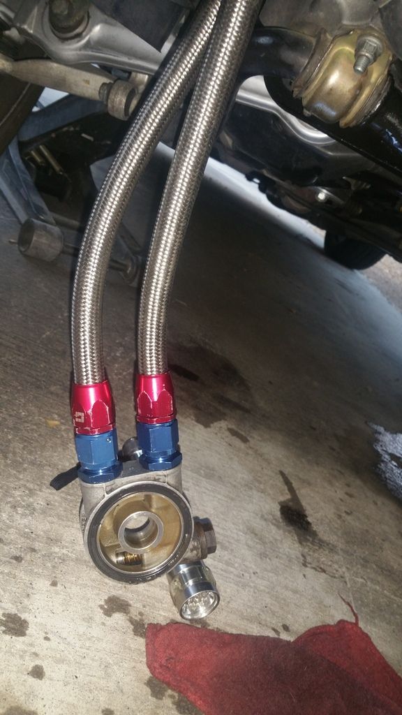

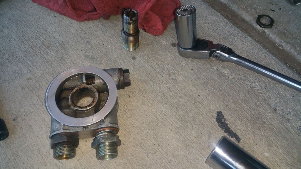

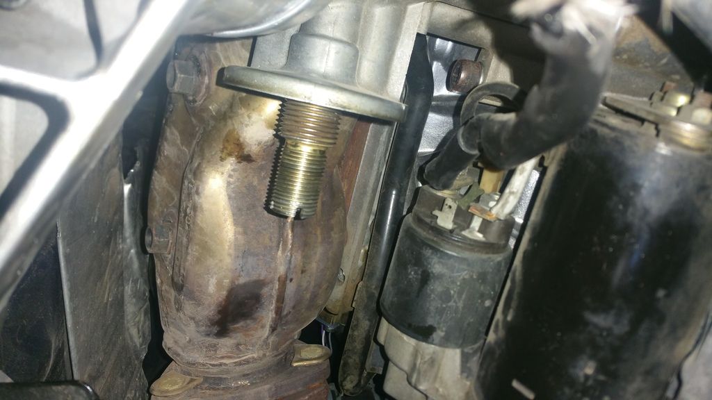

Hey Audihere!, you said you ordered an RS6 upper engine mount bracket/oil cooler with the sandwich plate. It sounds like you simply removed the sandwich plate and the threaded pipe from the RS6 engine mount bracket/oil cooler, and installed them to your engine's mount bracket/oil cooler -am I right? So all you really needed here was the sandwich plate and the threaded pipe?
-If that's the case, I was considering doing the same, but I have found an oil cooler/engine mount with the sandwich plate and the threaded pipe holding these together, from a 4.2 Toureg. I'm thinking this should still be fine, since I should expect this oil cooler should be the same as the RS6's oil cooler mount -with a removable threaded pipe, long enough to hold on the sandwich plate.
http://www.ebay.com/itm/Olfiltergeha...0AAOSwSlBY0tSi
What do you think about this plan? Nollywood, do you think this is a good way forward? I could keep my oil cooler that's already on my engine, and replace the threaded pipe and add the sandwich plate. -I hope this will work, as the mount/cooler from the toureg is half the cost -or less- than the RS6 specific mount.
