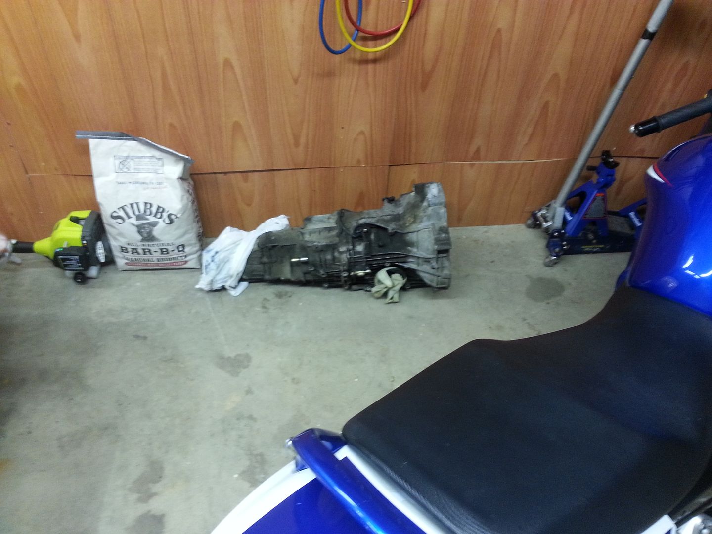

    Hey guys it's been awhile I have not really been on much and have missed it, but life has been crazy and time gets away some times. anyway Im trying to get wrenching again and to start I fear the Trans will be next on the list of things to do! what fun this will be. So about 6 months ago I notice that going into 2nd and 3rd when pushing the car would some times hang up and not let me get into gear right away. this has gotten worse and now 4th will to it too. If i dont wait and try to force it into gear they will grind not a fan of that so for the most part now I drive my car at 50% or less other then a single 3 gear pull or something. I dont believe this is a clutch problem Im think maybe I have damaged my gear synchronous?
    I did not think I was making enough power to do something like this if this is the problem. All new gear oil ect during build so that only has 5,000 miles and the trans just hit 100k on its total life.
    what do you guys think or has anyone hear of this before? Let me know
    Thanks
    SOLD the GOINHAM A4 ---> GT2860 Project

    Would not expect that with a GTRS. What type of gear fluid did you use?

    Fluid might be a little too thick for the weather your in at this time. How much power the car makes doesn't really effect the syncros, those just wear over time and high amounts of gear changes. Another thing you can do is try bleeding the slave or maybe even seeing if a longer slave rod will help if the disk is some how dragging. Could even be an issue of the disk not sliding freely enough on the splines of the input shaft.

    I will start with the slave. thanks mike

    Update,
    I did the bleeding following this DIY ( Clickyy )witch seems right, I did it twice.
    Still the same thing going shifting over 4000 rmps does not want to go out or go into gear right away. at lower RPMs its a little notchie.
    trow out bearing maybe? IDK

    Guys I have been searching for 2 hours and cant find anyone who has had a similar problem to me lots of other clutch/slave ect problems sure. But known of the point to an answer for my fix? Any ideas Im almost ready to put the trans and look over everything! thats just going to take up some time and if i can find the fix/problem without doing that It would be a life saver. when I get home from work ill try to look at what linkage I can see and check my trans fluid just to be sure.
    Any thoughts would be appreciated!

    Have you ever replaced the clutch fork? Not sure 100% on the symptoms of a failed one but that's a piece of the puzzle too.

    No did change the fork or the slave when i did the clutch
    Ive never seen or read of the clutch fork breaking on the 01A trans.
    What did u torque ur flywheel bolts too?
    While u r parked, running and on flat pavement with e'brake off push clutch in and rev it to 5-6k, does the car move?
    Did u put a dab of grease on the input shaft of trans?
    Make sure u chk the bolts on linkages are tight, one is 8or10mm allen socket and the other is10mm socket
    Chk the fill plug and also the plug right behind the slave cyl. These plugs can be used to align the shifter so it will face str8 up and down. Does ur shifter sit in middle and st8 up n down?
    I use audi trans fluid after goin thru 5 trannys so far and tried 3dif fluids before switching back to audi fluid.
    Do a 2-3rd gear pull and try pushing clutch all the way to the floor.

    Yes everything looks straight all 8 and 10mm are tight. checked my fluid its a little low maybe 1/2'' below the fill port. I got new fluid and was going to flush it but stopped, the moble 1 I got says its gl5 (not gl4 and gl5) but not gl4 so I know that the gl5 is what you want in the rear diff but is that ok in the trans as well ?

    SH!t just found this im stupid I put gl5 in my car after the build!
    http://www.westfalia.org/community/s...-transmissions
    Just read it all info is from 2000 maybe out dated
    more info
    http://www.audizine.com/forum/showth...-GL-5-gear-oil

    So after putting in the right fluid I think the damage is done shifting somewhat better but the yellow mettle in my synchronous is just to far gone. only thing I can do rebuild that will suck or buy a used tranny. what do you guys think and know of any good site/places to get a 01A trans ? other than the yard cuz who know what that's going to be like.

    Now im back on track made the trip to NJ over the weekend and picked up a nice 5 speed out of a 2.8 car. im going to pull everything again just to check it all out and fix replace anything I dont like. also going to pick a metal slave and braided lines for it.
    I still don't have a catch can so think Ill pick one of them up too any suggestions ?

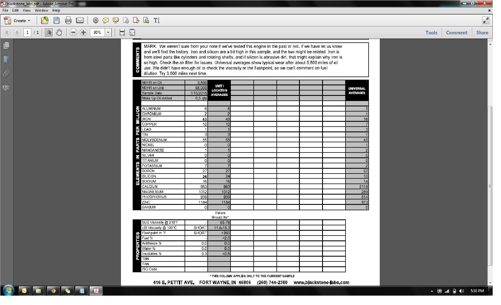

    hmm so this is what blackstowns lab had to say. this did site for 6 months before i sent it cuz i forgot about it.
    [IMG][/IMG]
