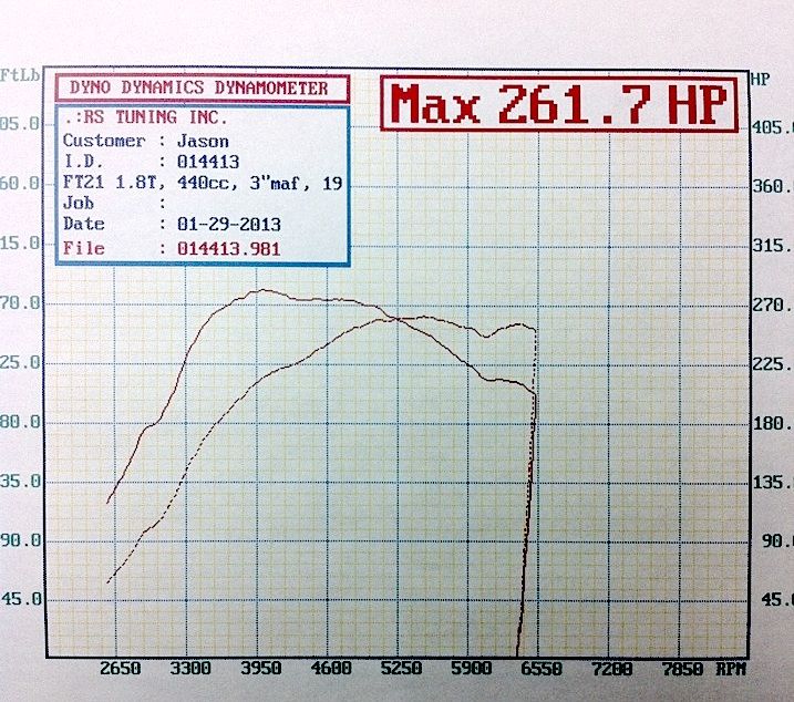

    There is 2 seperate dynos listed on Franken website one with 91 octane and the other with 93 octane both which is pump. Both made right at 262 whp. Even if these are fwhp dynos they are still very close to 250AWHP when you convert. 15% for FWD loss and 21% for AWHP loss. The dynos do not specify AWHP or FWHP.
    Are you going to disagree with this as well, LOL.
    Every dyno I have seen of a Quattro is just under 240awhp, plus 262fwhp is only 240awhp using 15% and 22% which is pretty much what everyone uses. Last time I checked 240awhp wasn't 250awhp. lol
    Dude are you on the rag or what is your issue, lol. You nit pick the sillyest shit I have ever seen. No where did I guarentee he would make 250AWHP with the FT though it seriously looks like its capable. If a person is aiming for 250AWHP I would buy the FT and call it a day. The obvious value of the FT is the ease of install compared to return. If you are going to compare other turbos that make 250AWHP the FT is the cheapest and best bang for the buck unless you plan on something bigger later. Also I never said anything about pump.
    When I have converted FWHP to AWHP I use 15% and 20% usually. On the first GEN MR2 we used 12%. The Audi A4 is the only forum I have ever seen use higher drivetrain loss. At 20% its very close to 250AWHP but the fact is the dynos do not specify if they are AWHP or FWHP. I was "assuming" FWHP since they are higher then most which typically is between 230AWHP-240AWHP. Evo owners use 17% drivetrain.
    You seriously just made a post nit picking 1% difference in drivetrain loss, LOL.
    Here is the dynos I referenced.

    I am on the rag? LOL maybe you should actually get first hand experience on the matter before giving your "BS" answers on a forum. Your answers are like a virgin telling everyone how to have sex.
    I wasn't making a big deal about 1%, was just saying that we have been using 22% for over 10 years seeing that is what we found the driveline to lose. But 1% still wasn't going to help your cause seeing it still was going to fall short of 250 smart ass. Every dyno is going to be different and even brand to brand the % is going to be different. There are some that will read 15% with a A4 1.8t and that same car might end up on a dyno that reads 35% loss. I have even seen dyno sheets show a car making way more power then a turbo is even capable of making for the amount of boost the person says it was running at and then watch people ask him if it was a "Florida" dyno. lol
    The dyno is just a tuning tool, but the fact is that I have yet to see a A4 1.8t QUATTRO put down more then 230whp on any type of dyno and I have been around since Doug started offering the turbos. Maybe people should learn to add info to their dyno saying if it is a FWD or Quattro, it isn't exactly that hard to do.
    If someone has a goal of 250awhp telling them to go with a FT isn't exactly the best thing to suggest seeing they will most likely not be looking to max out the turbo which means they will most likely not come anywhere near 250awhp like they want. I don't know how much common sense someone would need to figure that out. Hell I know people running GTRS setups that ended up making under 250awhp and as we all know that turbo can make more then that without being maxed out.
    I know exactly what dyno sheets you were talking, it isn't like your the only person that knows how to use a Search Engine. If you didn't notice the 2nd graph says "GTI" right on it, so common sense should kick in and figure out it is FWD. lol

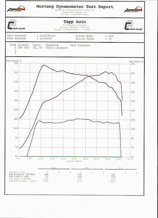

    This is the most i've seen on a Dyno sheet for the FT, granted this is the F4H-L so the F21 MAY be able to squeeze a bit more.
    http://www.audizine.com/forum/showth...udi-A4-Quattro
