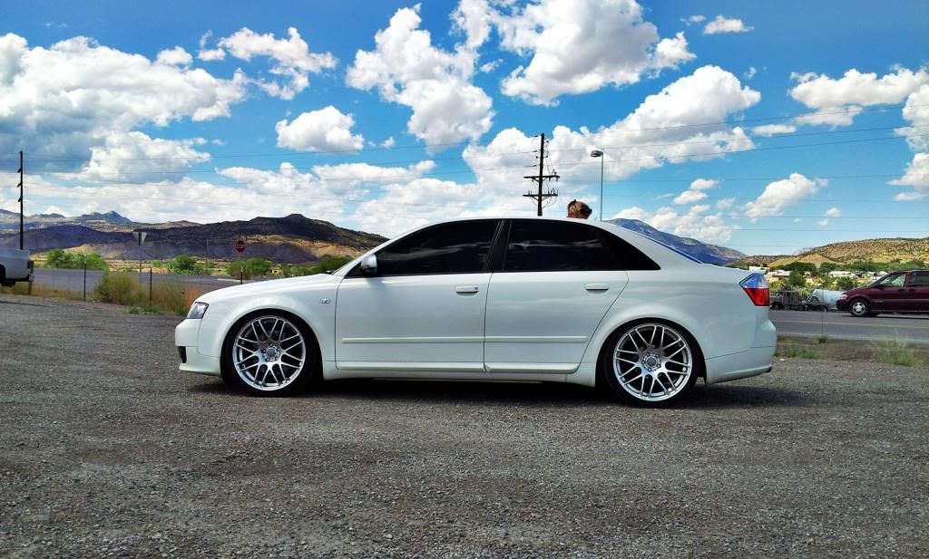

    Post up a picture. I'm curious to see how low we're talking here.

    Quote Originally Posted by iHaveBoost? View Post
    Sorta crooked, but represents the ride height I'm at right now.

    You look to be right around 24.5" Installing adjustable uppers will drastically increase tire life. With a proper alignment and stock control arms I only made it about 15K before I blew through the inner edge on some Falken FK452's. After doing adjustable uppers I got probably 25K out of Continental DW's and about 45K from a set of Continental DWS's.

    I wouldn't call that slammed.
    Regardless, do tires after an alignment. Adjustable control arms aren't necessary; they help with camber and the toe is what will eat your tires. They'll help, but are not necessary.

    Quote Originally Posted by Greedo View Post
    Tires tucked inside the fender isn't "slammed" any more? Man I've been off the forums too long. Do the wheels have to be tucked for me to get into the cool kids "slammed" club now?

    I consider slammed to be nearly tucking wheel. That's low, but I wouldn't use the term slammed.
    If I saw it in person I would consider it low, but the term slammed wouldn't come to mind.
    that's because you have an air lift that basically lays frame. considering he has stock bumpers on, that pretty damn low to me.

    id say hes at 24 1/2 FTG or close to it.

    Quote Originally Posted by jubei4769 View Post
    Pretty close, 23 3/4 front, 24 rear. That might be backwards...can't remember which was higher/lower.
