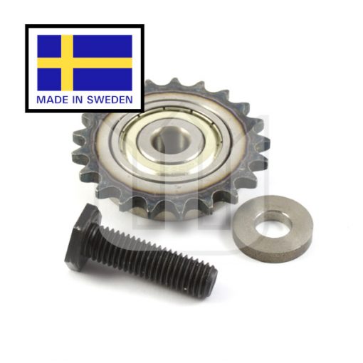

    Anyone looked at this setup? Its a free wheel sprocket that gets fitted to the balance shaft drive. Super simple way to stop the balance shafts from spinning.
    https://wasamotor.com/shop/vw-audi-s...ull-chain-set/
    https://wasamotor.com/shop/vw-audi-s...2-0-freewheel/
    2003 02X Six speed swapped, RS4 RSB, H&R FSB, B7 brakes, 2.0T stroker, DSMIC's, B7 CTS K04 turbo.
  23. #63
    Jun 27 2011
    77478
    There was a guy who first posted that a few months back. Seems like a solid solution if you don’t mind losing the balance shaft effect.

    Thats why most people now opt for the freewheel. Simple swap of sprocket and done. The Wasa one use a SKF bearing(confirmed), so no worries of it going bad. Better quality and cheaper than the VIS knockoff. Though lots of people have used the VIS without issue. Good luck with your build.
    Sent from my LM-G710VM using Audizine mobile app
    this is ONLY valid as a totally preventative measure.
    if you are already suffering from a hemorrhaging balance shaft assembly this will do nothing.
    2014 A4 2.0TQ Technik Manual
    2006 A4 2.0TQ Manual
    1978 Porsche 911SC Targa
    1976 Yamaha XS 360
    Note: PMs disabled, please keep requests for technical help on the forums to benefit everyone:

    Quote Originally Posted by Theiceman View Post
    Well yeah, ya do it in the first place. Too late now, I guess. Just saying, thats why most people just go with them instead of cutting shit up. Makes more sense. Or if theyre still intact, if your having balance shaft issues(like if the journals are worn, etc) it stops them from engaging.

    Quote Originally Posted by Jayz691 View Post
    human nature is most people wont pull the sub frame to drop the pan , to remove a balance shaft assembly, to give them more vibration, for a problem they are not having.
    that said though i totally agree. i would put this on before "cutting the shafts" if i was in there doing other engine work anyway.
    1976 Yamaha XS 360
    But LOTS of people do. As you said, its a preventitive measure for a common issue.
