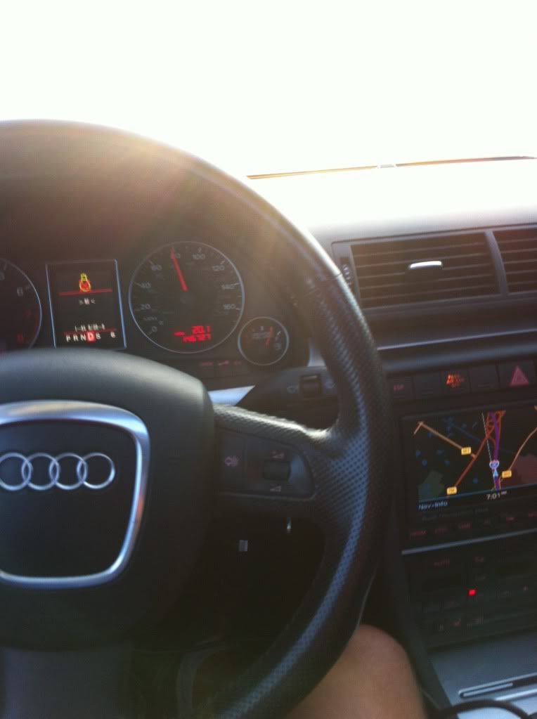

    Cruisin' this morning
    Not so much
    - Clint

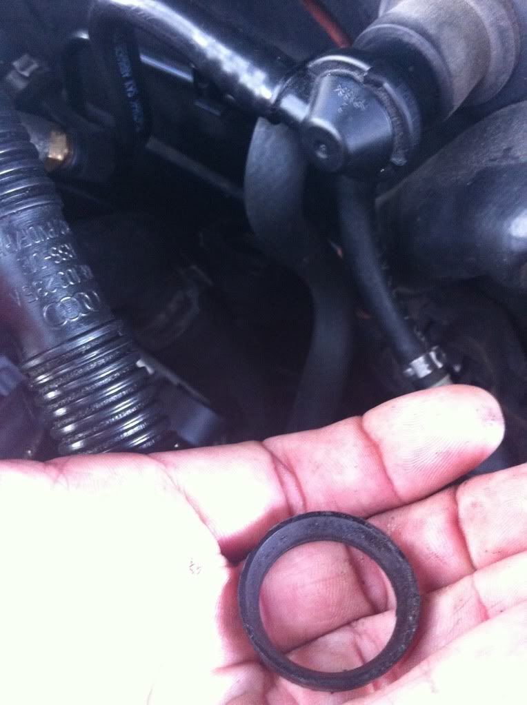

    Ok so the idiots at Meinecke parked my car over this curb so when I backed up it ripped half the bumper off. SMH
    Also, I'm having a hell of a time with the coupler going to the rear coolant flange from the heater core. I think I'm good and it's on tight and then it leaks/pops off. Haven't overheated because I watch the coolant gauge like a hawk but that's getting old

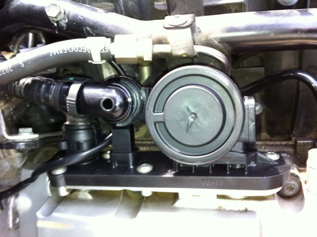

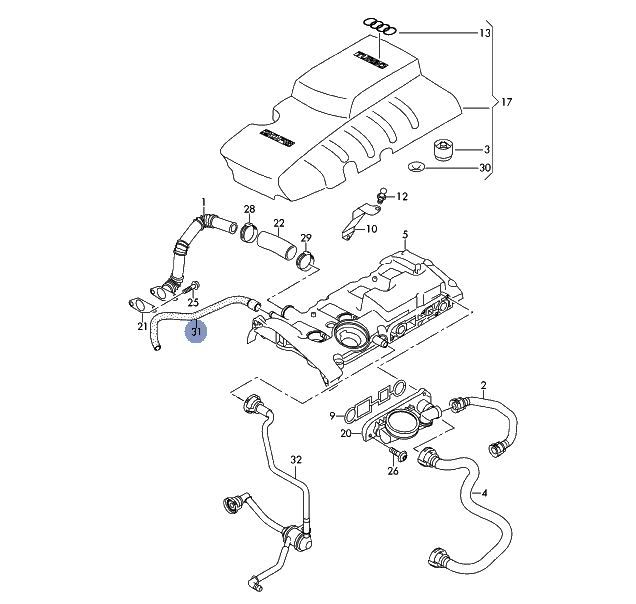

    Do either of these help? The hose that comes off the pcv pointing towards the firewall (#2) goes to the IM. #3 goes to the oil cooler I believe.
    Are you talking about either of those? or #32?
    Well I have that IE plate so mine looks a little different. I'll see what I can do tonight. Thanks!

    New plugs last night, not sure what to make of the old ones they look very lean (maybe that's normal for FSI?)
    Also did an extreme engine flush, some people might disagree but I had the oil pressure light pop up quickly again yesterday and can't have it happen again. Steps are below
    1. Drain oil, fill with 4L of diesel gas
    2. Let it sit overnight (DO NOT START)
    3. Drain gas, change oil with cheapo stuff and new filter
    4. Drive for 15 minutes, do full synthetic change with filter
    And no lights today, runs pretty good
    - Clint
    Other culprit could be the oil pressure sensor. I got an oil pressure warning on my B6 S4. Thought maybe it was a blockage due to flaking on the inside of the cam cover; the flakes finding their way down to the pan and then blocking the intake. Turned out to just be a bad sensor. Cheap part, hard to get to on the S4.

    yep. Maybe I'm an idiot, maybe not. No oil pressure light today though!
    I would suggest an oil change again soon though. There is no way you got all the diesel fuel out after the fist change. I also don't think it will harm anything.

    I am on my second oil change since the diesel. I did a basic oil change after, drove it, and then did yet another oil change
