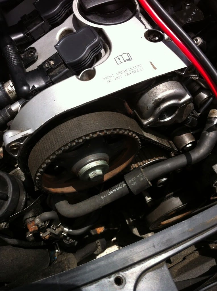

    really? That timing cover was super easy... maybe you did it on the car? Tell me more about this cam cradle sealant...
    Yea I did it on the car. It should be cake, but there's absolutely no clearance between it and the firewall so its just infuriating.
    The sealant sucks. It's that candy-like red-orange crap all over the cam cradle, in the grooves. I used Elring Dirko as a replacment (recommended by Tyler@IE) and its probably 10000x easier to deal with. The factory stuff is like trying to chip off super glue that's heat hardened to the block and cradle.
    I ended up getting a bunch of gasket remover and letting it soak in multiple stages over the course of a few hours then scraped it off with a pick and razor blade. Took forever.
    Yep if you try to do it on the car you need a super shallow t30 to get between the firewall and head, and then there is one bolt that you need to pull the coolant flange to get to. Not the most fun thing to do.
    So the top portion of the head deals to the bottom using this thick black sealant it's a real bitch to clean off, almost impossibruuuuuu!
    And then if you take it apart you have those stretch bolts you have to replace! A poor $40 investment

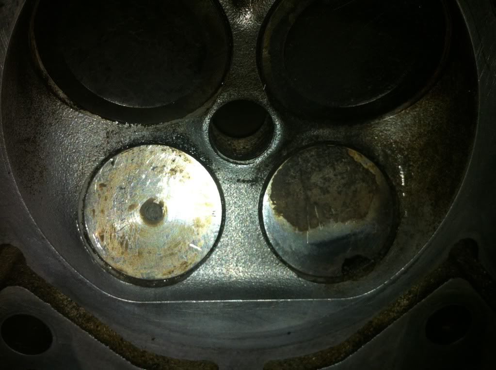

    Dude I couldn't believe how caked on the combustion side of the valves it was, I thought it just built up on the stems
    I know you're SUPPOSED to replace the bolts, but I didn't and don't have any issues (knock on wood). I think swapping them out at this point would cause the gasket to unseal so I'm not even going to bother. I might check that they're tight though next time I've got some spare time to remove the VC though. I still need to refresh my VC bolts. the rubber gaskets on a bunch of them are pretty toasted...

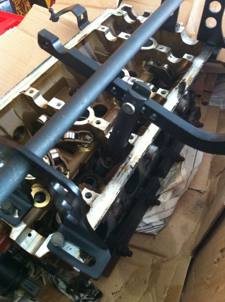

    well I kept the cams on the chain. I assume as long as the cam gear matches up it doesn't matter where they are. Hopefully I don't bend a valve - that would be some solid karma

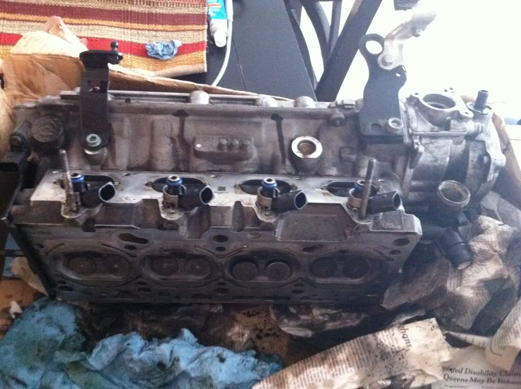

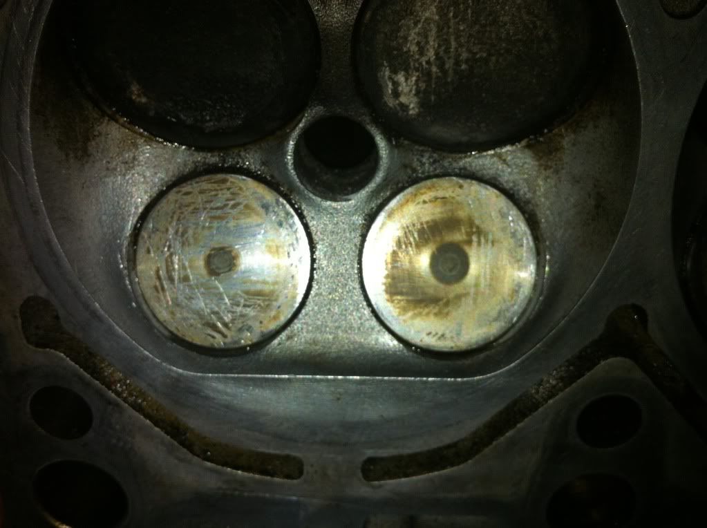

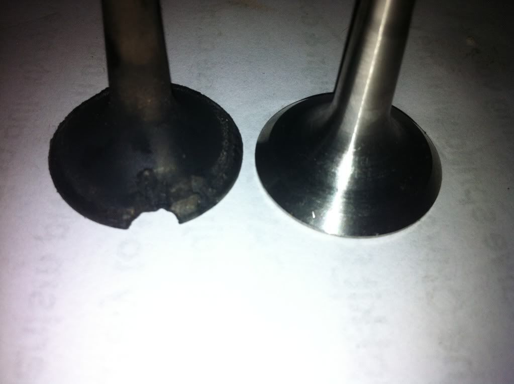

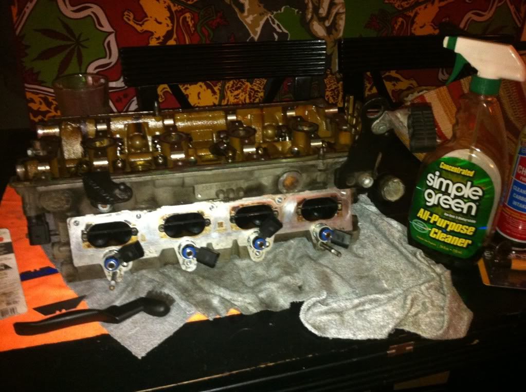

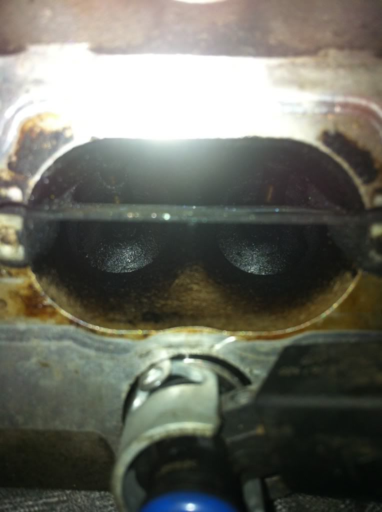

    Back at it.

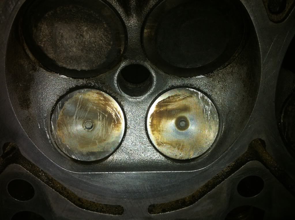

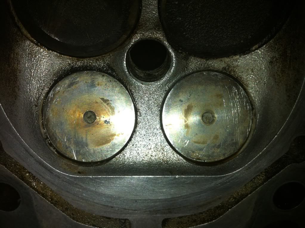

    Cyl 1
    Cyl 2
    Cyl 3
    Cyl 4
    Quick Carbon view
    Cleaner
    Roommate's table. I'm now banned from using it for car parts....
    - Clint

    yeah for the most part. BTW, what kind of sealant can I use for the cam cage top? Can I just use the general Audi stuff?
    I used Elring Dirko (Muhammad Jihad). Tyler@IE recommended it to me. Seems to be sealing just fine, no leaks that I've seen since January.

    Oh well all I had was the generic Audi stuff

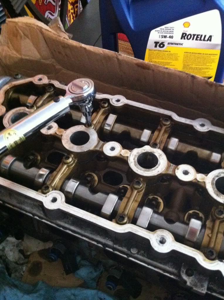

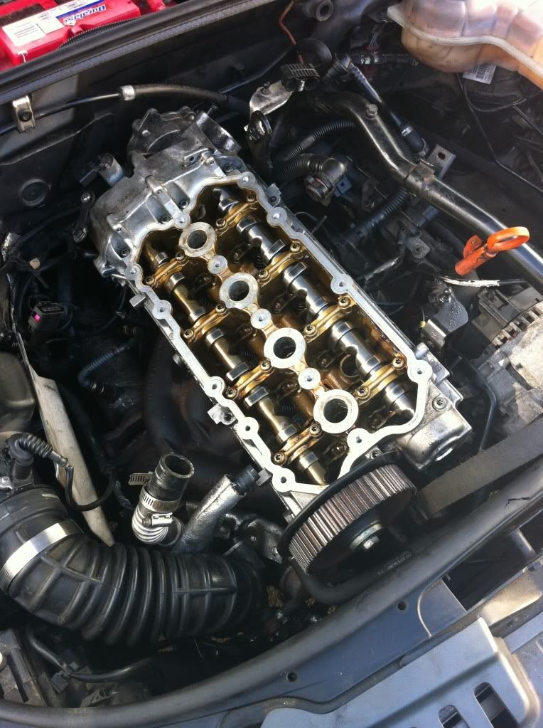

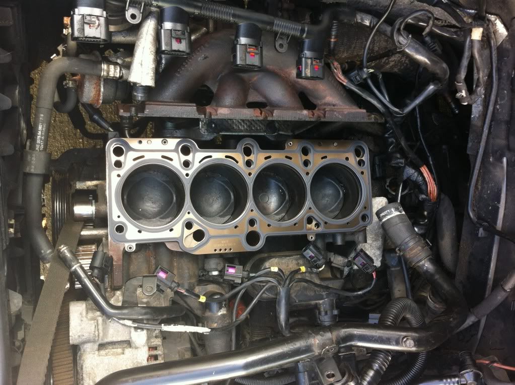

    Today's Progress....
    Cam cage goes back on (you're right that did suck)
    10 second cam follower DIY
    Head just about back together
    New HG
    Bolted down
    Done for the day
    - Clint

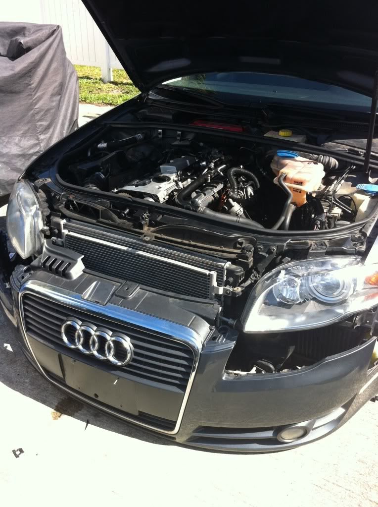

    I hate these bumpers...
    timed up and ready...
    waiting for battery to charge...
    - Clint

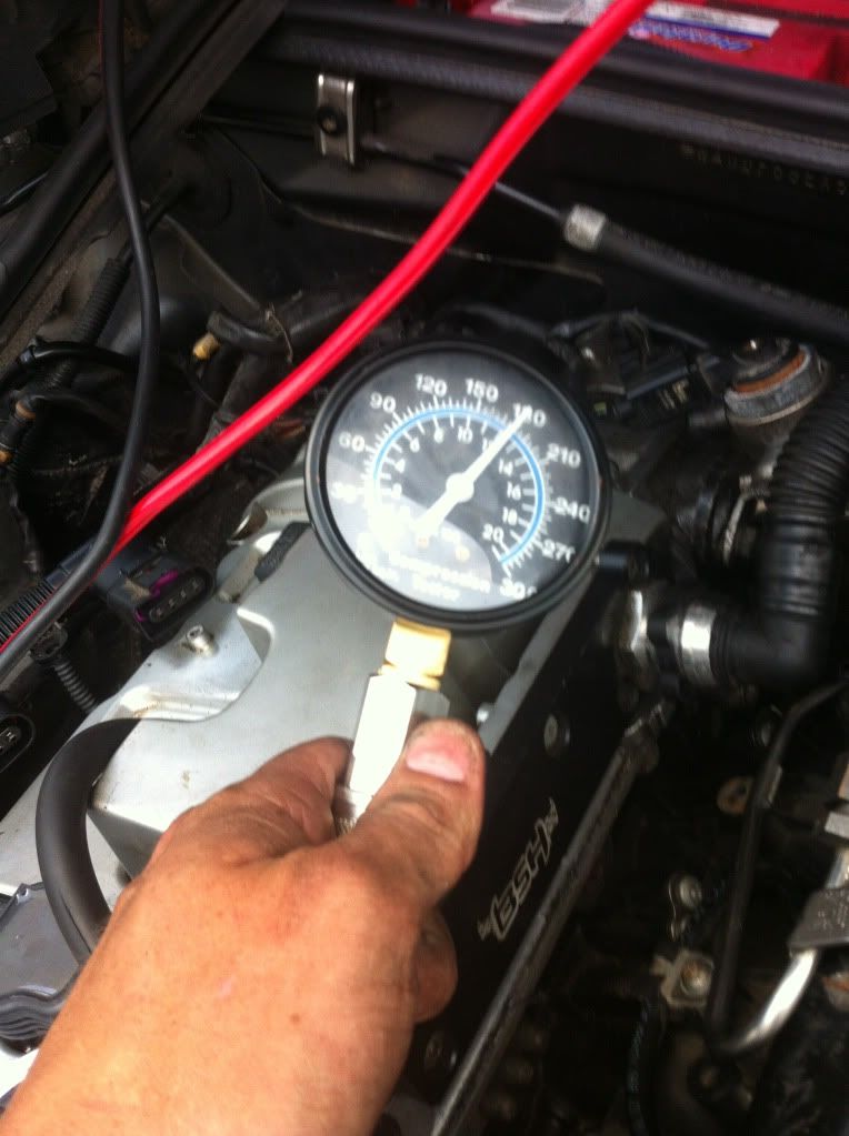

    looks about right
    30psi -> 180psi

    oh did I not say it? It runs good. Was worried about the turbo but no smoke so we will see. VAG-COM cable arrives Monday
