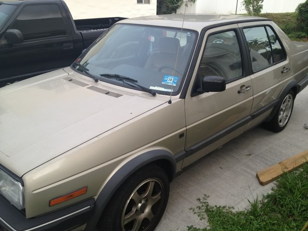

So I "sold" my white S4 months ago only to find out that the buyer didn't want to pay everything... In the meantime I've been driving this.
It's an '88 auto Jetta with 100hp and the auto trans on it is about to blow up any minute. It was time I found a new DD. About that time I find

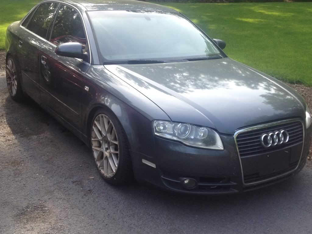

The guy actually came on here to ask about next steps. He was driving the car and it started driving like crap all of the sudden. He took it to Audi and they said he needed a "new engine." I have no problem with putting in engines so Clint's next DD was born.

- 05.5 B7 A4 2.0T Automatic
- 140k miles
- Bixenon Headlights
- RNS-E
- unknown Stage 1 tune (APR I think)
- unknown Test Pipe
- unknown 18" wheels
- unknown Lowering Springs

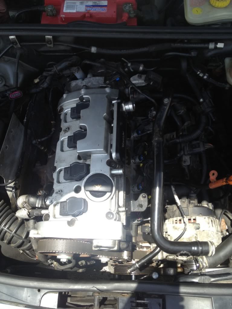

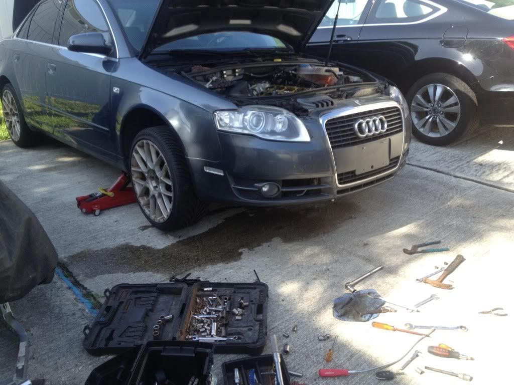

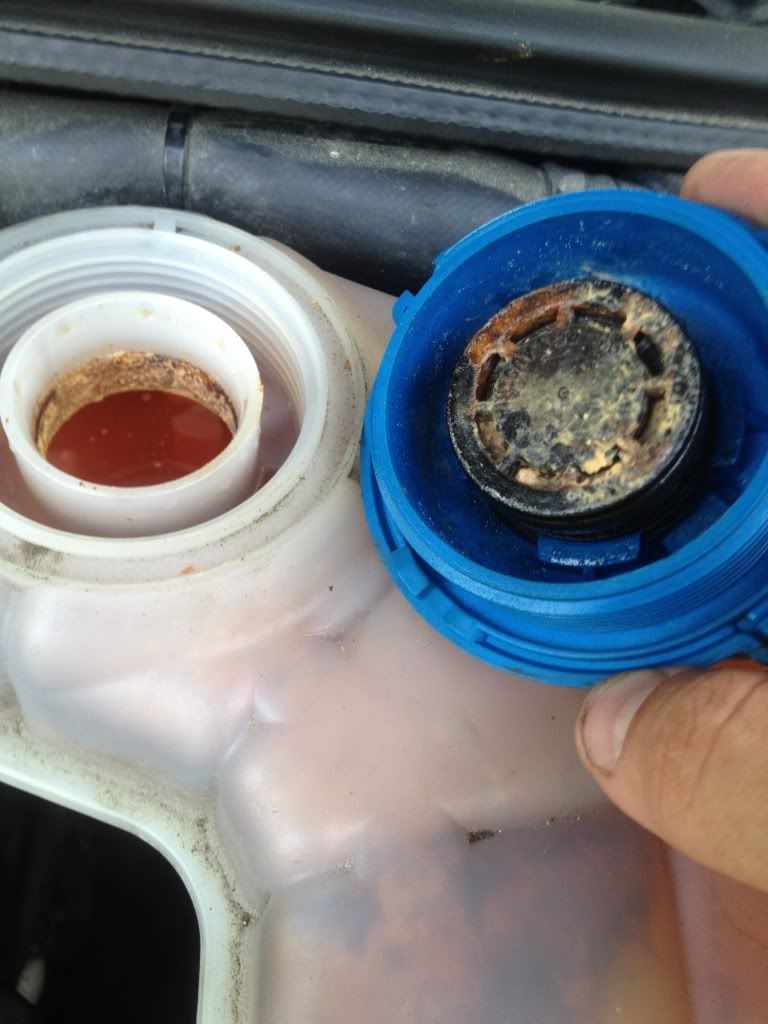

I buy the car in NJ and immediately notice this:

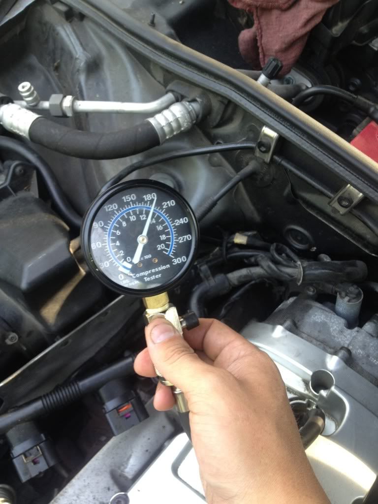

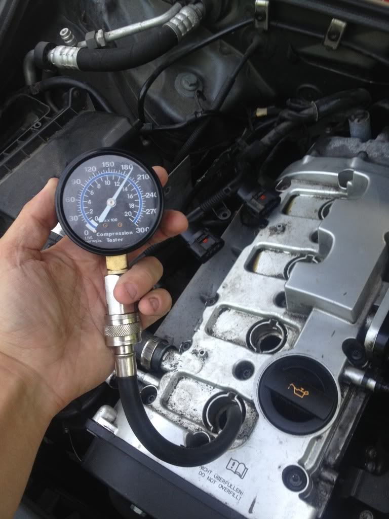

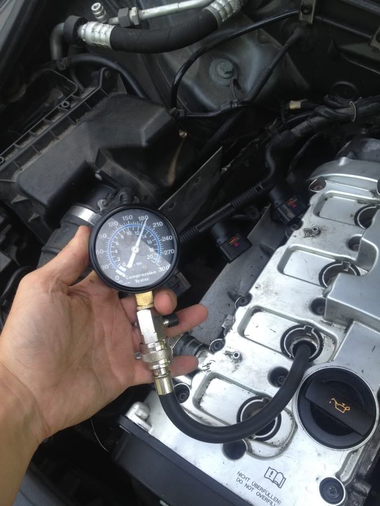

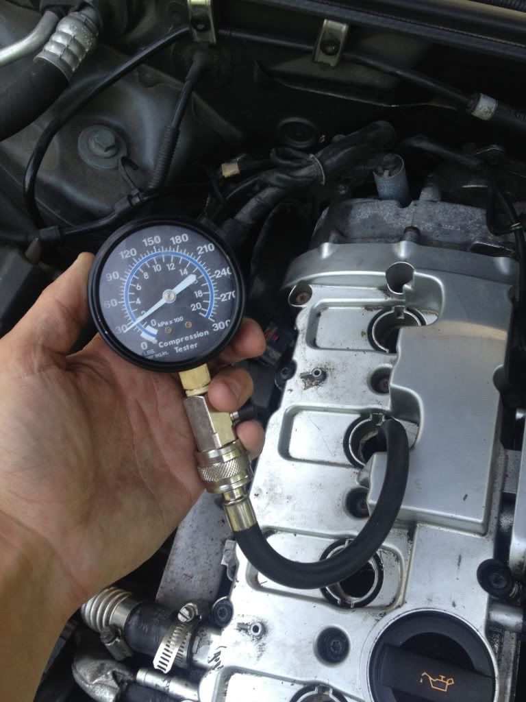

Maybe he popped the HG on Cylinder 3 and it's leaking? So I do a compression test to see what the damage is:
YES
YES
[/URL]
YES

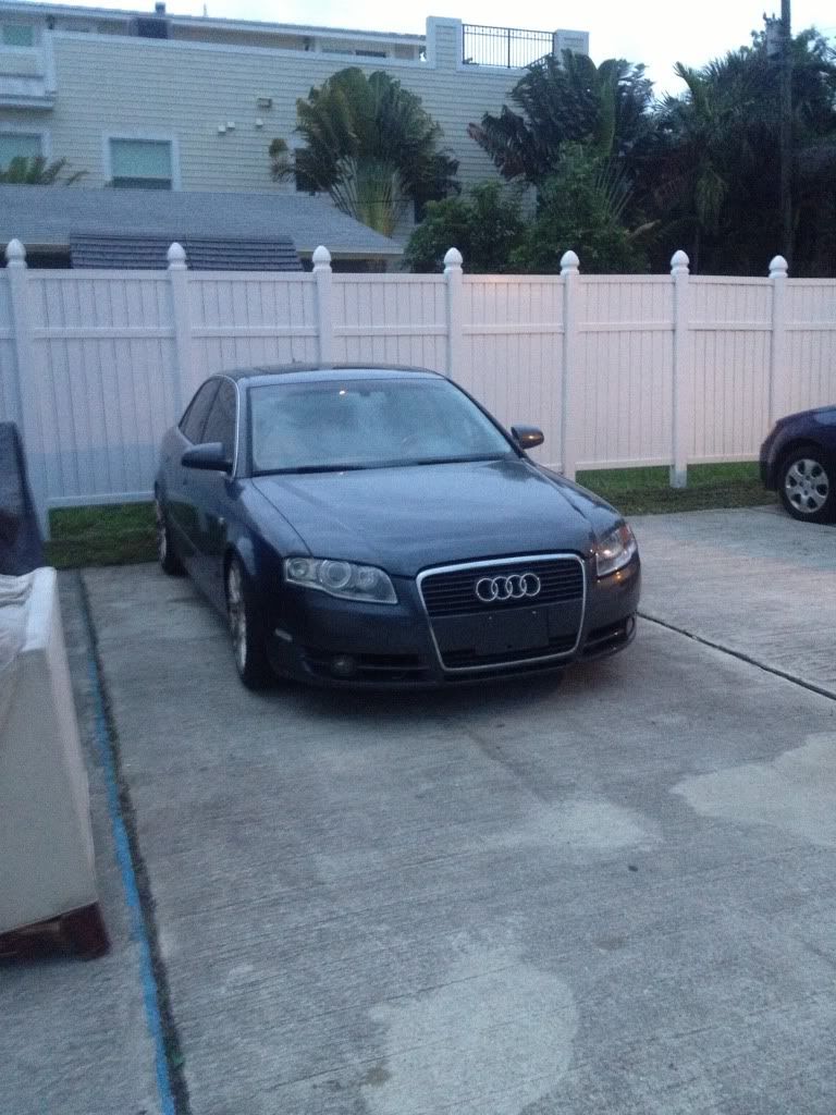

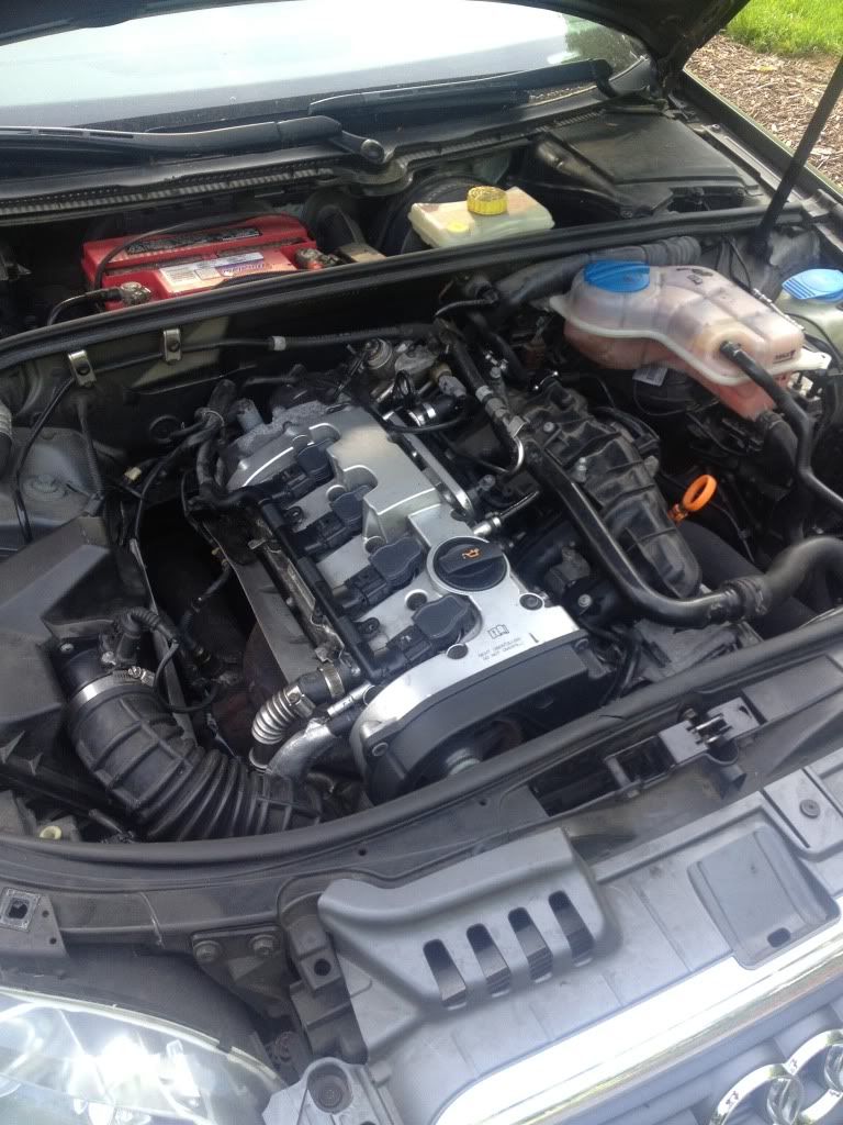

That's enough to tell me it's not a quick fix while I'm in NJ. Car gets transported to FL where I live now:

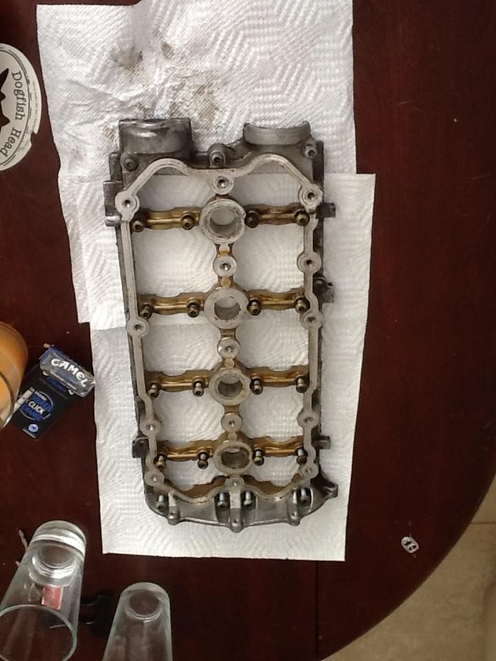

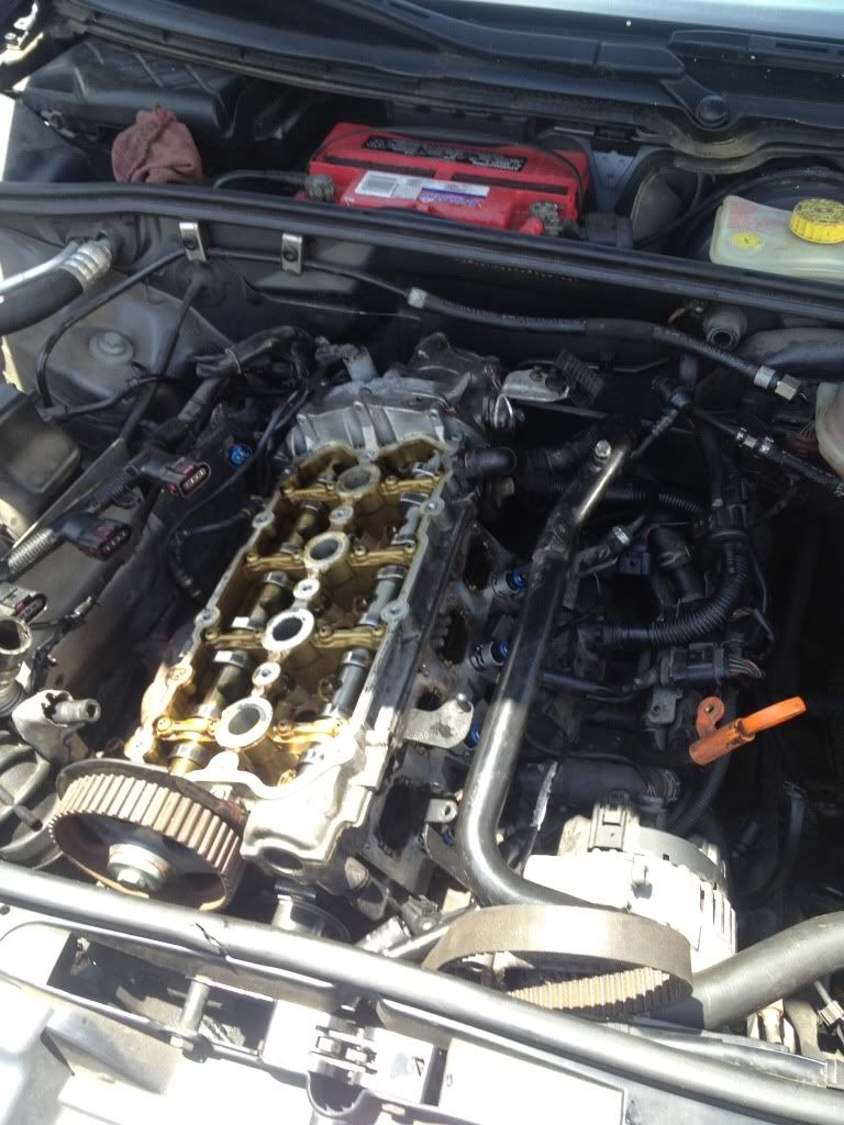

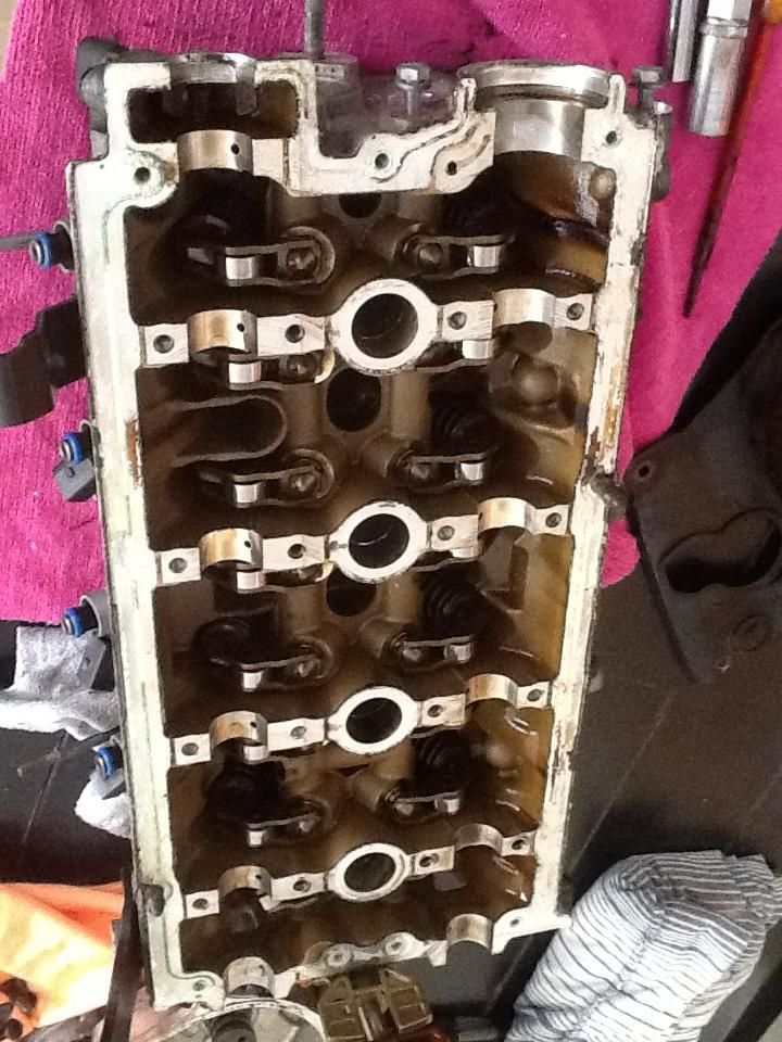

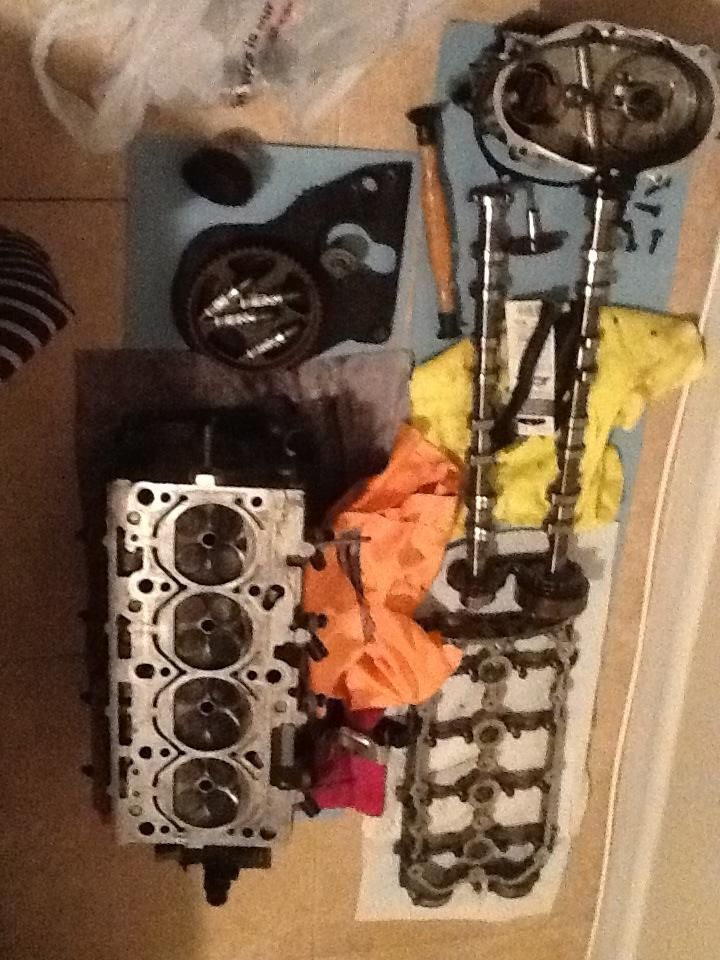

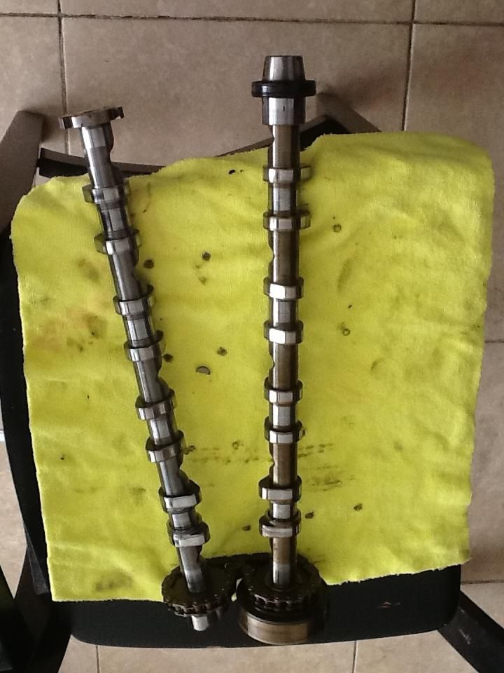

Now that it's here I tear her down:

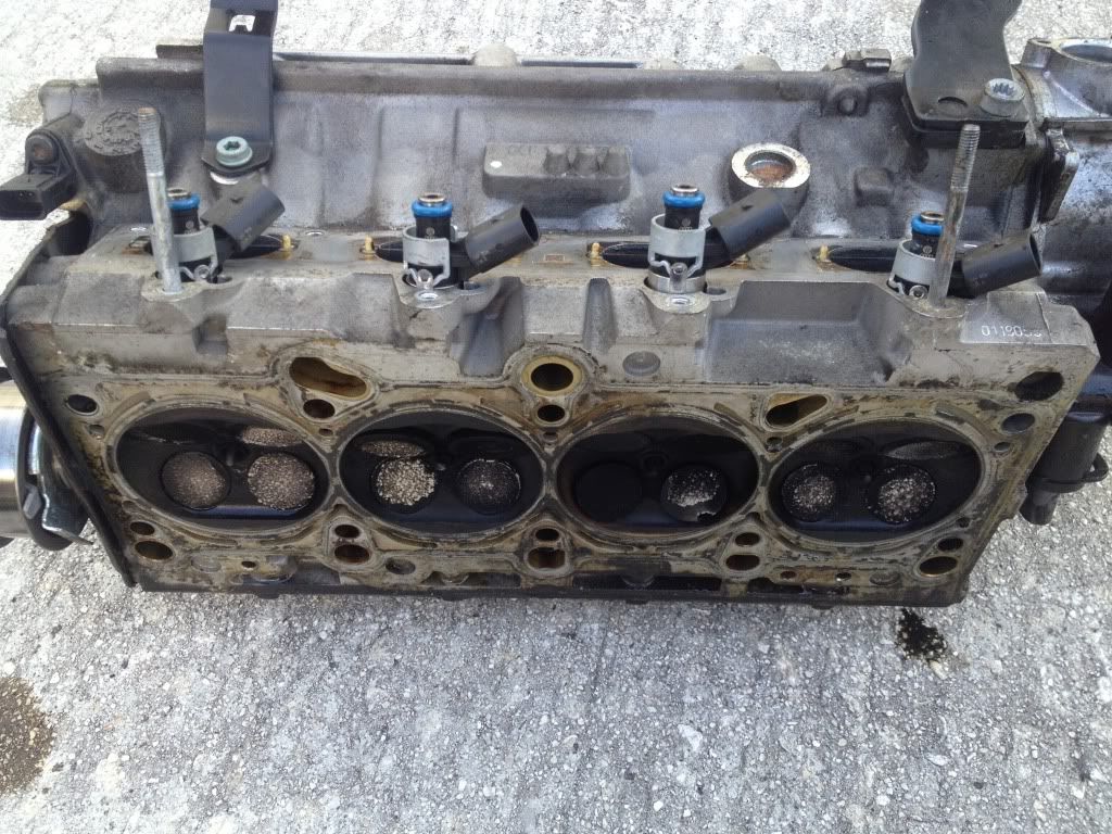

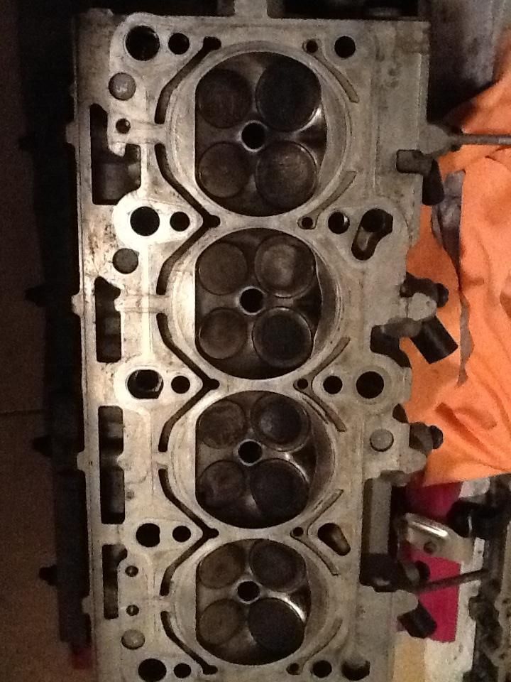

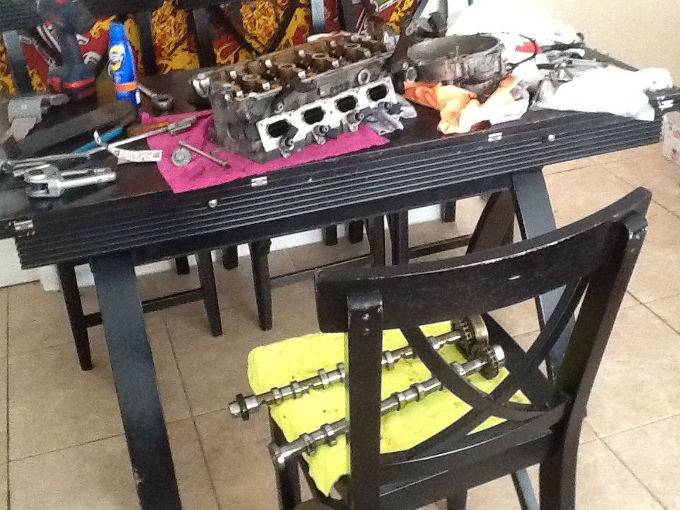

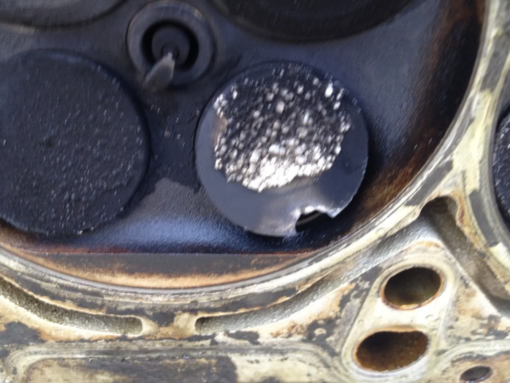

OK head is off... First thing I notice is the white bubble things on the valves, looks like it may have gotten hot... possibly carbon buildup.
[/URL]

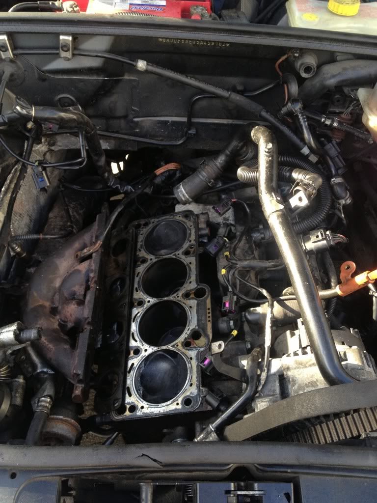

Anyone notice anything weird about Cylinder 3? Yeah me too.
Updates to come
