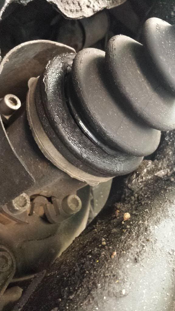

    Not again. But have to say this was a used oem axle with an unknown mileage, I put at least 20k more on it. Time to buy a 2nd raxle.
    Sent from my SCH-I645
    Well, at least you'll have a little more peace of mind knowing that you have Raxles on both sides. Still a bummer, though.

    Yep gonna wait until it dries out first, which works better electrical or aluminum tape?

    Quote Originally Posted by WiLl2FLY View Post
    I'm pretty sure she was referring to something like this:

    Quote Originally Posted by Myst420 View Post
    Could be control arms as well.
    I just had my front passenger tire changed would I be wrong in checking there first
