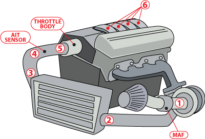

    If you go read the Devil's Own site, the best place for a nozzle is actually upstream right after the last intercooler, as this allows the most time for homogenization and mixing. So site #3 is where you "should" aim for.

    Actually I am not a methanol injection expert by any means; only know what I have read and my experience with the install on my car. But I think the reason for individual nozzles is for higher flow rates and to get bigger droplets into the cylinders and for wetting the intake to keep it clean. That is just my guess though. If you inject after the intake air temperature sensor, then your ECU will not give you better timing advance as it won't see the cooling effects of the meth injection; so it won't help you run a higher octane tune unless the only limit is the knock sensors. So I would definitely put the injection upstream of the IAT sensor.

    WM is mainly to cool the intake charge so as long as you add it far enough upstream to homogenize in the intake mixture, you shouldn't NEED one injector per nozzle. Its really common in the 1.8t to add an intermediate plate between the IM and Throttle Body and inject there with a single injector solenoid.
    You could do one injector placed in each IM runner, but theres so little space in the 2.0t IM (and its plastic so no welding bungs ) that there isn't really space to do it properly. If you have metal intake piping the ideal solution would be to weld on an injector bung and inject somewhere before the TB. That has the added benefit of keeping the IM and the valves from accumulating too much carbon buildup.
