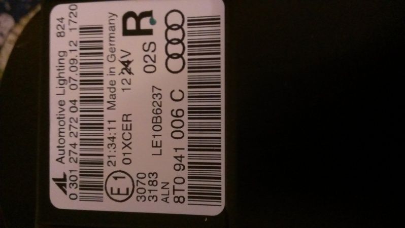

    Quote Originally Posted by ActivS5 View Post
    These came from Germany. Ya, we in the US can't run the UK lights because the light cutoff is for right side drive cars.
    If you could take a quick photo, that would be awesome! Are you non-adaptive?
    I dont know what ecodes you got but they are definitely different. I am NON- Adaptive as well. Shipped directly from germany. Heres the pics I just snapped:
    Ok, I bought them from a user on here. I contacted him. Thanks for snapping the photos. Can somebody with adaptive lights snap a photo of the top of their lights?
    Youre welcome
    Looks like they sold you adaptive lights: http://www.ebay.com/itm/ws/eBayISAPI...m=290822530819
    You can see the ballast installed in those pics. BTW that is lowestA4's ebay auction and those lights are the german version.
