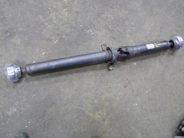

    From what I could find, the 2 different driveshafts are visually recognizable. On the early ones, the 2 shafts are slightly different outer diameter. On the late ones, both shafts appear to be the same diameter. Also, most of the early ones appear to have a large yellow warning sticker on them. Perhaps that warning has to do with the Carbon Fiber construction, and some care that must be taken during service near it, like not to use heat. I'm not sure, they all look like metal to me. Here are 2 photos:
    EARLY:
    LATE:
    Mike Hood (thanks for the recommendation, Chris) advised that I use a driveshaft from the same year as my differential. My local junkyard has lots of '99 driveshafts, which all should be the "late" type and the same part as an '01. So I should be set.
