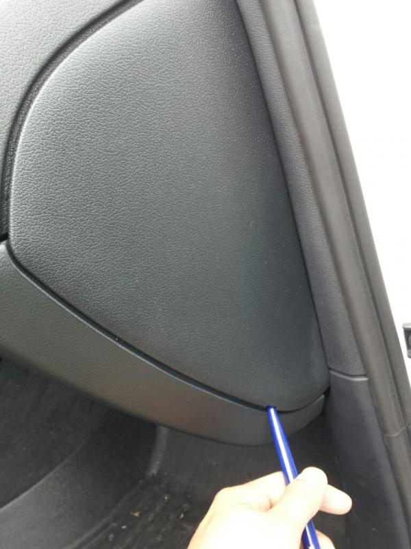

    This is not entirely true. It can be used, you just need some addtl. components with non-navi systems to provide the power. Check out the last entry in my FAQ page:
    http://a2dp4audi.netmagi.com/faq.html
    If you remove the passenger side fuse block cover (open the passenger door, and its the flat panel at the end of the dash you can only access with the door open), you can piggyback a fused connection right there. Very clean install if done this way.
