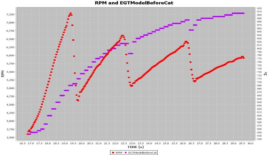

    So I did back-to-back testing tonight with my BB PT6262 .64AR turbo and my BB PT5858 .64AR turbo.
    I did both these logs on the exact same stretch of road, the road was very flat and had a nice white line across it that I used to start each pull. I drove very easy before each pull was made do get consistent results.
    First up was the PT6262. Then after I got home I had to let it cool for 45 minutes before I could pull it off since it was too hot to handle. Then about an hour and 15 minutes later I tested the PT5858. In the time it took to swap turbos, the ambient temperature outside dropped about 5 degrees. The only thing changed on the car was the turbos. The tune and everything else remained exactly the same.
    Here are the logs:
    This last graph is hard to read, but on the 6262 log - I only pulled 1.5 cf up until 5000rpm and then I was at 0 cf for the rest of the pull. On the 5858 log, it pulled about 2.25 cf the whole pull.
    As you can see the PT5858 is clearly the winner over the first half of the pull, but the PT6262 shines up top. Britishturbo is going to overlay my two logs in virtual dyno as well.

    And here is a modified FATS that better resembles how I would drive the car if I was racing.... 4500rpm - 7300rpm

    The 558 has a 59mm turbine bore and the 6262 a 63mm bore.

    I like the controlled conditions
    Turbo selection and powerband is a matter of personal preference, so I must ask, what is your personal preference between the two as they stand, the 5858 or the 6262?

    Quote Originally Posted by jibberjive View Post
    I absolutely....100% prefer the 6262 over the 5858. The 500 rpm that I lose by running the larger 6262 (which is null if I start racing above 3500rpm, who races below 3500 rpm lol) is easily made up for in the 6000+ rpm range.
    That being said, it would be interesting to test the other two exhaust housings, a PT5858 with the .82 AR housing might be ideal for a motor with rods and no intention of doing built heads....
    As you can see in my log from ATCO dragway, after I shift I am dropped right into the start of 6262's powerband, however each shift drops me into the top portion of the 5858's powerband which dies out above 6250rpm. keep in mind, second gear with the 6262, I make full boost around 5000rpm...

    I really like where this is going. You lost some down low, and gained up top with plenty of room to go with tuning.
    Using your modified fats... I get 2.45 seconds
