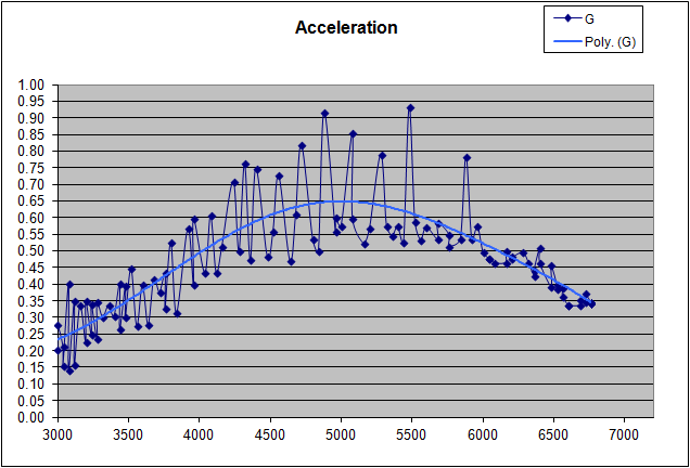

    I had to do the same thing for my setup. I had to get a tire size calculator, and a gear calculator and input the numbers. I tested it by using stock numbers and the calculator spit out very close numbers to what ecuX has for a stock s4 profile. I ended up around 67.4 for RPM per MPH with my 19" wheel tire setup and my 2.8 third gear.

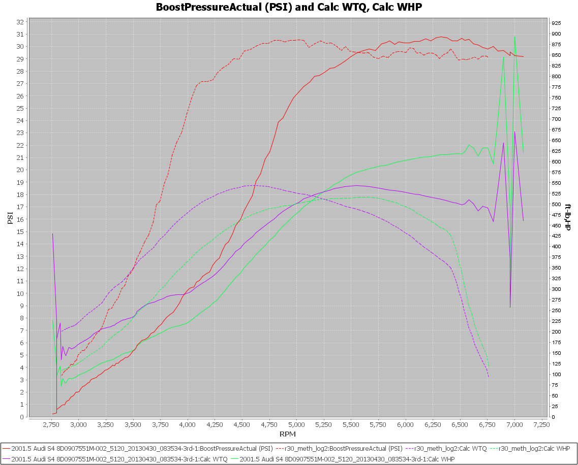

    Here's that run of his showing WTQ and WHP, as well as a new feature... Wideband AFR logging through the ECU...
    Still on the rich side as I dial in his tune for the Meth too.

    My power really drops off up top lol! I need some better flowing intake components! and 2.8 cams...
    You'll gain some up top from that but you are probably close to the limit of turbo flow

    I might have to try an .82 AR housing.... Maybe I can borrow Lidos?
    That will help reduce back pressure at the expense of spool but it's not going to increase the compressor wheel flow... you are at or near the limit of comp wheel flow.
