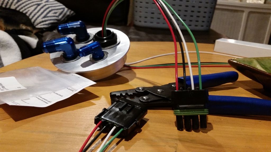

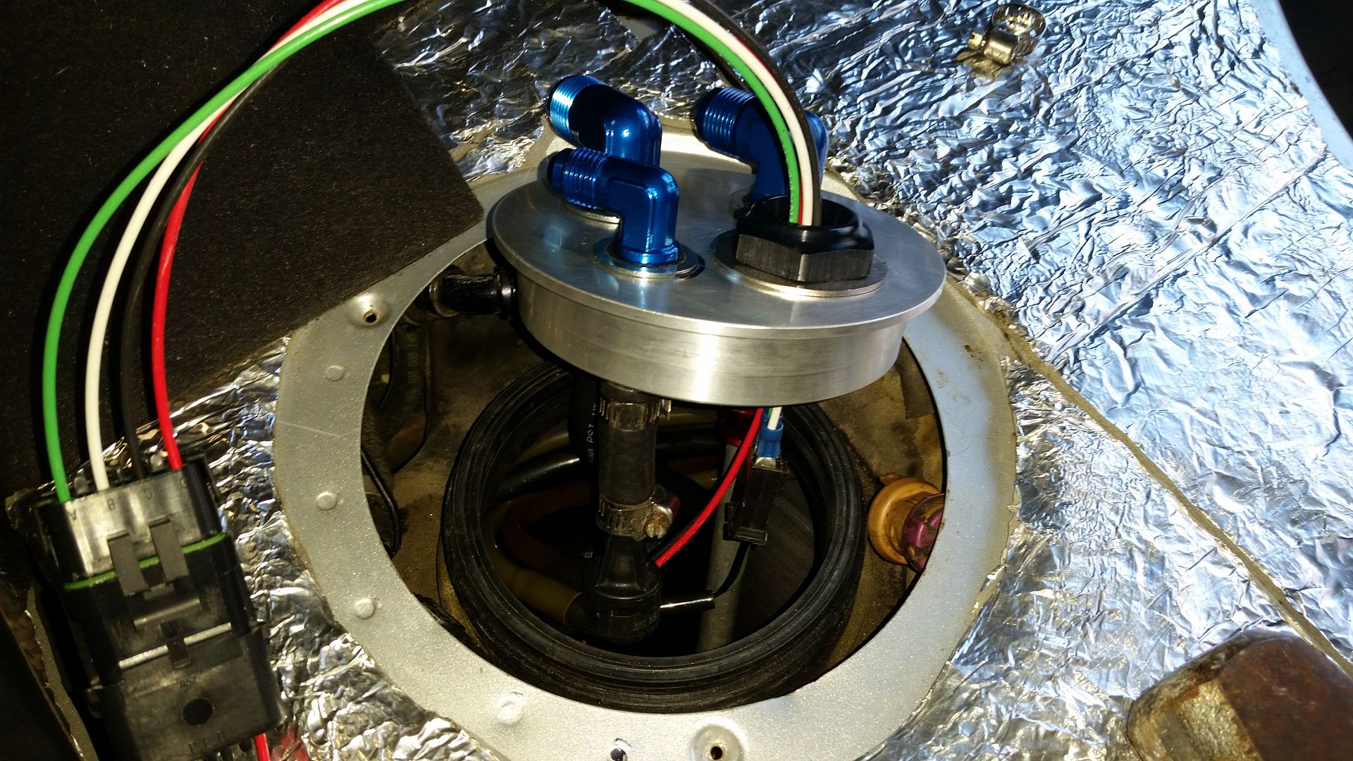

    4 pin weatherpack connectors... check.

    Are you switing to dual intank? If not, why the 4 wires for one intank?
  3. #1523
    Oct 27 2011
    83106
    TOYS
    Philly Suburbs
    2 wires for the fuel level sensor.

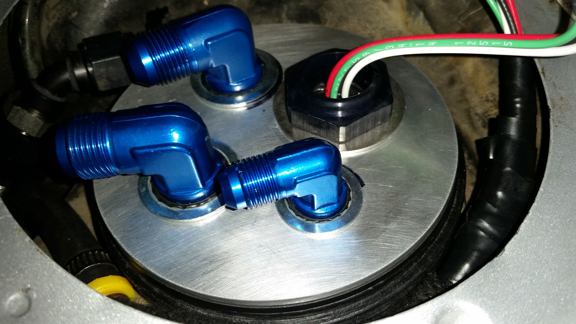

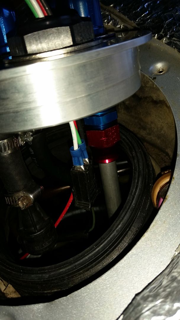

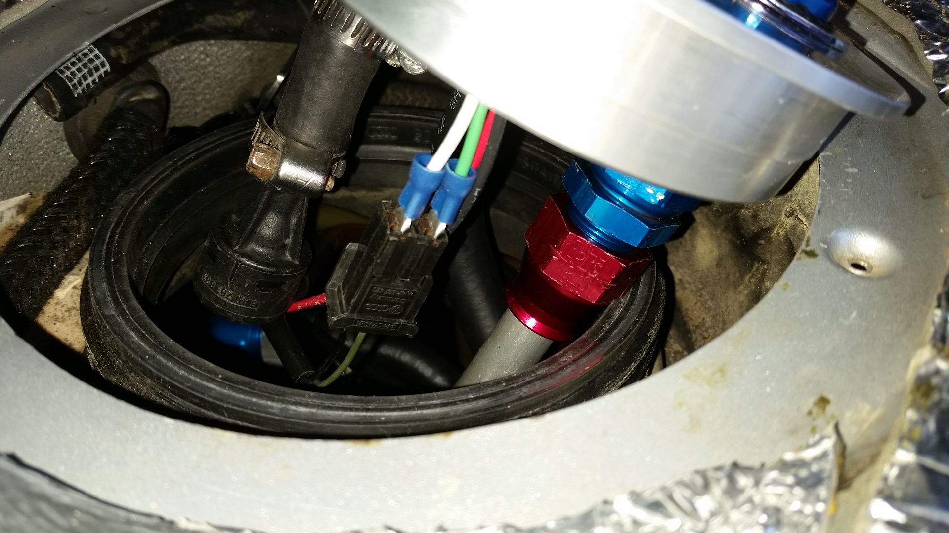

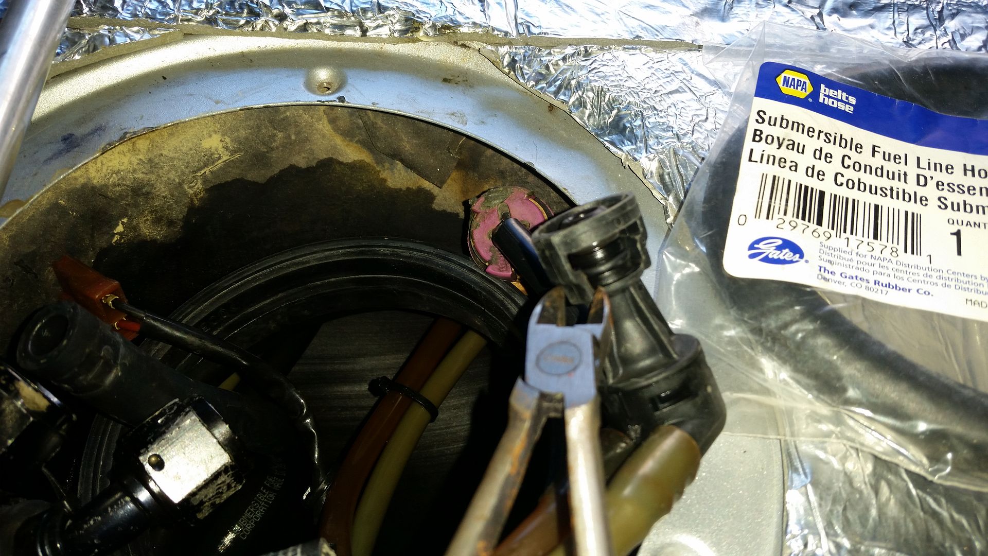

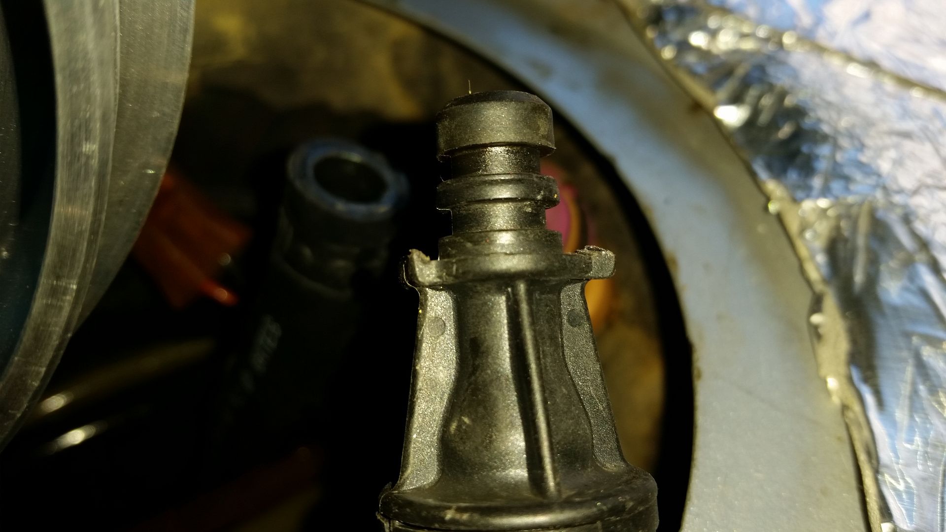

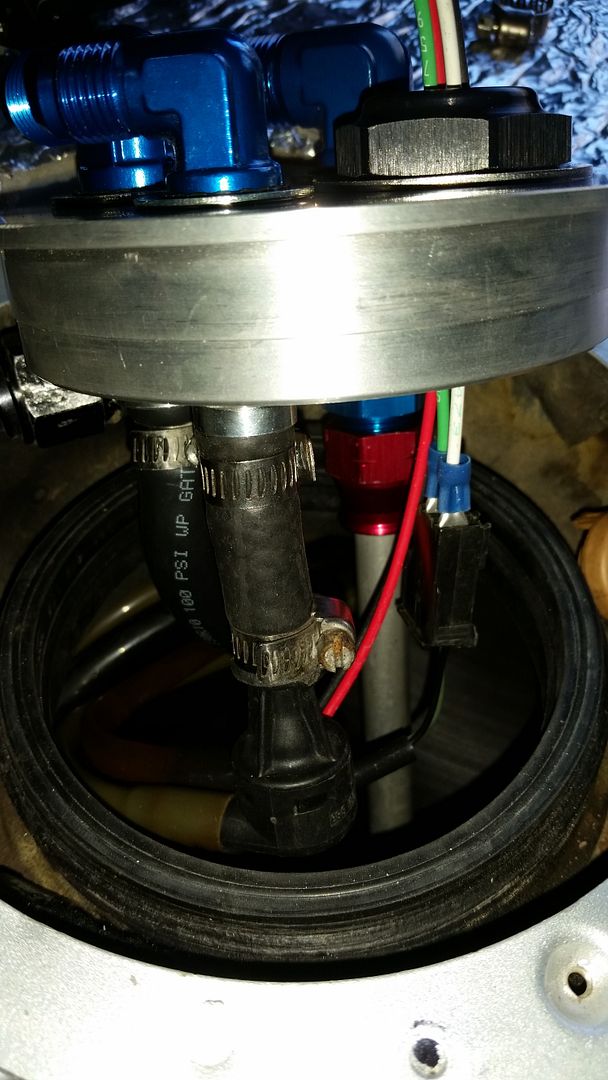

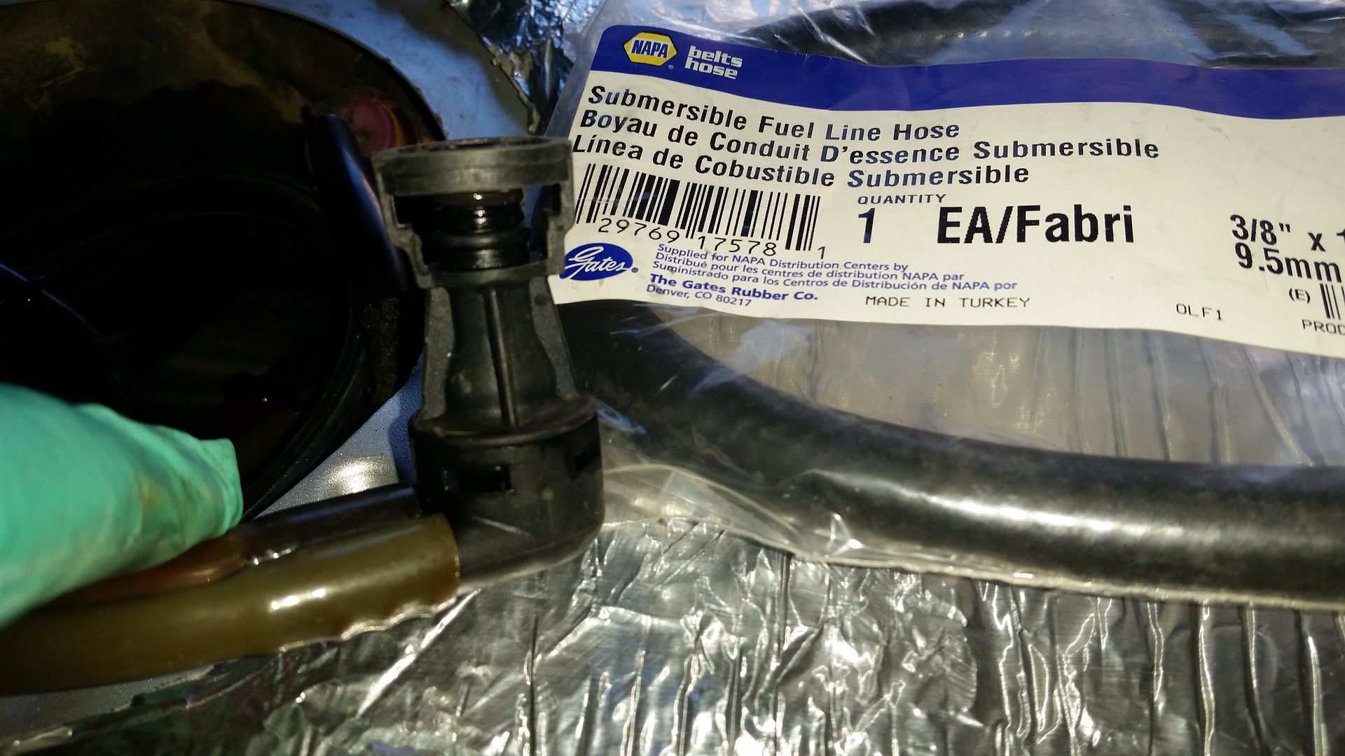

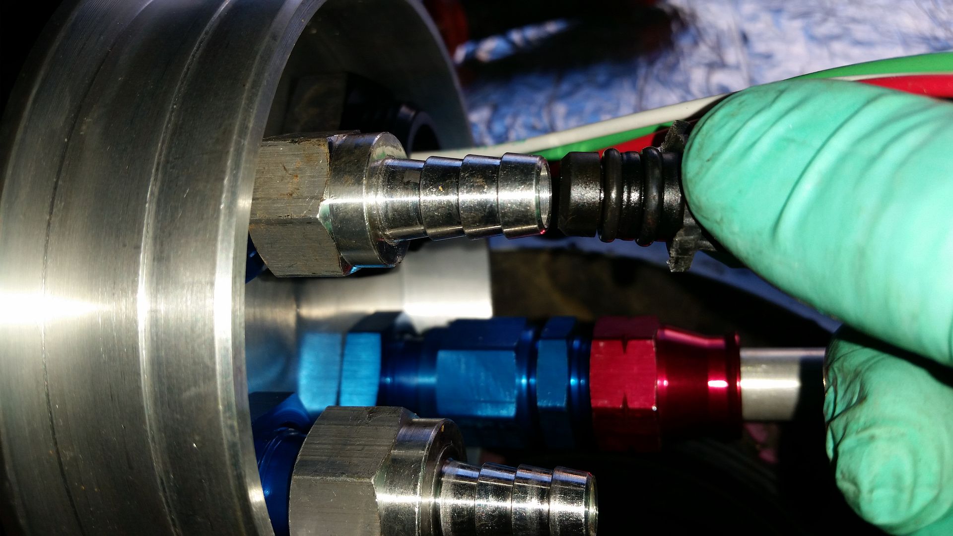

    Finally getting the new billet fuel tank hat installed (home made). Now that I know it fits perfectly, I'll see about getting a quote to make additional pieces.

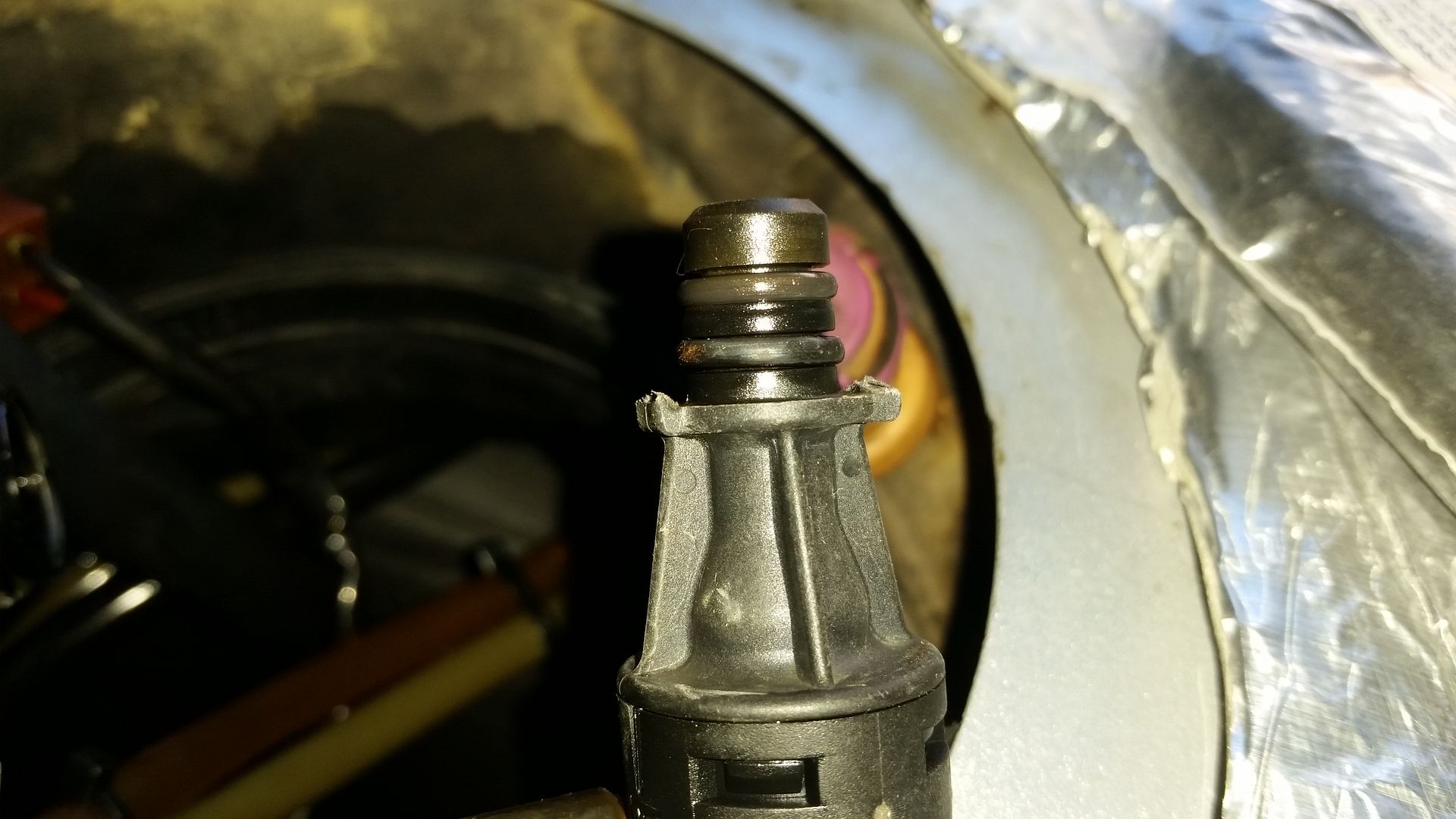

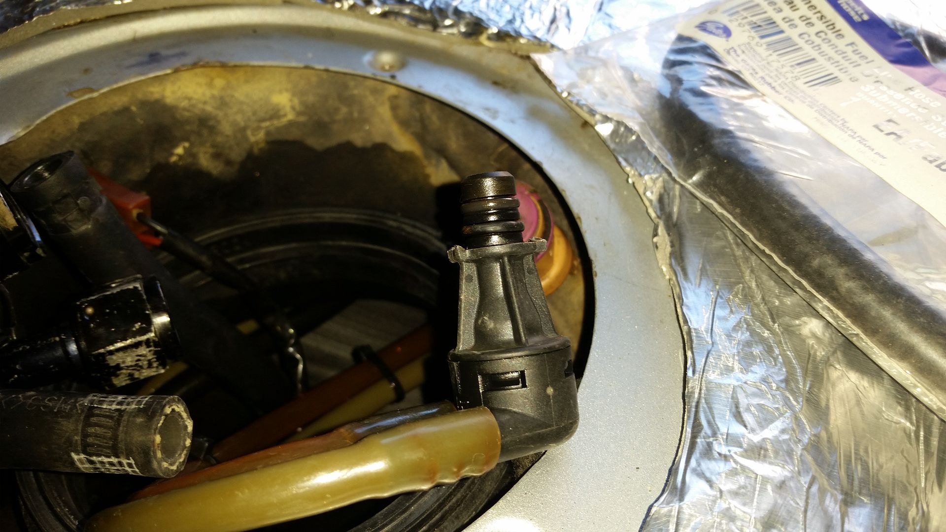

    The in tank return line fitting that drives the internal circulation tank pump can be massaged to accept 3/8" fuel hose. I chose to use SAE 30R10 submersible fuel hose to ensure I don't have any future issues since normal fuel hose will not last very long when submerged in fuel and Teflon hose is not flexible enough to fit properly in the tank.
    Take the internal fitting and trim off the wings as shown below:
    Remove the rings
    Get submersible hose (you can find Gates hose cheaper online, but I wanted it right away and my local NAPA had some):
    The fuel gauge sender connector will accept standard blade connectors, so I chose to use them to mate with the Holley wiring bulkhead so I can easily remove the tank lid hat when needed. I crimped dedicated ring terminals on the 14 gauge wire for the fuel pump, not taking any chances there.
    All set to go in
    Looks like I forgot to grab pics of the fuel pump wiring and the final fit of the billet tank hat. I'll grab those pics later along with pics of my new Earls Teflon fuel lines. Finally I'll be able to enjoy my car without smelling fuel odors!!!!

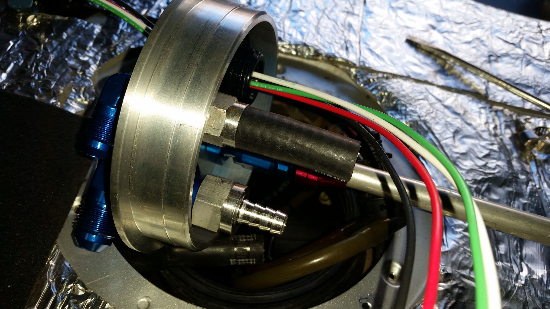

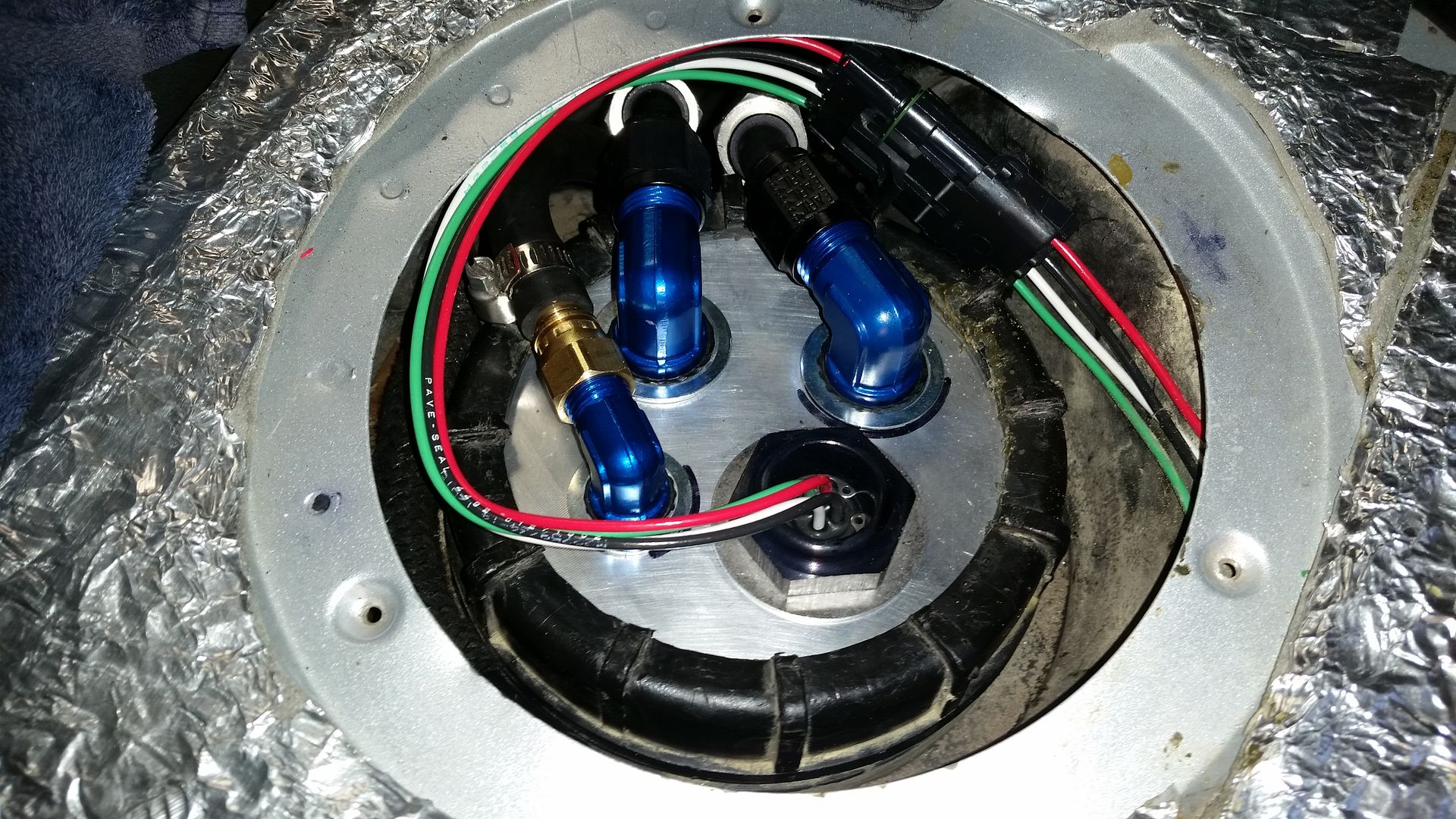

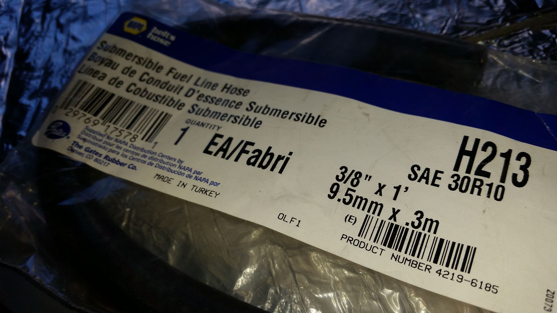

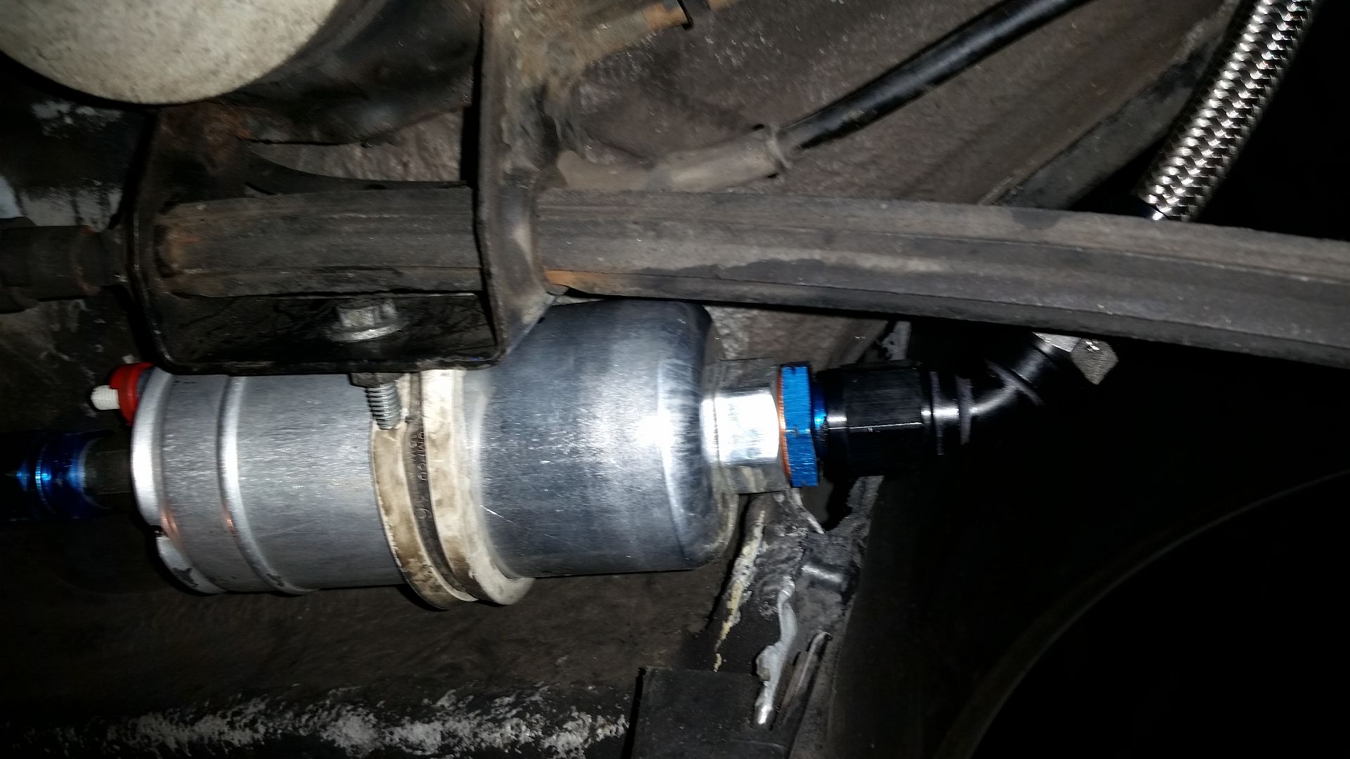

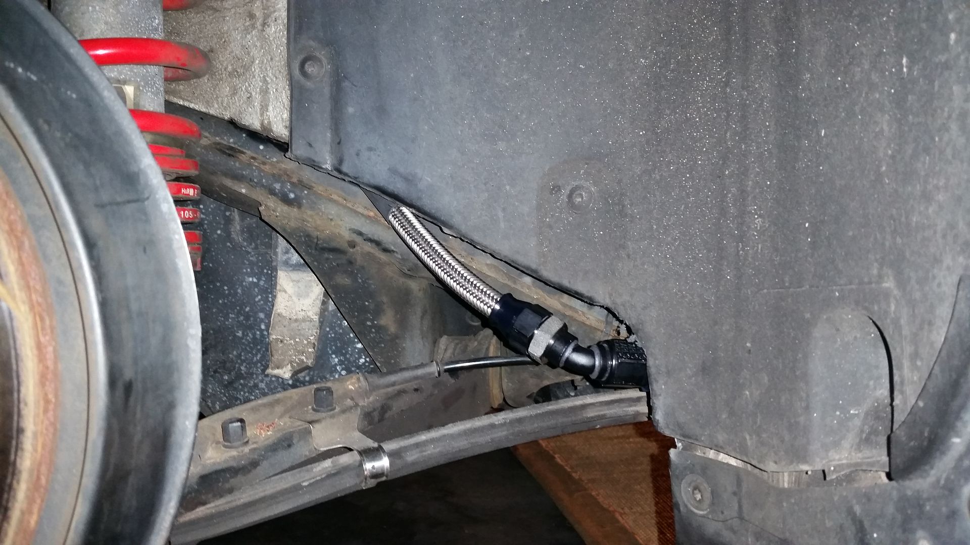

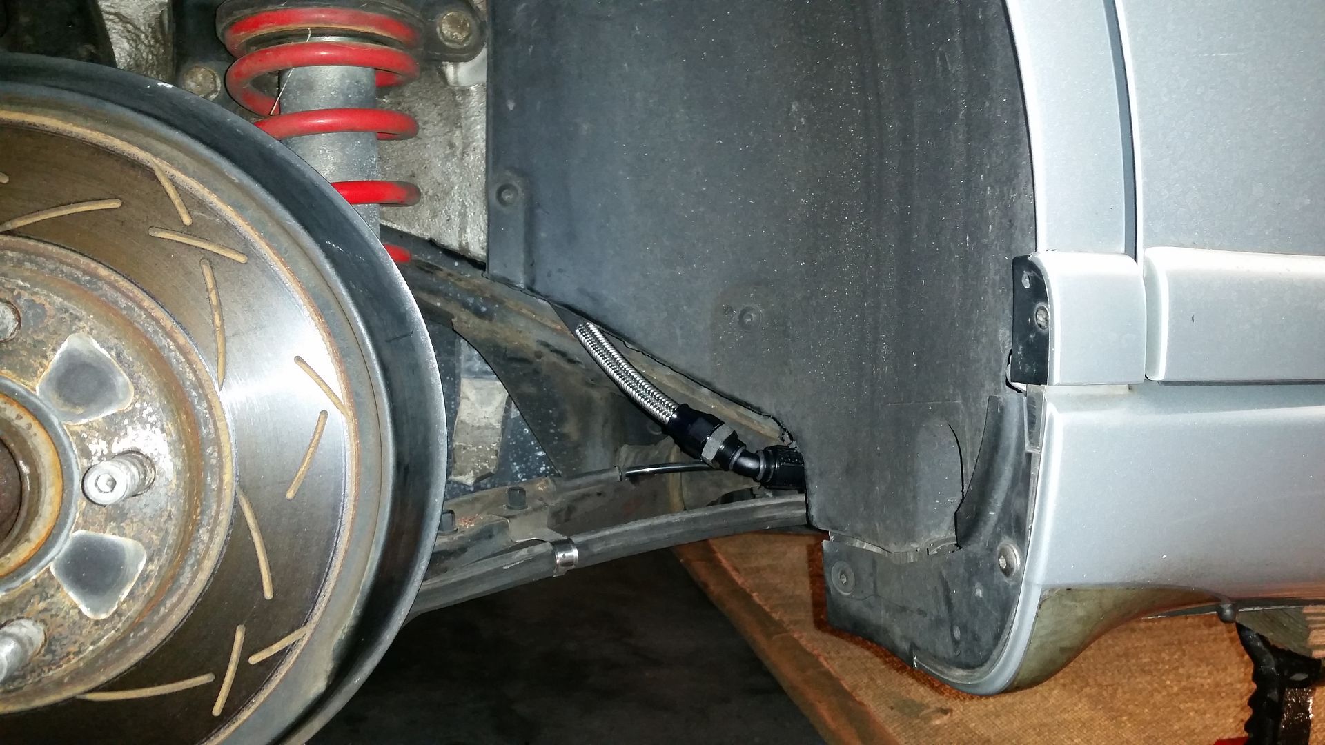

    I decided to adapt to rubber hose for the last 8 inches of the return line to the tank hat connection since the rubber hose is more flexible than the PTFE stuff, this helped make the install much easier.
    Tank hat fitment is perfect:
    New teflon hose
    Should have the rest finished up tomorrow

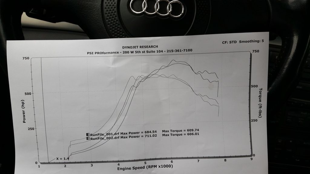

    Local dyno day, did 711whp and 606wtq. Still need to do power tuning and up the boost. But this is a good baseline at 30psi on e85. I'll get the car to the drag strip soon.

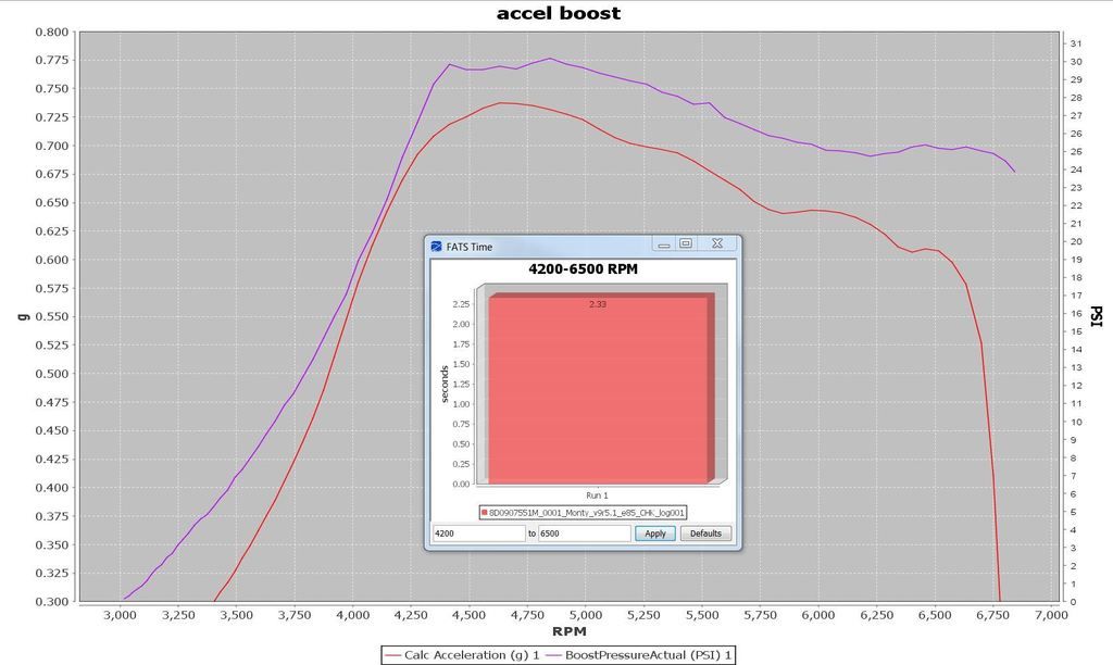

    Good work, that 6062 gives a really nice power band for a 2.7. What turbine housing A/R?
    Any idea what happened after ~6.6K RPM? looks like the ECU had a freak out about something on both runs. Hopefully you can get that sorted as that will def. slow the car down a lot, not only that you would have kept making power as well if that didn't happen.
    Yeah not sure what going on from 7K+rpm. I know we haven't done power tuning yet, boost is tapering off from 30psi to 27.5psi at by 7K and timing advance doesn't ramp up, its just flat across the powerband. Once we get power tuning done I'll hop back on the dyno for a comparison at 35psi to redline. Also only have E78 blend at the moment so hoping I can find some full E85 at the pumps soon.
