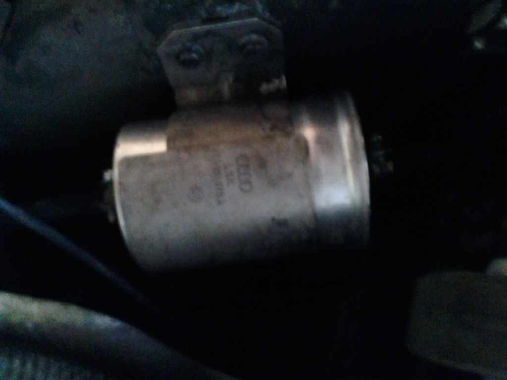

youll be needing one of these to work on. If you guessed it an audi.
step 2

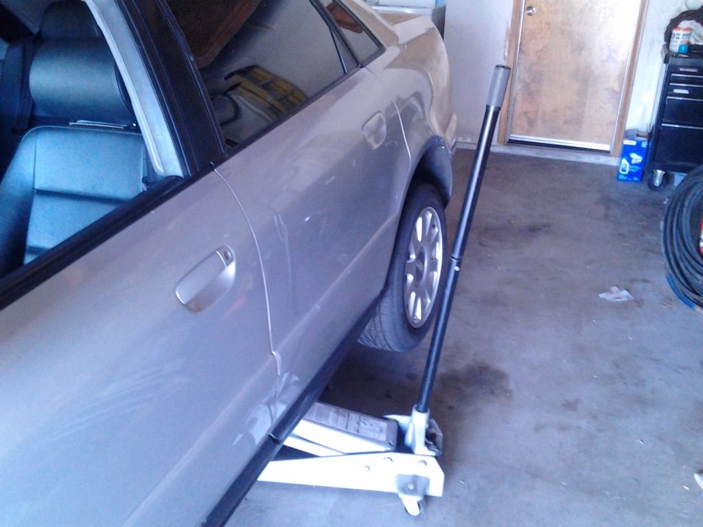

jack up the rear end of the car. Then place jack stands underneath
step 3
now that you have its a$$ in the air get under there and loosen those two bolts in red. Thats the 10mm wrench

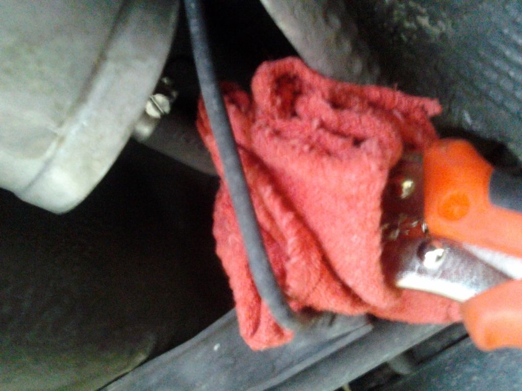

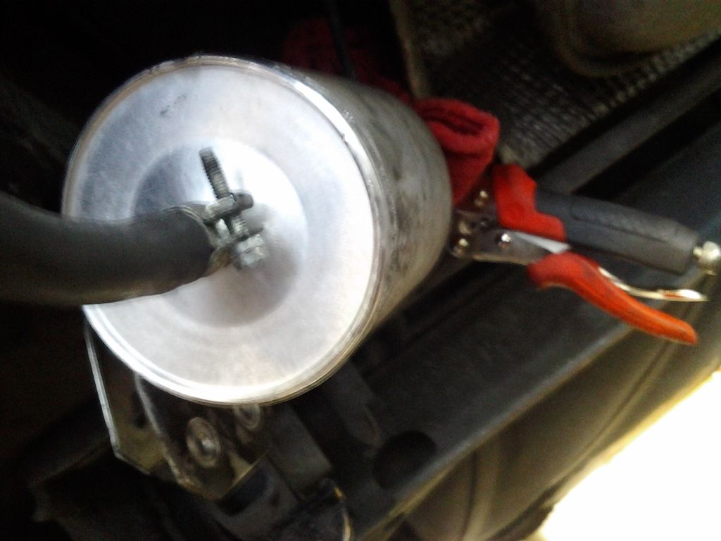

before you unsrew or pop off those clamps for the fuel hose. Crimp the fuel line twords the trunk. Should be the right side of the filter. Fold the rag in half and lay it over the fuel line. You put that there so you dont cut that line. Then use your vice grips to Crimp the line where the shop rag is. should look like this
and another angle
You do that so you dont have gallons of fuel in your face. Make sure you can feel the hose flattened. Its not fun to clean up if its not done right.

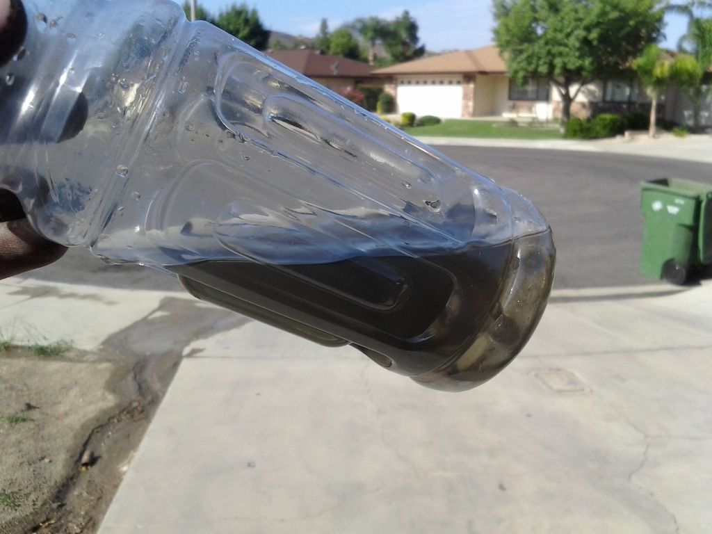

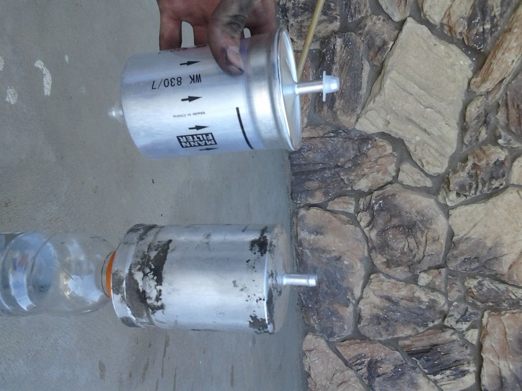

After you could do this
eww dirty filter
^ That is why you need to do this.

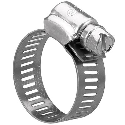

*Make sure you buy some of these clamps if it is not already on the car. Makes changing it in the future way easier
