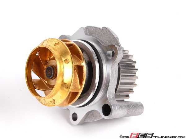

    Do you know if there's a local distributor for HEPU water pumps? I'd even opt in with replacing the pump itself even it isn't broken. Can't rely on this plastic OEM one. I can't believe Audi would even make such a thing. I've read several threads on this issue and how common it is for these plastic ones to break.
    This is the one posted on ECS. http://www.ecstuning.com/Audi-B6_A4-...Pump/ES252347/

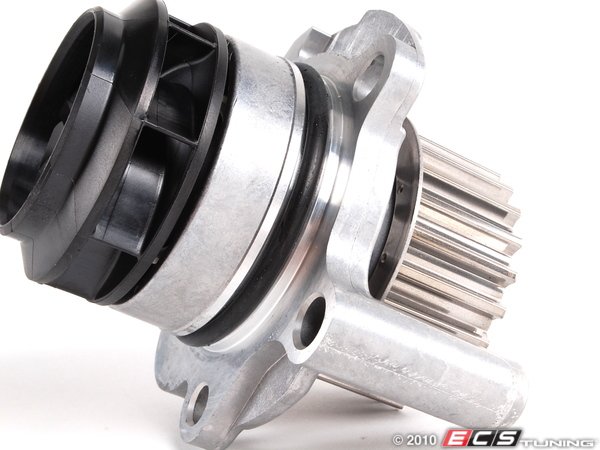

    Well, not the entire assembly is plastic. Only the impellers. This is the OEM one.

    OP when was the last time your water pump was replaced? My water pump leaked for a while but very little till i did my timing belt, maybe its a good time to replace your pump along with a new timing belt =).
    Get the metal impeller for sure.

    Sorry for not updating this, but yeah it was the waterpump. The O-ring on mine was pinched and the pin that holds the impeller and the pulley together was already starting to come out.
    If you notice on the pictures below the pin in the middle is pushed out on the end where the impeller is, that should be flush on both ends.
    @BMX672 do a thorough check for where the leak source is coming from. The only sure way to really find out if it's the pump is to remove the front end and remove the timing belt cover. If you notice white dried spots around the waterpump then it's likely to be the waterpump. When I was looking for my leak, simply looking down or up from under the car seemed a little misleading because the drip was coming down through the front of the motor and it would drip down the oil pan. So I decided to remove the front end to really get a good look. I hope this helps.
    I ended up getting a graf waterpump with the metal impellers.. No pictures of the newer pump because I completely forgot to snap pictures while I was working on the car.. Anyhow, pictures below are of the old waterpump..
