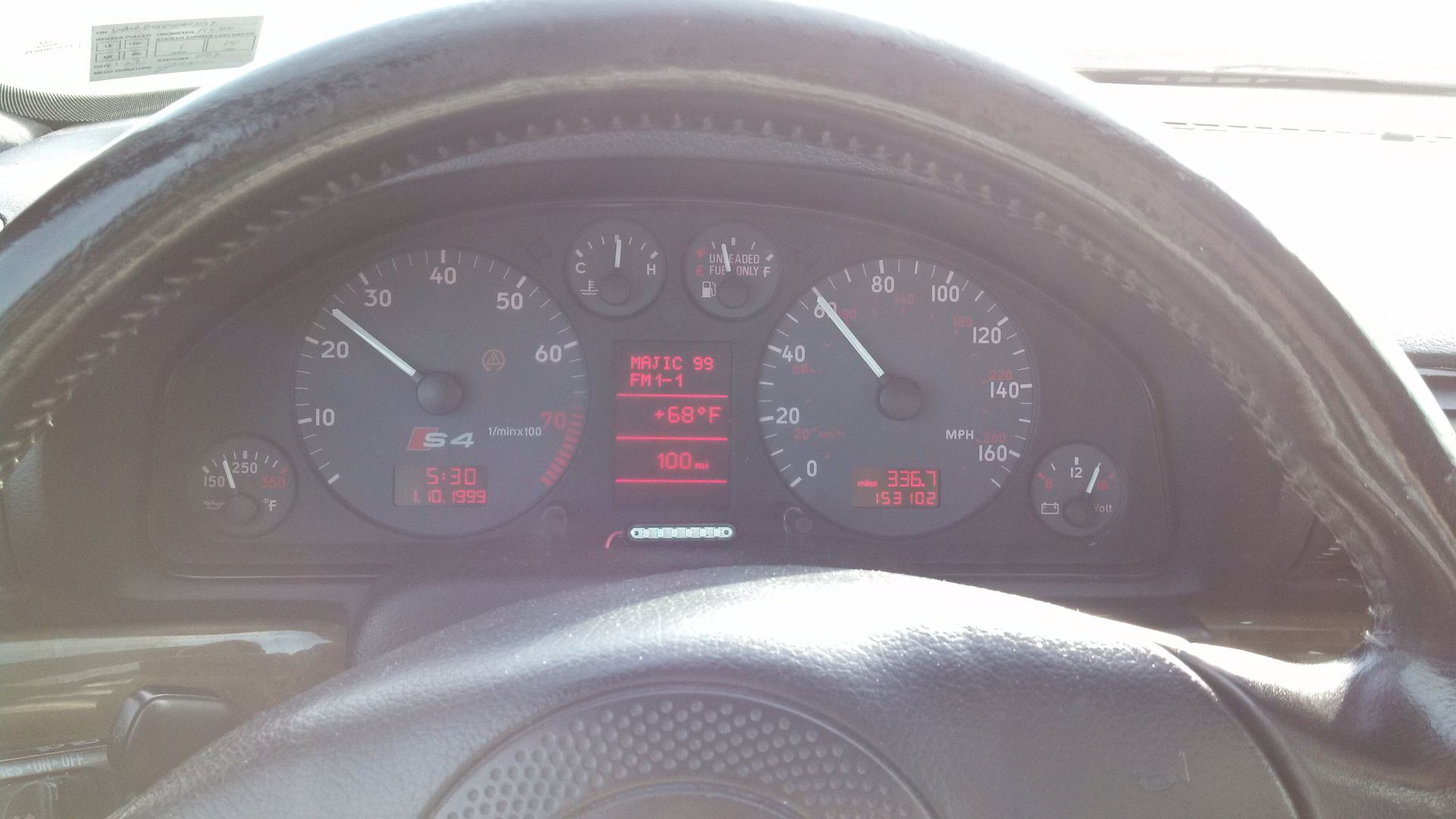

    I forgot to show this before...
    But look! All gauges work, the center display works, and no Check Engine Light lol.
    600+WHP and zero codes when scanned is fun stuff lol.
