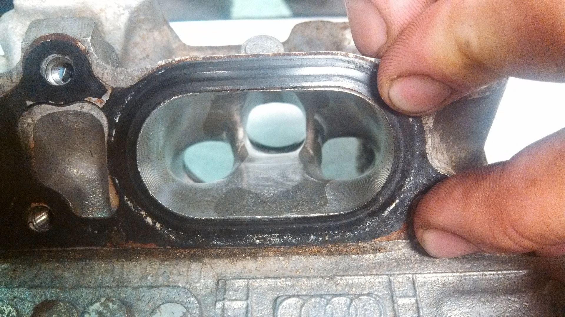

    A few shots of my hand ported head vs BT's CNC ballerness.....

    Quote Originally Posted by spd579 View Post
    They look good, but the opening to the Intake ports needs some work to correctly match the gasket / RS4 intake opening.
    Like so:
    Veteran Member Three Rings spd579's Avatar
    Jun 04 2012
    94608
    05 s2000, 2001 Mazda Miata with SR20deT(GT2871) swap, 1990 Mazda Miata(Tme attack(500whp))
    Charlotte, NC
    Like so:
    Ahhhh......I need to do that. I'm taking the heads back anyway for some additional machining because some of the valves dont look to sit completely flush against the head. The valve faces should sit flush correct?
    Yes. And the combustion chamber volumes should be as close to the same as possible. You can be pretty sure if some of the valves are not seating completely, the chamber volumes are going to be all over the map...

    Quote Originally Posted by rdcyclist View Post
    I was also thinking that as well.....

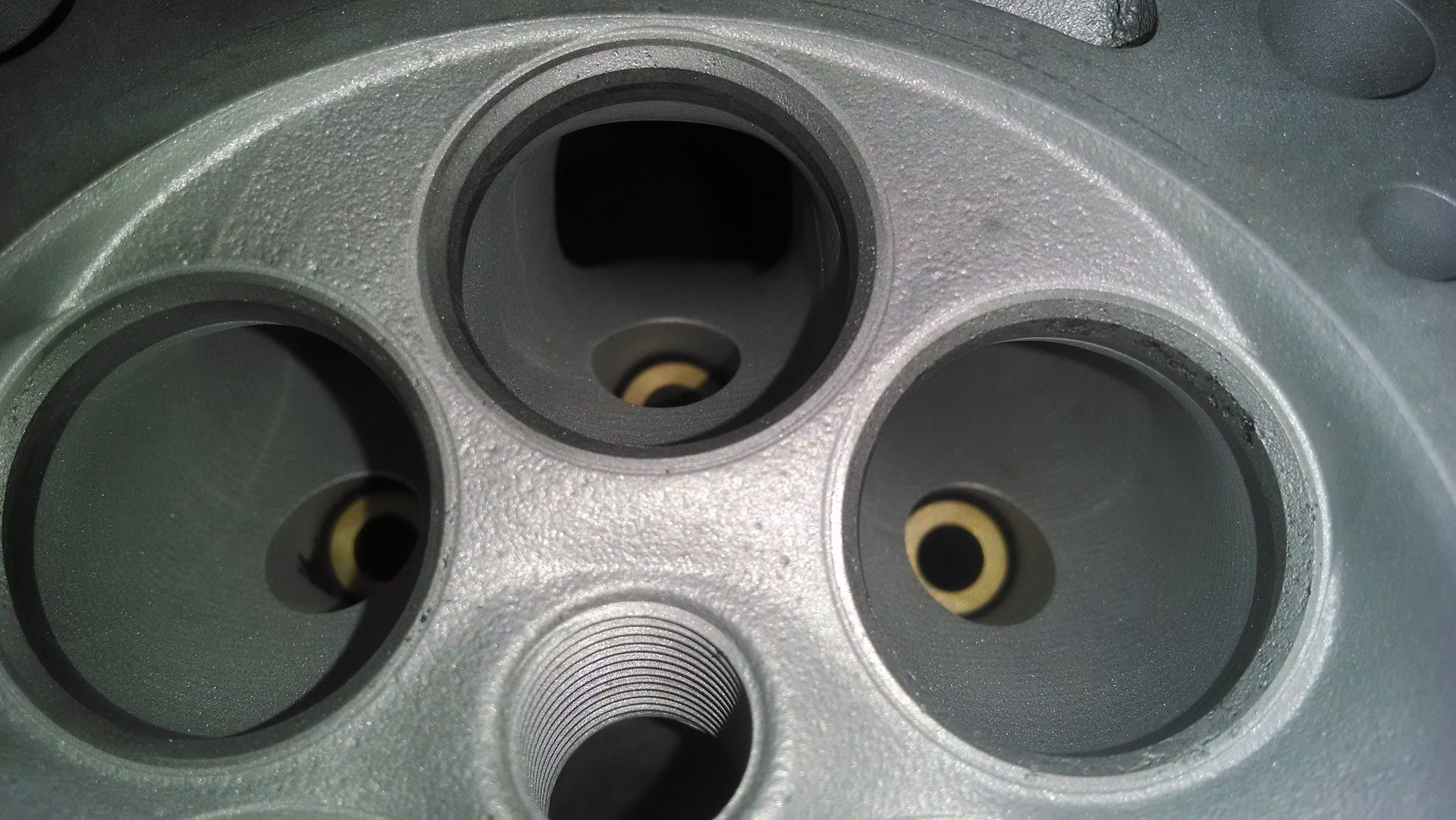

    The valve faces should never sit totally flush with the chamber as you have the thickness of the valve. Usually you'll have around 1mm of valve sticking up from the valve seat.
    Are you maybe seeing the middle intake valve looking like it sit's at a different height because of the angle of those valves? I can take a pic of a stock head if you'd like.
    I have a spare stock head I'm taking up to the machine shop with me when I return them. I apprecaite it though. Go ahead and post a pic for info though if you have one.

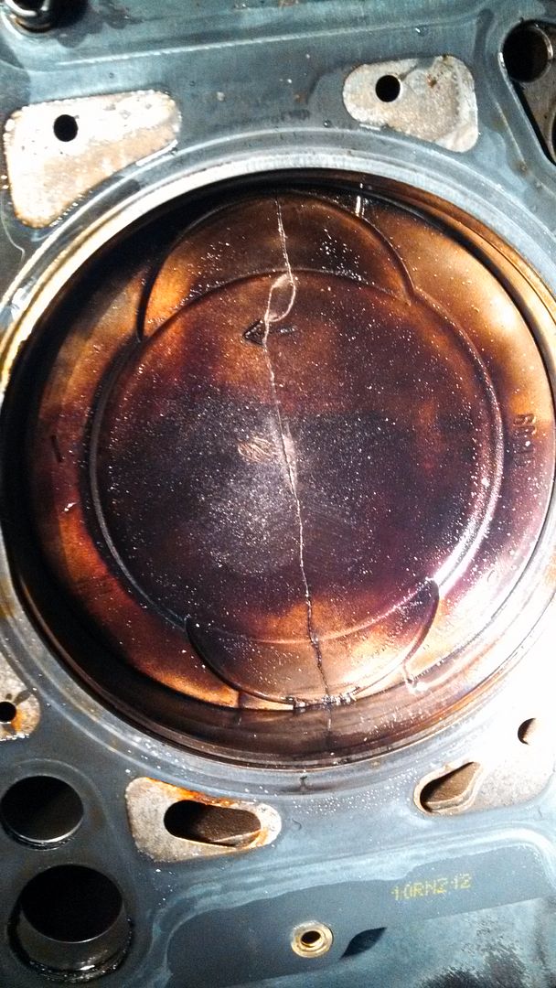

    Compression was down to 70psi in that cylinder, and she was smoking like a pig :-)
    I dont get it?? cool piston graphix makes you loose compression? I had some flames patterns put in my ceramic tops.....I guess lightning bolt designs are no good???
    Sep 18 2012
    100686
    State College PA
    Haha indeed. If it was just a graphic that would be cool.. but as it's a crack through the piston it's not quite as neat ;-)

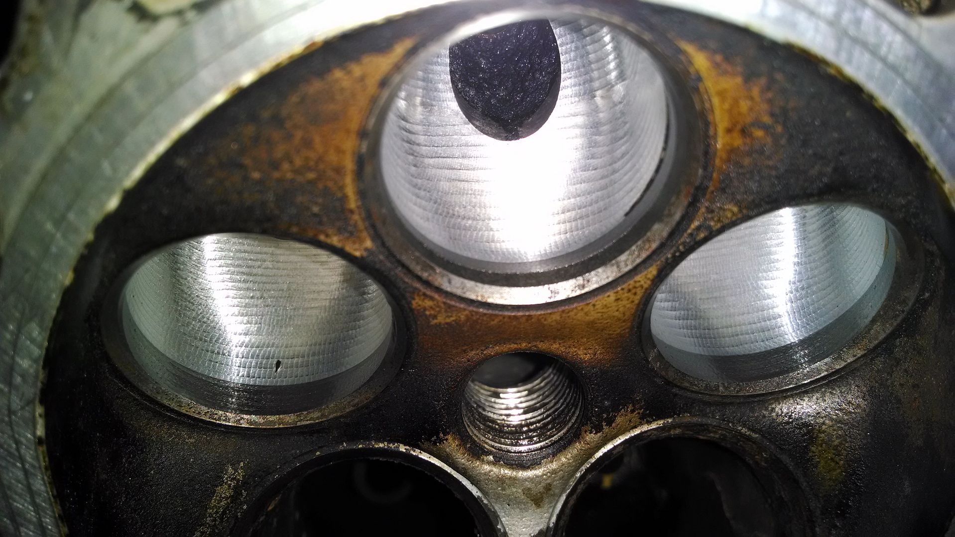

    So i don't think I ever shared this picture...
    This is what I found when I pulled my heads off the day after running 10s in the car... this was why it was missing at the track in 4th gear...
    Silly stock RS4 pistons...
    holy shit..... just had a flashback to my childhood of those "this is your brain on drugs" anti-drug commercials..... kudos to you for generating enough power to kill a forged RS4 piston so completely! You should save that thing to use as an Easter egg for your kids lol

    I'm still surprised that piston stayed together...
    Sep 18 2012
    100686
    State College PA
    Yepp. I'm going to pull it from the block tomorrow and see if I end up with 2 pieces ;-)

    I'd be willing to bet the wrist pin is what's holding it together
    Oct 27 2011
    83106
    TOYS
    Philly Suburbs
    I got $5 on the cylinder walls/piston rings
    Haha they're def helping but the wrist pin is the foundation
    Oct 27 2011
    83106
    TOYS
    Philly Suburbs
    your right, especially with the crack's orientation
