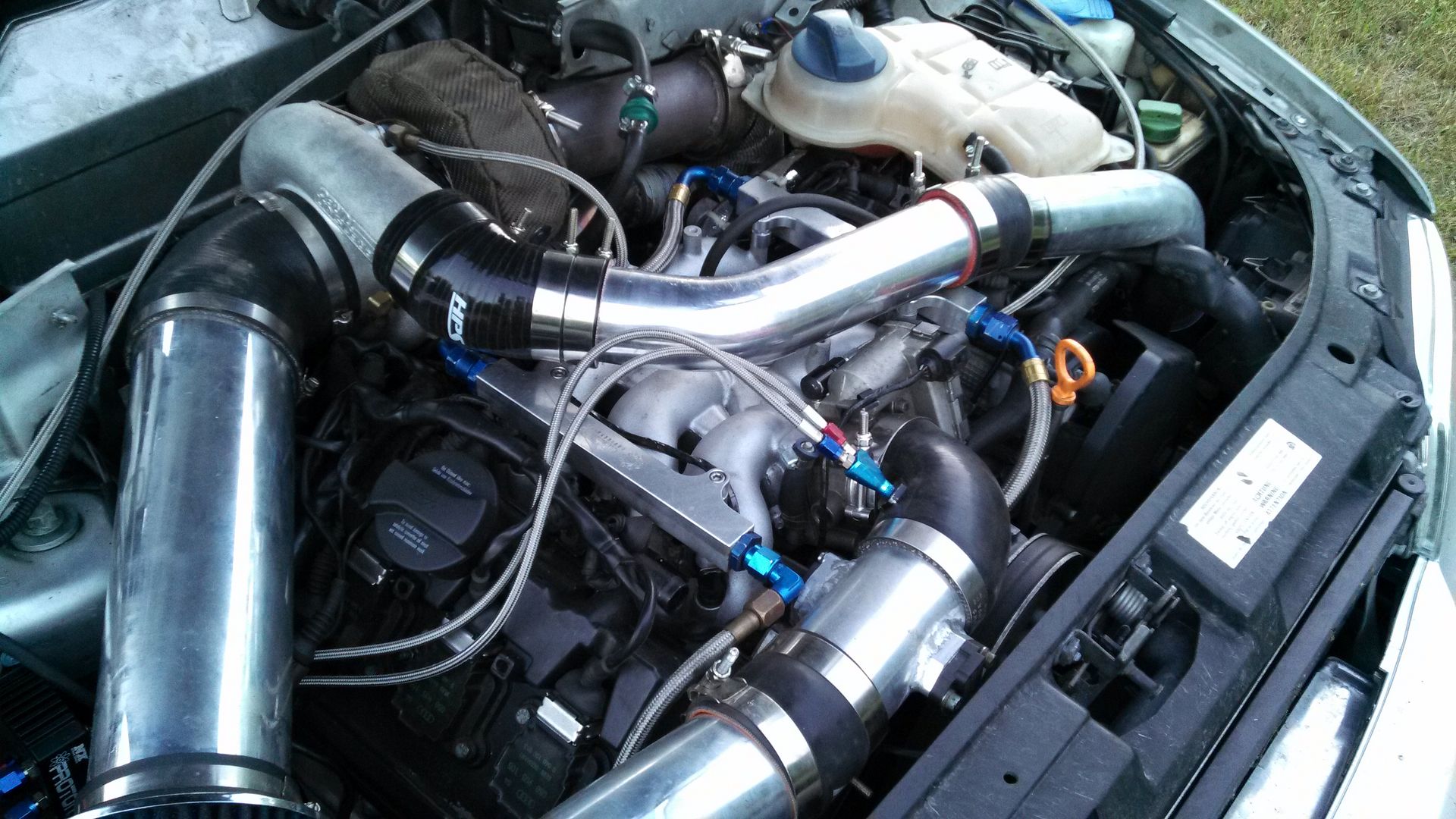

    Got my new 45 degree 3" to 2.5" transition coupler so I fixed the post turbo piping how it should be:
    Looks really good, man. Just watched the video over on the RaceWars thread; it definitely sounds SICK.

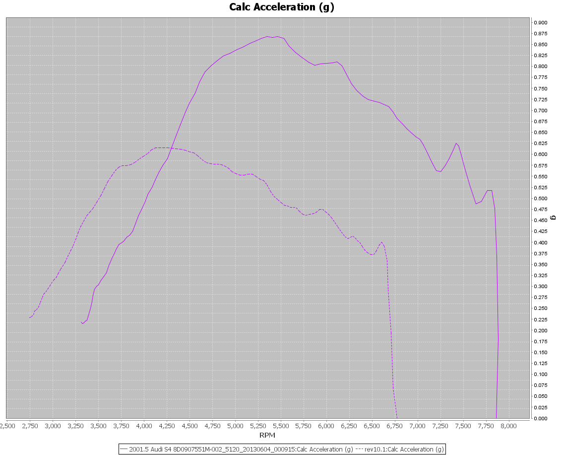

    Only thing I changed was the RPM per MPH was changed to reflect reality.
    Here's my settings:
    Mass (kg): 1700
    RPM per mph: 68.11
    Coef of drag: 0.31
    Frontal Area: 2.034
    Driveline loss: 25
    Nice. Always good to know, as those figures affect the output of the accel g curves.

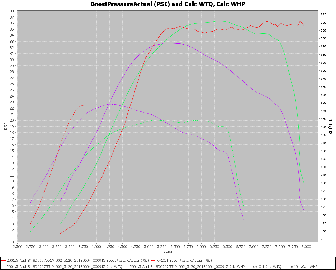

  16. #2296
    Sep 18 2012
    100686
    State College PA
    So I'm going to post up logs here and some video once I analyze them... but the car is just silly silly fast with my latest revision... like silly.
    It now scares the crap out of me... it is hard to keep it in a straight line!
    1.95 FATS... logs to come lol.

    B9 Q5 | Brilliant Black

    I went both ways on the same stretch of road... 1.95 one way, 1.97 the other way.

    Looks like the 70HP nitrous shot adds ~200WHP and ~200WTQ during the boost rise lol.
    It's quite epic.

    Stock pump feeds surge tank, 2 x Inline Walbro 255HP pumps feed fuel rails.
    Ah, nevermind on the bumping of the fuel pressure then. With that fuel setup you'd definitely be better served staying where you're at pressure-wise and just getting bigger injectors. That way you don't have to re-jet your nitrous either (assuming you're running a wet shot).
    Wow, you're in elite company. The only other car that I know of with a sub 2 sec FATS was Simpply's old red GT car, and I'm pretty sure that wasn't full weight.
