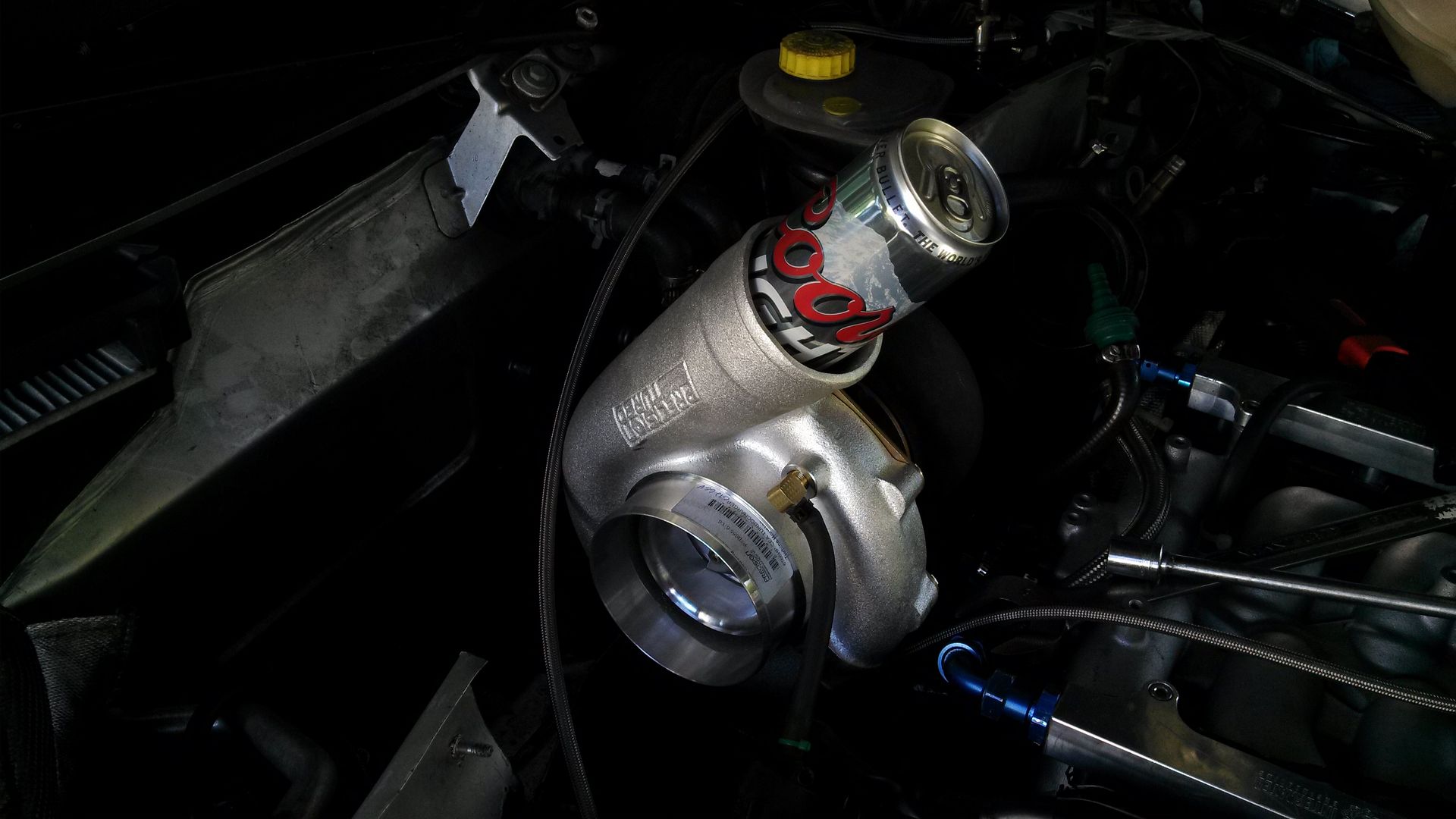

    My first Audi - 2001.5 S4 with Custom Single Turbo setup...
    It's here! Woooo.
    Big big turbo time lol

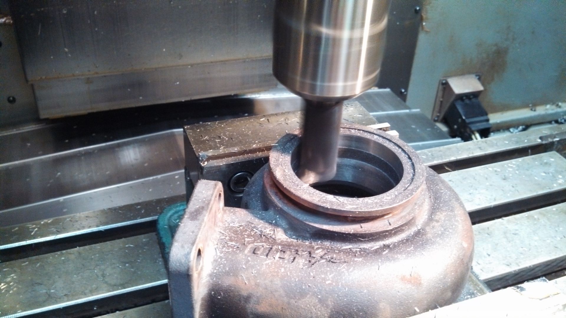

    Slight snafu this morning.
    Put the turbo on then realized the turbine outlet is smaller than 3" vband... so it won't bolt up to my downpipe setup.
    The solution is I'll take my AGP exhaust housing over to my work later and bore it out 1mm to work.
    So a slight delay again. blah.

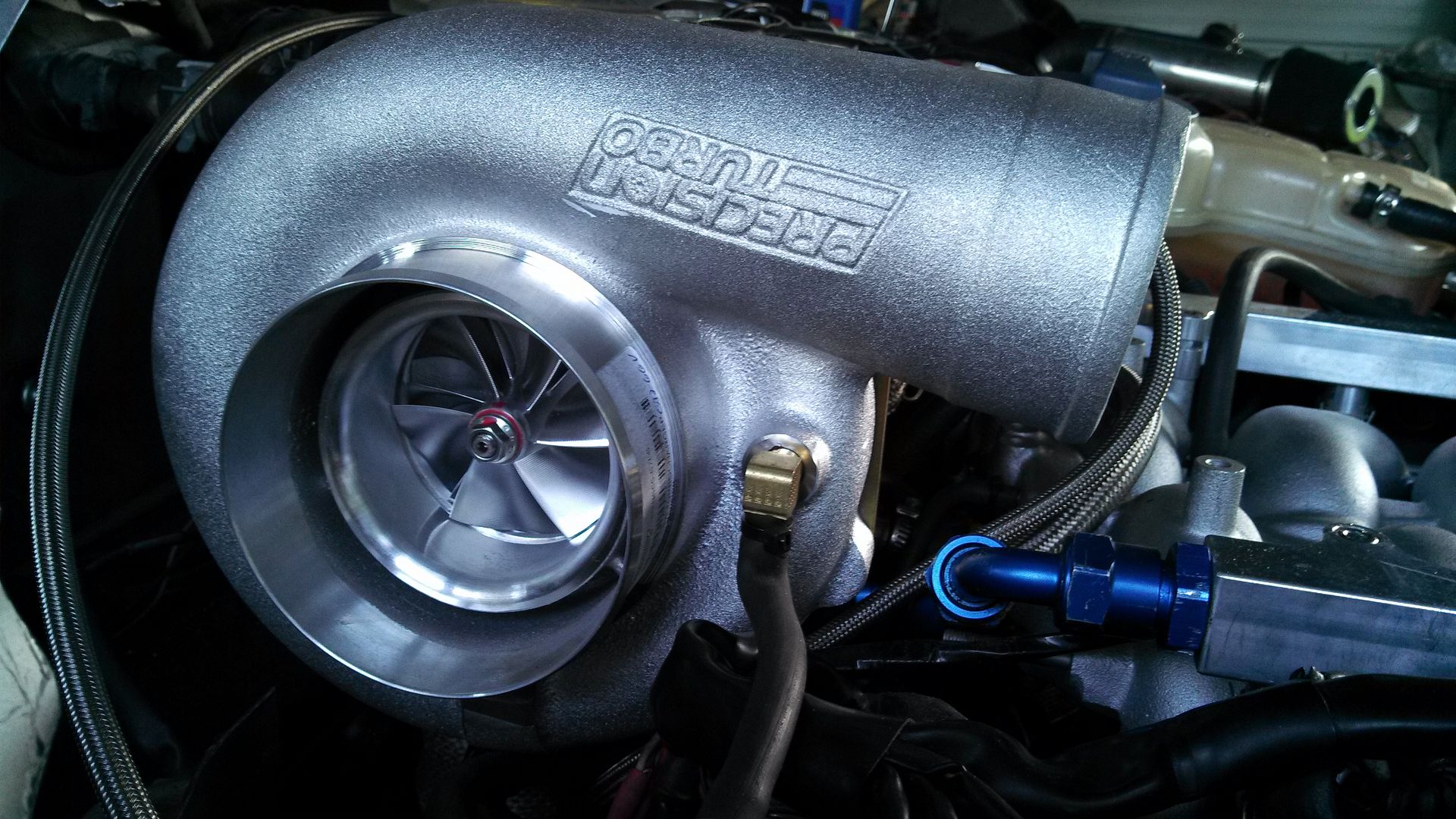

    Well I'll get video and logs tomorrow but I love this turbo!
    The damn tuning spools quicker than the smaller AGP!

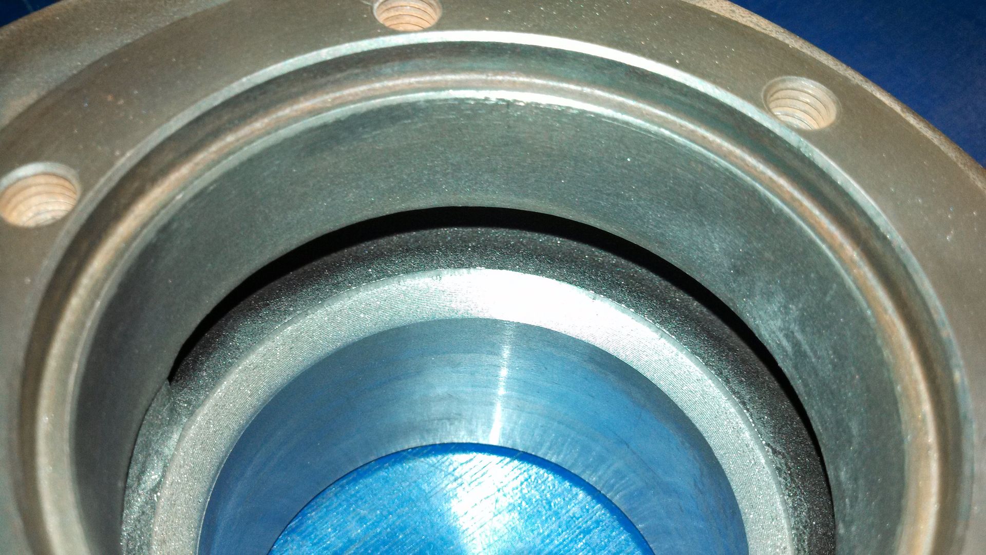

    So it wasn't easy going.
    The PTE housing I got ended up being 2.5" v band out not 3"...
    So it was either wait till next week to get a housing... or... take my AGP 65mm turbine housing and modify it to fit the larger 66mm PTE wheel :-)

    Then I had to flip it over and drop the profile for the wheel edge.
    I <3 CNC lol
