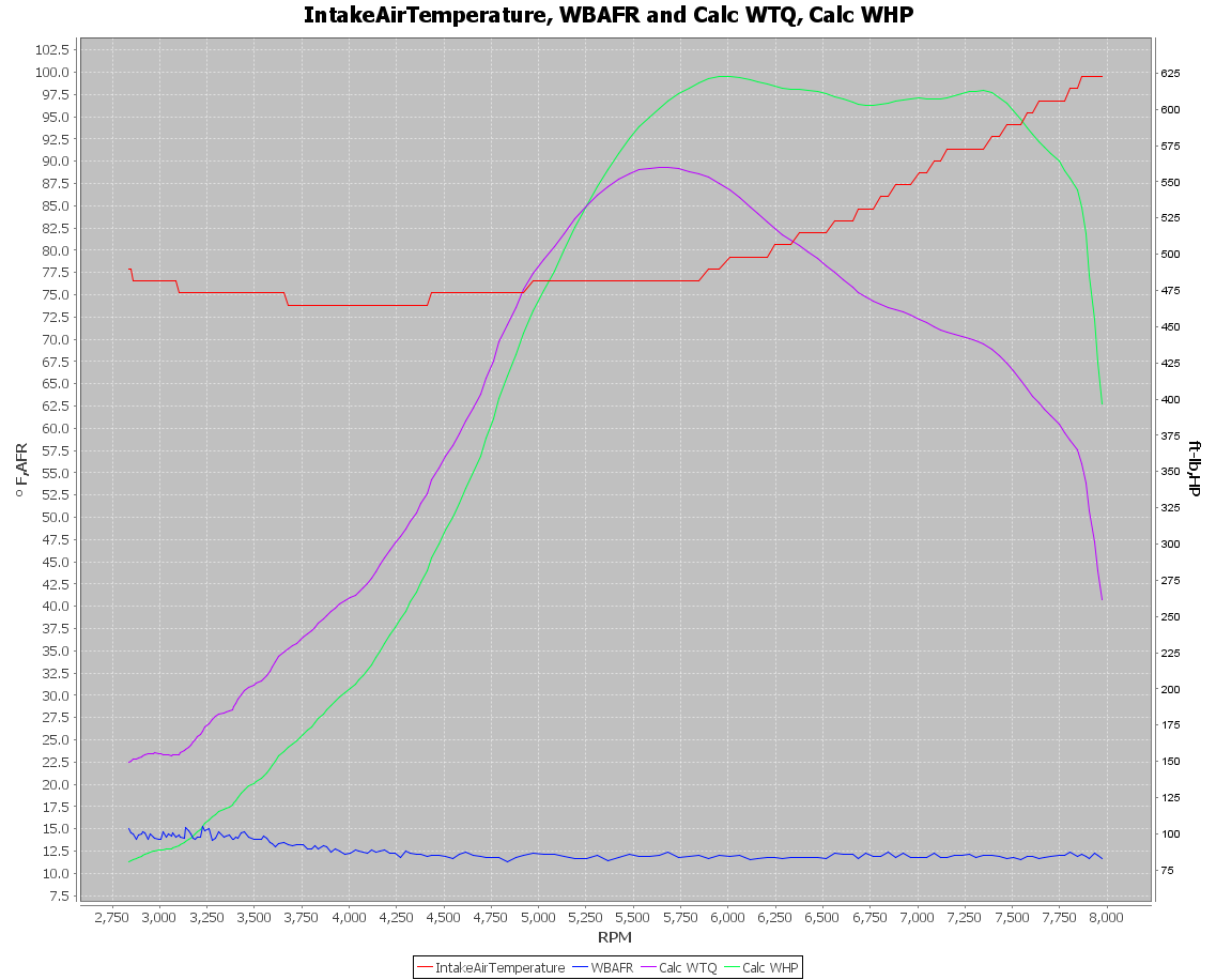

    Here's a log plot from this morning as I was almost at work..
    The Intercooler is a Treadstone 1035. It's 10" high and 3.5" thick... But... I don't have all of it exposed yet on the bumper. I have to pull the bumper and remove another 3" or so at the top... so there's a lot more cooling left in it.
    This plot shows Power vs IAT vs AFR from the Wideband.
    The car is a LOT of fun... 2nd gear is scary and 1st and 2nd the car often thinks its RWD lol.

    Nice!
    Intake temps seam a little high towards the top end but nothing to be too worried about. Was that on meth? Although you are probably just about at the max efficiency of that core. I wouldn't be surprised to see a nice gain from going with one slightly bigger later on - especially on spray. Back when I was big into EVO's most guys making over 600+ whp were running a core that was about 22-24in long X 12-13in X 3.5-4in thick - was good for 900hp.
    Definitely let the one you have get as much moving air to it as possible.

    With Meth.
    Intake tract is exposed to underhood temps though too still, that isn't finished yet lol.
    Plus the core is 1/3 still blocked...
