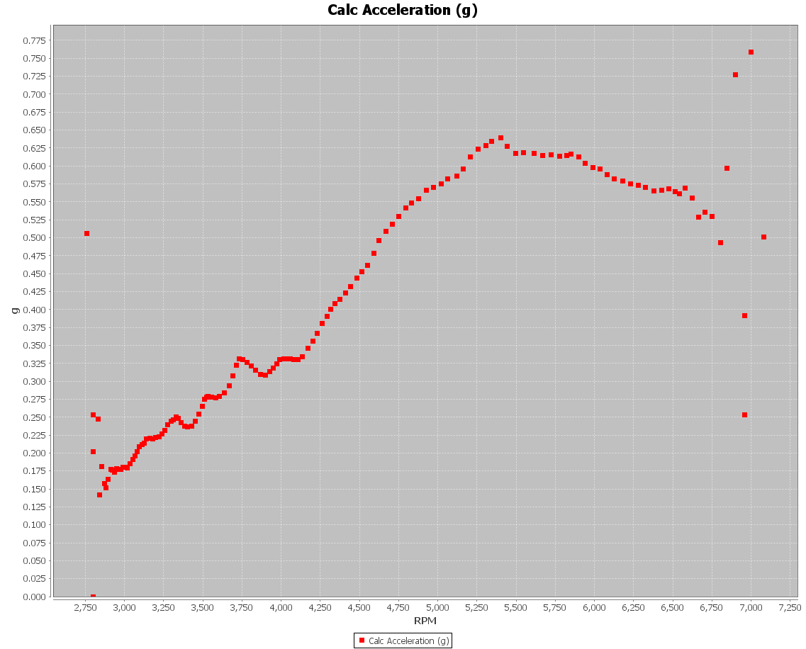

    I can do that.
    And here ya go:
    Nice curve! Could you post this "Marks ECUx" style graph?
    World's Fastest B5 Avant biturbo Full Weight
    With Race Seats @3800lbs
    TTE950+ 100-200kmh 3,81s

    Quote Originally Posted by Mikse View Post
    It's actually even higher g's with the correct tire size lol.
    And I will see if I can do that

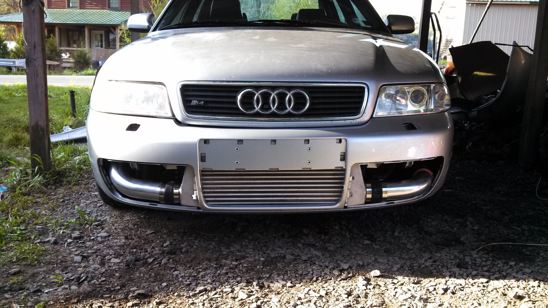

    I got the bumper support trimmed out last night and the bumper on.
    I still need to cut out the top section for the intercooler...
    Also not happy with drivers side intercooler piping - it sticks out the bumper slightly that side, need to make the piping a little shorter to fit like the passenger side.
    Drove the car to work today. 600WHP sure is fun lol.
    Car needs a wash bad! lol

    No RS4 grille? Probably slow..

    Quote Originally Posted by AudiSportB5S4 View Post
    The RS4 grill is in a box in the garage... lol haven't had time to install yet haha.

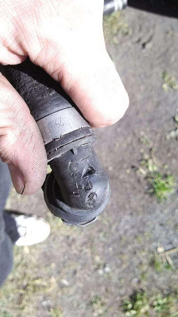

    so what exactly was causing the slow coolant leak back there?
    Glad to hear you are making some more progress

    Quote Originally Posted by getslideways View Post
    It was what I thought... I took a chunk out of the drivers side heater hose attachment when I pried on it with a screwdriver.
    So it was seeping a little. New plastic piece will fix that.

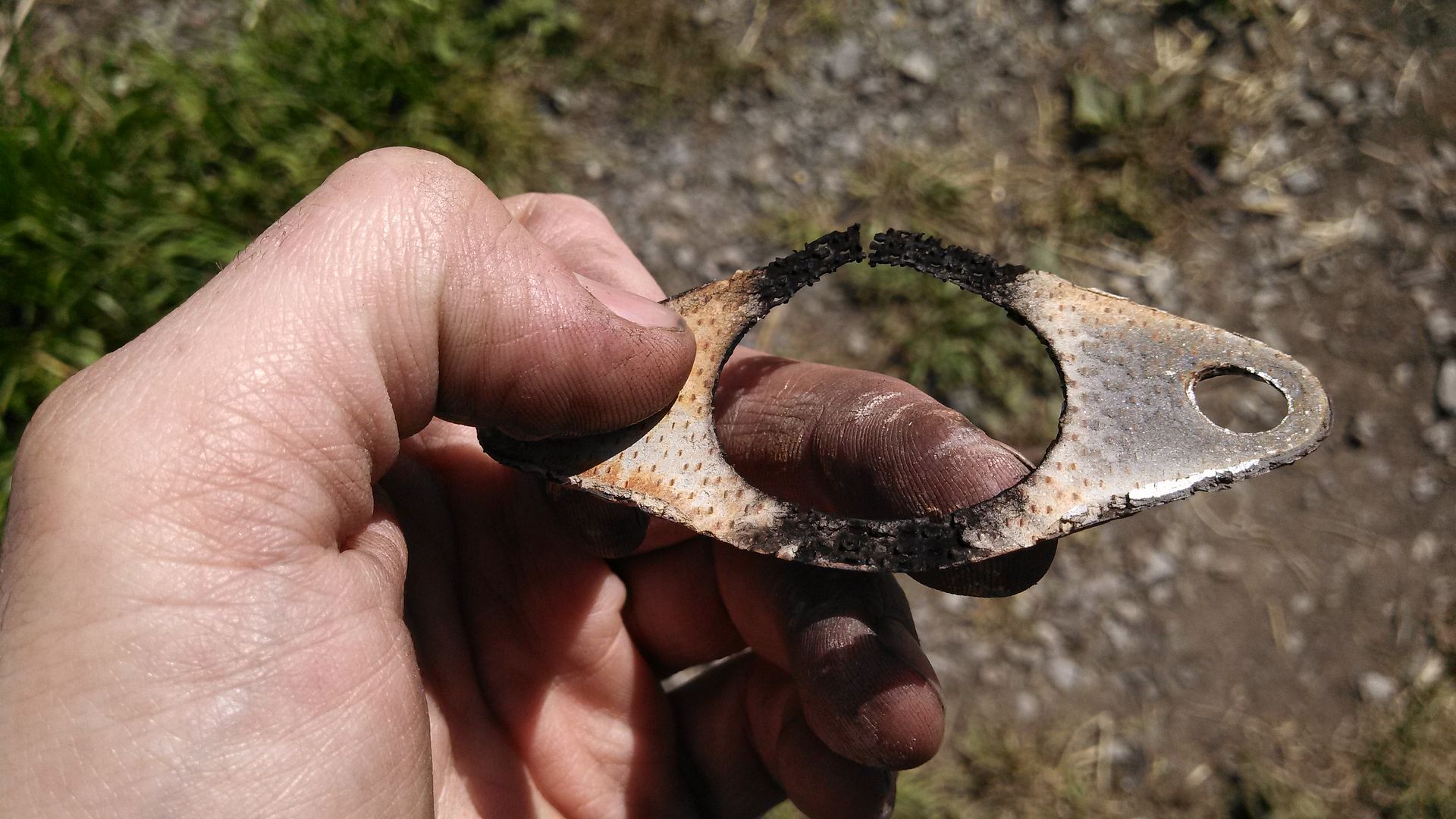

    I found the exhaust leak...
    Also found the coolant leak:
    Replaced the heater hose pipe and added some extra protection to it:
