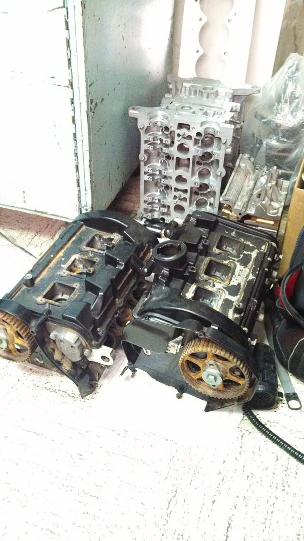

    It's always a tough day when you can't decide weather to run RS4 heads of port matched 2.8 heads on your temp motor... Hmmmm
    On another note my office looks like an Audi Shop! lol
    Decide by midnight.....or all heads will turn into pumpkins!
    I THINK I would save the 2.8 for the main scooby, and run the RS4 just because I'd be curious. But I don't know. lol

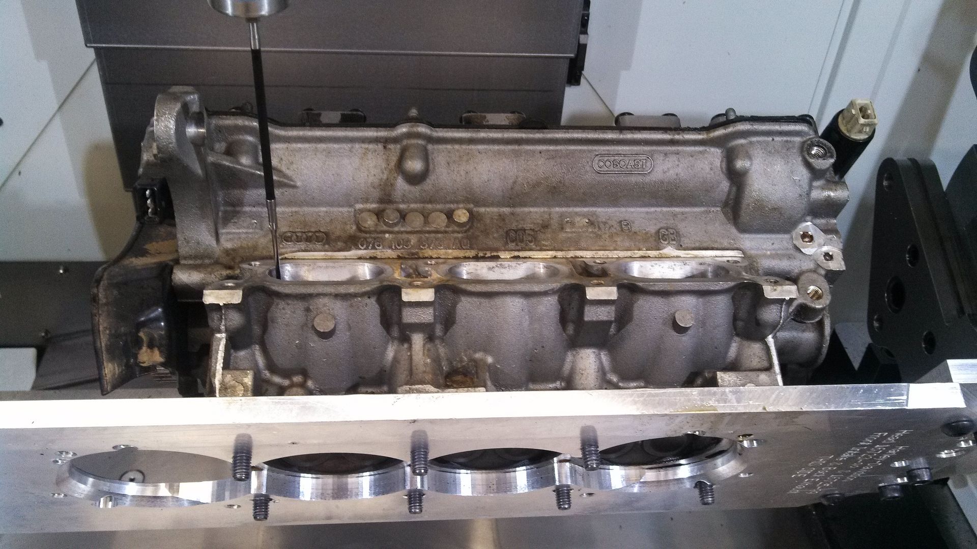

    Doing some preliminary digitizing on the RS4 heads:
    Have the RS4s ports been touched or are they just SUPER clean?
    Edit:never mind... They aren't, I zoomed in.

    Quote Originally Posted by TweetsS4Estate View Post
    They are dirty but have been hand polished with a sanding roll... Cosworth either cleaned up the castings by hand or did cnc porting of the castings and then cleaned them up. But they have been smoothed out throughout the port.
    Once I get them hot tanked I'll show you.

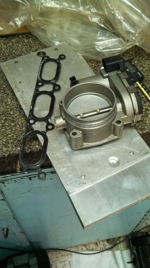

    A little something I whipped up tonight:
    It's a transition piece to allow a stock S4 manifold to be used on 2.8/RS4 heads.

    Nice! And adds runner length! A lot of people tapered the old VAST phenolic spacers like that (in a much more crude fashion)
    The manifold with have half or the transition itself. So it will be nice and smooth.
