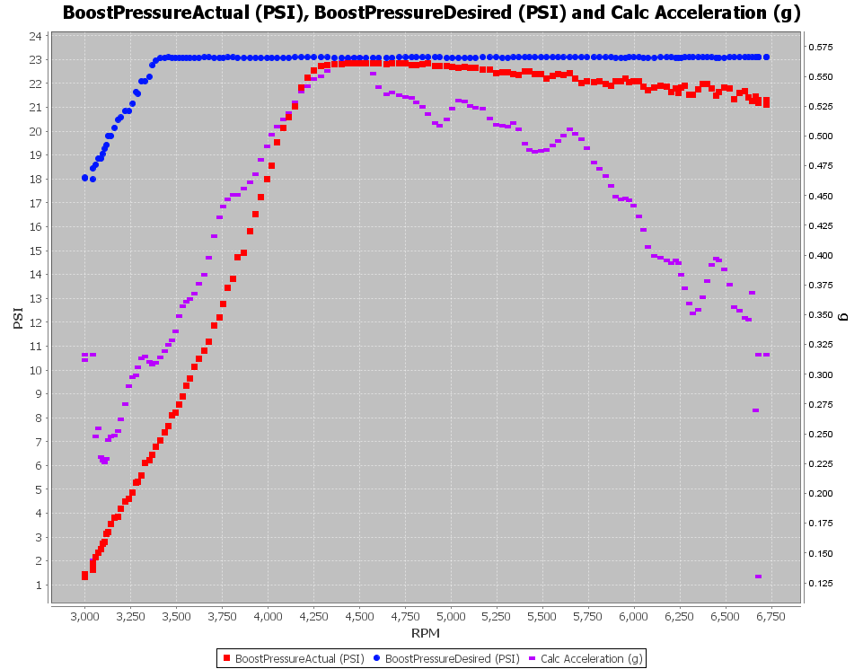

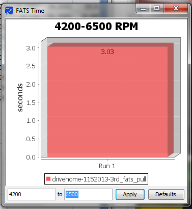

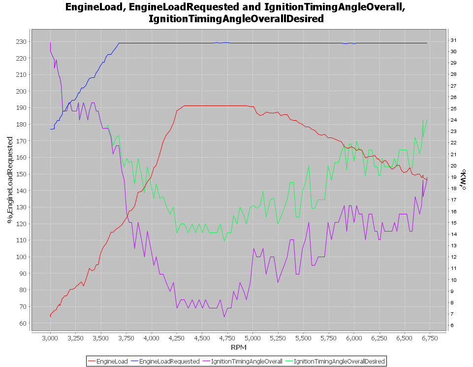

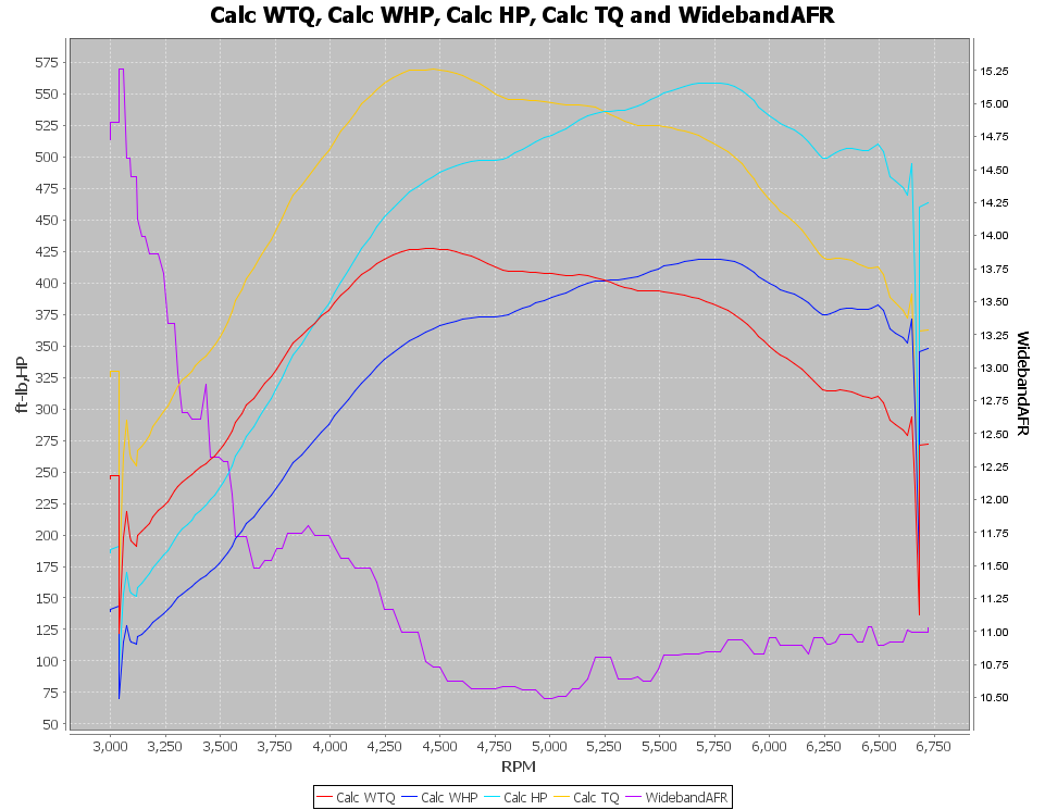

    Did some tuning today of things and I'm getting consistent 3.0 FATS times at less boost than before, really starting to get things dialed in.
    The car feels a lot smoother now as well.
    Here's some plots from the way home from work.
    Oh and this was on a slight incline as well.
    The second plot shows actual Wideand AFR being logged at the same time as all the other data, such a nice feature to have!
    You can see it got pretty rich because of the knock, so I am going to dial the knock protection in a little better now.
    Once I get the AFR just right I'll throw more timing at it, then more boost.

    Here's what Virtual Dyno said about my drive to work today after my latest tweaks.
    I made sure to use the 1:1 scale factor in Virtual Dyno
    I need to work now on stopping the top end from falling off.

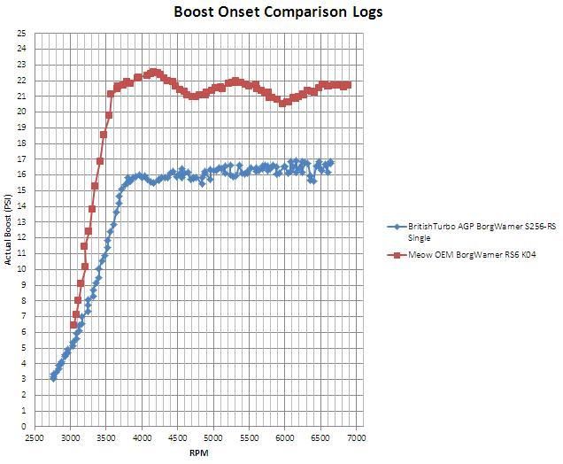

    Quote Originally Posted by Meow View Post
    Said I was going to get this up here earlier...
    If you get me 25psi Logs I will update it ;)
    Just boost onset, not necessarily torque hit... but you get the idea!
    Your boost profile logs are the earliest I see for RS6's, do you have handfuls of logs showing this boost profile in 3rd gear, or just 1 or 2? The majority of the straight RS6 turbo logs I've seen spool much closer to what britishturbo's setup is doing, ~15 psi a little after 3500 RPM.

    Quote Originally Posted by jibberjive View Post
    It spools real damn fast in the winter. Summer time onset is a bit slower, the log above was done in cold temps, 3rd gear. I ran a 3.2 fats on that run. About 20psi by 3500 rpm.
    In my sig there is a link to my thread with a ton of logs. You can see my summertime boost onset was impressive to even Doug from Frakenturbo.
    Here is the log thread: http://www.audizine.com/forum/showth...RS6-Turbo-logs
    Purple line, psi numbers on the right (sorry for the confusion)
    Winter 3rd gear
    Summer 3rd gear

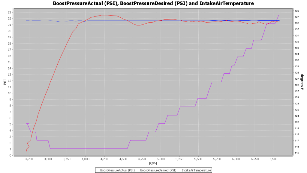

    Sep 18 2012
    100686
    State College PA
    Nice!
    How are your IAT's looking with your water-cooler setup?
    Shitty right now... lol I don't have enough reserve in the system, I'm going to fix that shortly.
