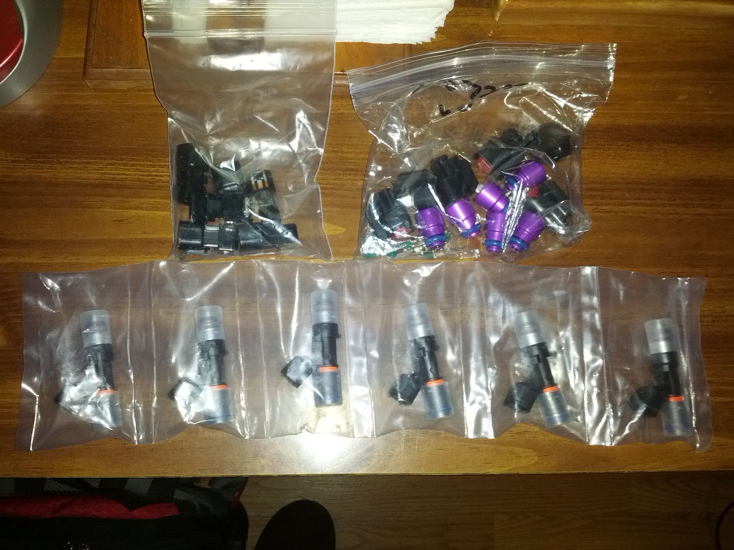

    So I'm picking up 725CC Injectors and a MAP sensor tonight on my way home ;-)

    I'm sure you are aware of this, but the 750CC (@ 3bar) EV14 style injectors seem to be the standard upgrade around here. What injectors are you going with?
    Everything he does is against the grain, might as well be against the grain with his injectors too! lol
    Sucks you couldnt use the 1600cc ones you had, resistor packs can really hurt reliability and driveability
    I can't let all my plans out of the bag :-p Haha

    Oh and I forgot to add that I installed the 725CC injectors yesterday.
    At the 4bar (58psi) that I am running them they are equivalent to 840CC.
    Car is retuned for them for the most part, need to put on hold though until I get back from Montreal.

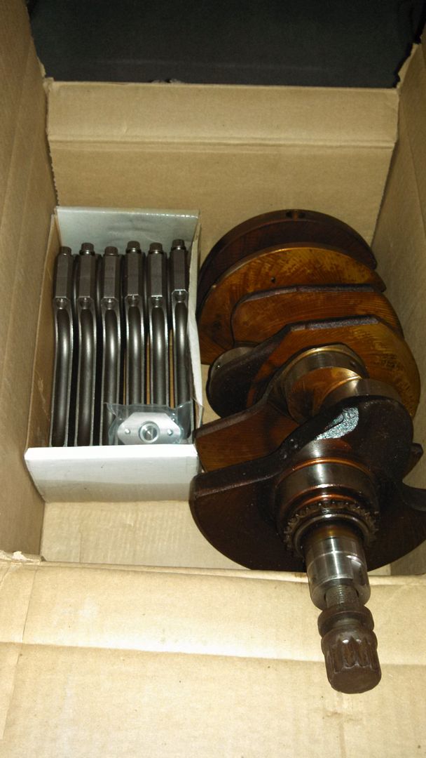

    Since I was up in Canada for business I stopped by the good people at INA... and wouldn't you know I'm leaving with a bunch of parts for my 3.0 build... oh boy!
  32. #512
  33. #513
    Oct 27 2011
    83106
    TOYS
    Philly Suburbs
    What pistons are you planning to run?

    mmmmm good choice... What's your goals for the built motor setup? 1/4 times?
  36. #516
    Sep 18 2012
    100686
    State College PA
    Well I can do 450 - 500 whp with what I have now... so there would be no point doing the new build if it wasn't over 700whp ;-)
    And she had better run 10's then lol.
    But we shall see.
    The boys at INA and I may be doing some things never seen before on the 2.7
    And I could do an rs4 but we decided there's no point ;-)
