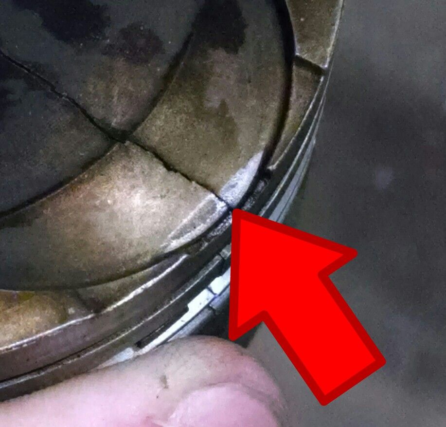

    I forgot about the piston rings!!!! could be the piston rings holding it together......I'd say it's a collaborative effort of the walls, wrist pin and rings

    Quote Originally Posted by slowrideBC View Post
    no surprise here...stock shit is weak....what did you expect to happen?
    It's fun to find the limit of things... lol

    Quote Originally Posted by bobkatkat View Post
    You really should start keeping the pieces in display cases. Kind of like a prized Baseball.
    Maybe I'll make a display out of this one... the aftermath of 10 seconds on a 2.7...

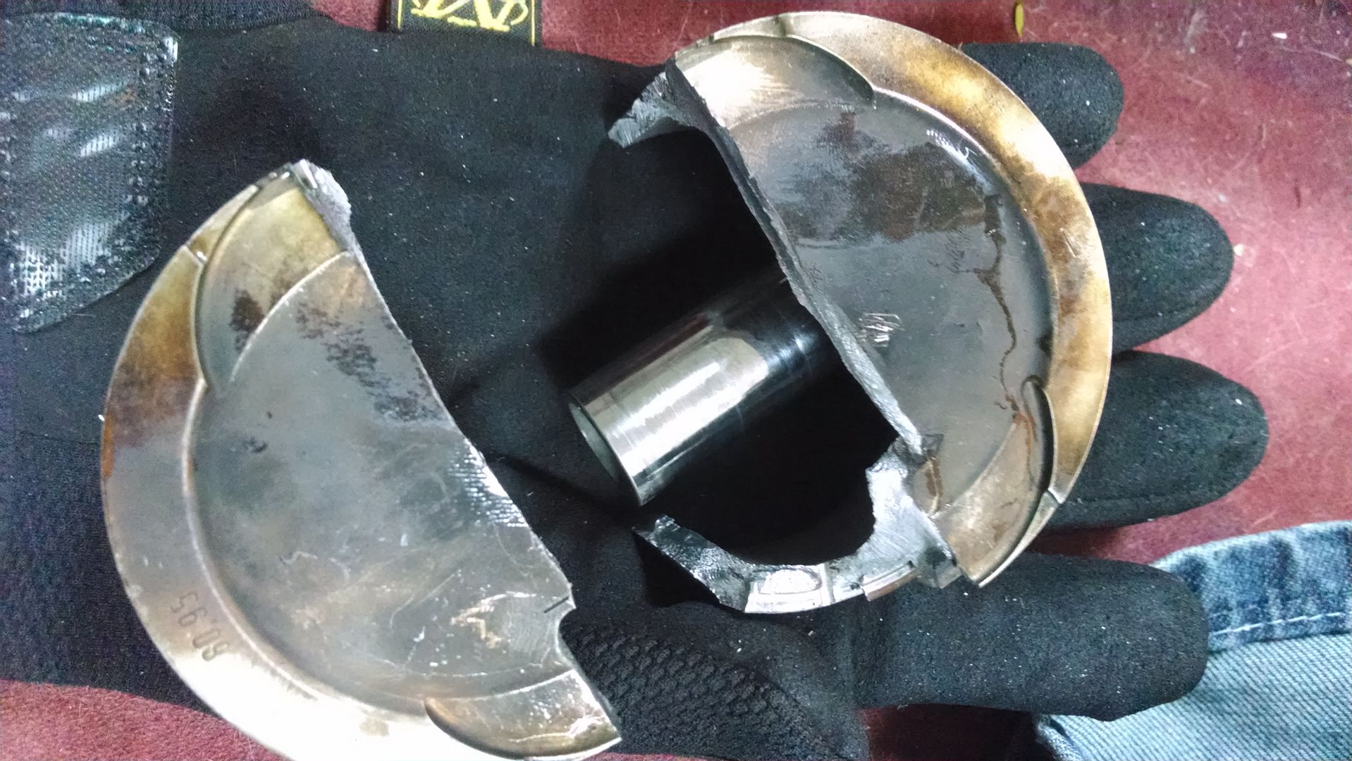

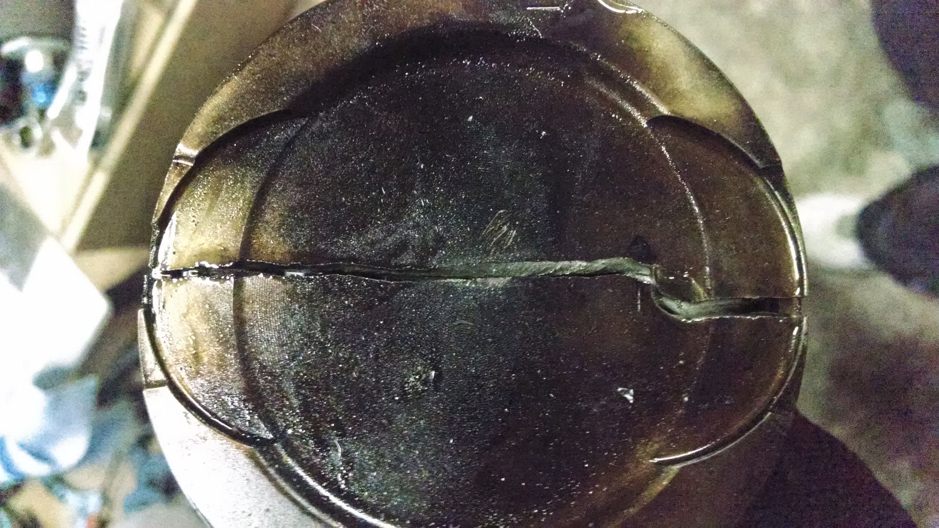

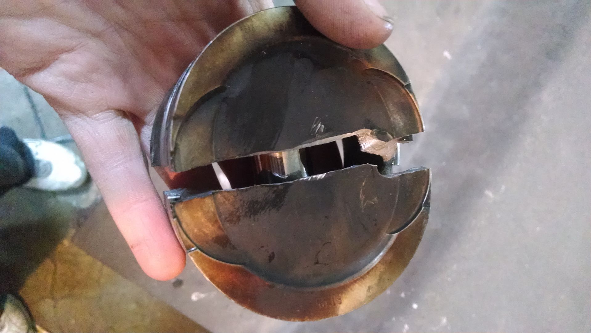

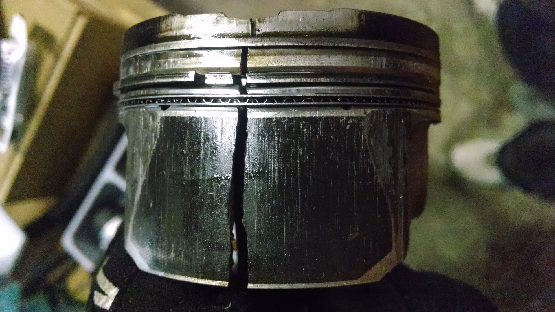

    Well this is what I found when I pulled the piston out...
    Totally cracked in half. Held together by the rings lol.

    What are you attributing the cracked piston to?
    My first inclination would be det.

    Quote Originally Posted by phila_dot View Post
    It's not detonation. E85 doesn't detonate.
    Weak piston from contact with a valve in its past life + stupid high cylinder pressure from muchos power = breakage.

    But 4032 pistons just can't take power this high. Simple as that.
    2618 pistons or go home.

    Previous life left a mark...
    Having a high resistance to detonation isn't exactly the same thing....
    Do you check every tank for ethanol content? I know it can vary wildly.

    Quote Originally Posted by ddillenger View Post
    Yepp. Checked often. Spot on 85%.
    And trust me you'll break pistons most of thr time from pure cylinder pressure before you detonate on E. That guy had "knock" after the piston broke though lol

    The simple fact is anything over 600wtq on stock pistons or stock block is playing with fire...
