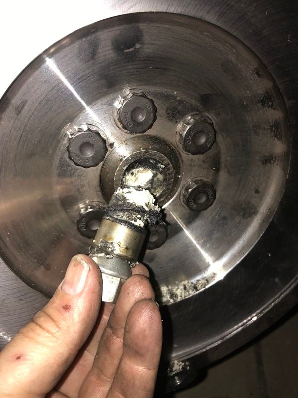

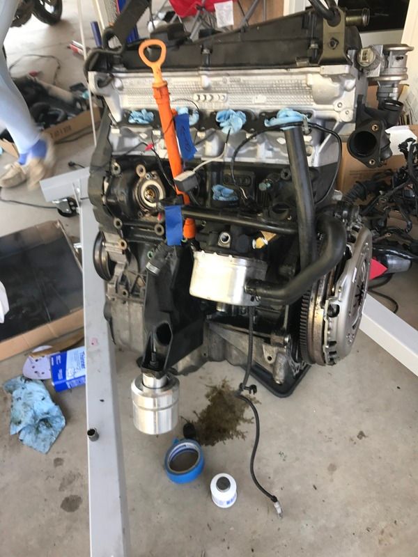

    Well finally got settled in my new home in California. I just pulled my engine because my clutch was slipping. This is what I found. What do you all think of this?

    Worn down to a rivet, or FOD. What disc is that?

    FX350

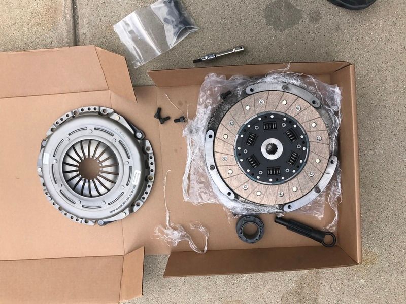

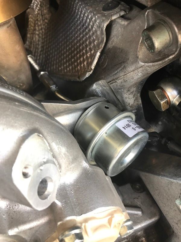

    Things I have been up to. Incoming picture bomb.

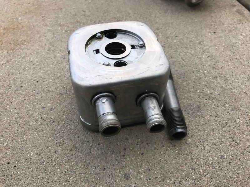

    My FX350 died... started slipping really bad. So I upgraded to a Ringer Racing Stage 3 clutch. One side is organic and the other side is sintered metal. This should hold much better than my old FX350.
    My pilot bearing got damaged while trying to install the engine to the transmission so I had to replace it. I used the old bread technique. Basically shove wonderbread into the bearing hole and pound it in with a hammer and a bolt. Keep on adding bread till it pushes the bearing out. Worked like a charm..
    I then installed a 2.7 oil cooler onto my 1.8t. Should help keep temps down.
    The plugs for my injectors were all sorts of brittle and messed up. Caused a horrible misfire. Just like if my coils were going bad. So be sure to check yours too. Picked up a set of these from Ebay and soldered them in. Plugs good to go. Guess this is just part of owning an older car.

    Didn't know a 2.7T oil cooler was so similar, and bigger. Seems quite intriguing... my oil temps like to hang out really high, even contemplating replacing my radiator just to improve the cooling system's efficiency. Also my coolant temps got a bit high on the way to Wuste last year doing 80mph up some of the hills.

    Quote Originally Posted by MetalMan View Post
    How high are you talking? Above 250?

    Quote Originally Posted by Believer View Post
    I've seen it above 250 (maybe even past 275), but normally it likes to sit around 225. Have heard that oil temps on these cars sometimes are higher with Rotella T6 though.

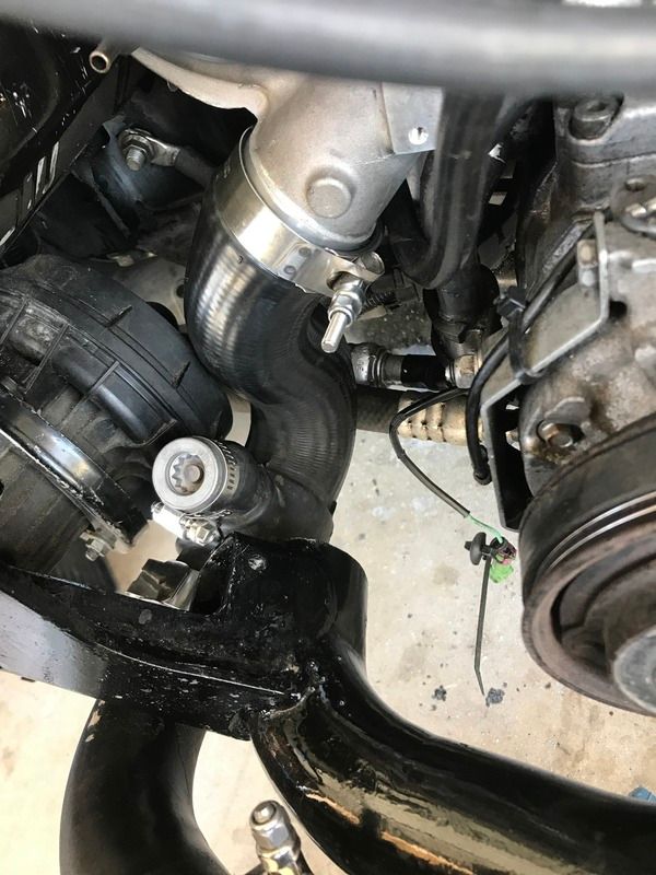

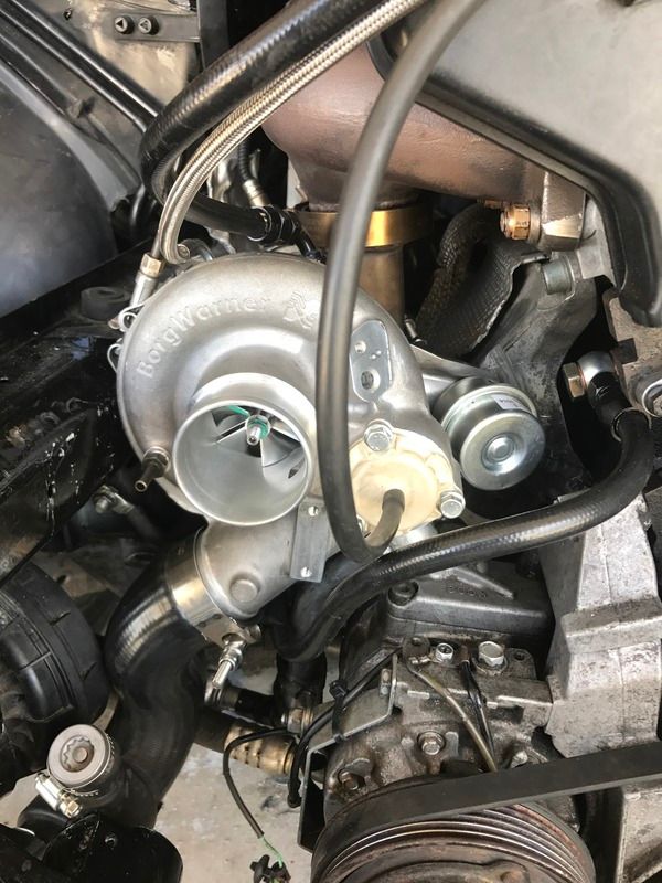

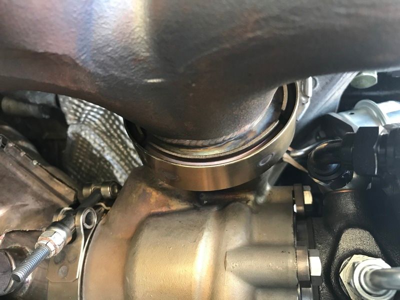

    I got everything installed and fired up only to find an exhaust leak. Turns out I needed to grind down a little more on the B7 engine mount to clear the wastegate. It was barely touching and kept the exhaust from sealing perfect
    So I had to grind down and make it like this.
    Then I decided to change my hot side FMIC intercooler setup. I cut down the stock hose and cut off the inlets for the stock crossover pipe to make room. I also knocked off all the rust and Pour15 it to make it all shiny. I am super excited to make this work. I am trying to make this whole thing look like it came from the factory this way. Old school we use to call it OEM+.

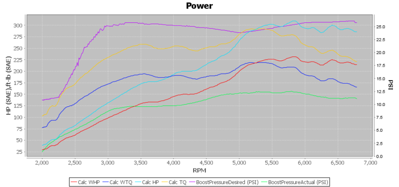

    Drove my Avant for the first time tonight in a LONG LONG TIME. Did some logging with Mirza Mrkulic and got the cars initial map done. Need to try to figure out why my N75 is not working right. Thanks Mirza for working so late getting me going. Basic map, no timing, min boost and fuel trims still need work. But not to shabby. More to come.

    I know the tune is not there yet, but why does your desired boost dip at 5k?
    Anyways, love the build and the OEM+ style.

    Thats what we are trying to figure out right now. I am going to rip into the car and look for a vacuum leak. But any suggestions are welcome too
