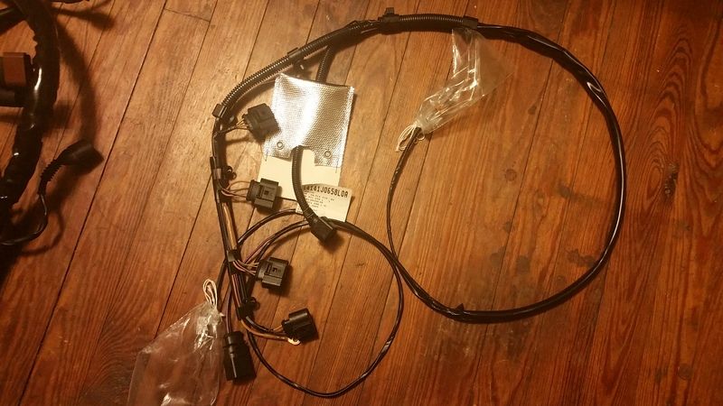

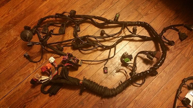

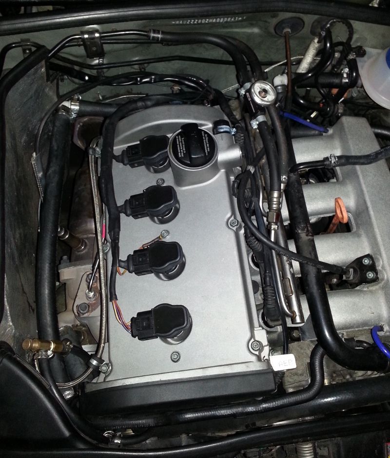

    My current project is tearing into my wiring loom to replace all my coilpack wires. My random misfires got to be really bad finally. I also need to find some replacement wires but how do I search for the right part number? I want to get a few packs of those yellow wire replacement things from VW. I want to replace all my wires around the injectors and the cam position sensor. I also plan to go Meastro soon and wanted to step up to a 750 injector. But which ones are best and are the plugs EV1 or EV14?
    [IMG][/IMG]
    [IMG][/IMG]

    Bosch EV14 750cc injectors are pretty popular, and what I run @ 4bar fuel pressure. My understanding is that they start out as Bosch EV14 550cc injectors, then are precision-drilled to 750cc. But this means they have all the characteristics of the 550cc injectors (good from a tuning perspective) just with more flow.
    2001 Corvette (C5) Z06

    EV1 is stock. I cut mine off and butt connected EV14 connectors with wire leads, then wrapped in cloth tape. Haven't redone my cam sensor section yet, though. All wires besides o2 sensors now on cold side.

    Yeah I might try to reroute onto the cold side. That is a good idea to future proof it. Also after ripping into the loom, I think I am going to but connect it half way through like the way the 034 harness does it. But without the fancy plug. I am going to use marine grade butt connectors that shrink wrap down.
    Speaking of other wires. Do you know of a good source for the yellow repair wires. 10 dollars each at the dealer is way too much.
    Also, I really want one of those passat covers. But I can never find them in the junkyard. What years did they come on?

    I forget the part number for the passat cover. Basedrifter should know it. Otherwise, I would need to search it. Also, not quite sure what yellow things you are referring to?
    With the wires on the cold side, my ignition coils are all cocked weird due to the vc design, since I wanted all my wires pointed on the left side of the car. I hide the way it looks with the coil cover, so all you see is wires coming from underneath.
