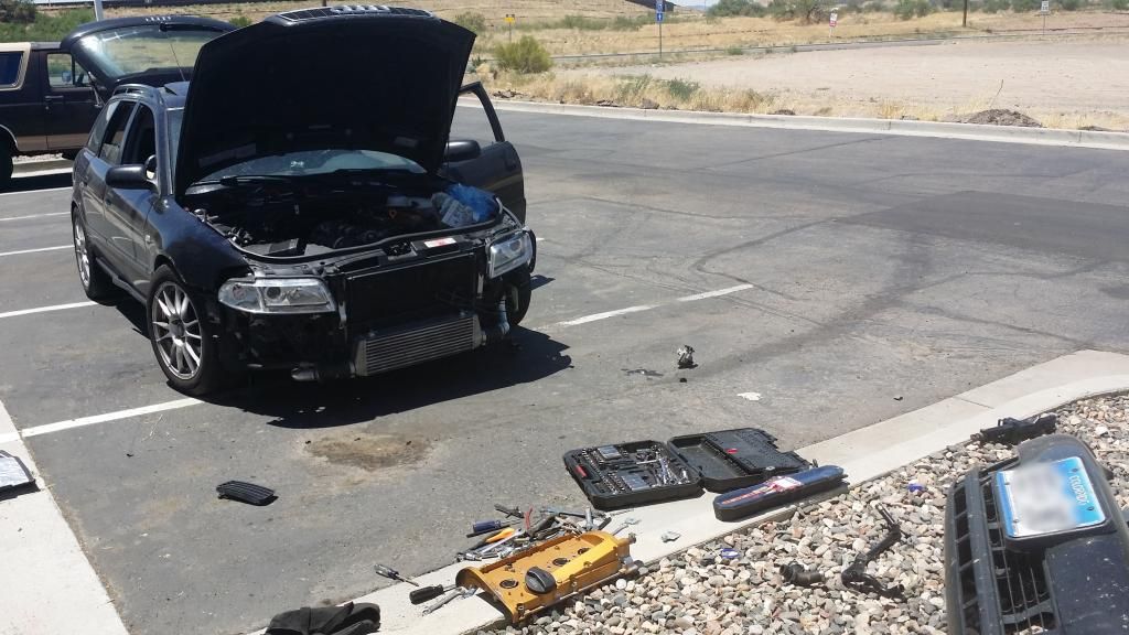

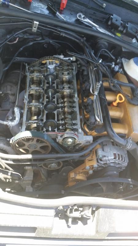

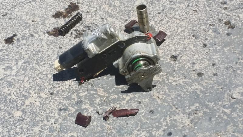

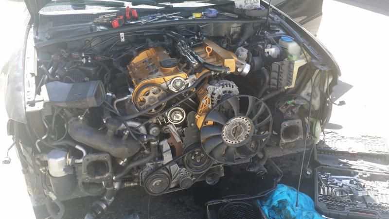

    Well I have now gone through 2 cam chain tensioners in less than 15K miles. Advice to anyone, DO NOT BUY THE CHEAP VERSIONS. I bought the cheap one the first time. It lasted less than 5K miles. I bought the more expensive 400 version and it lasted 10K but then exploded plastic shards all over the inside of my cars engine. Don't try to skim money on a cam chain tensioner, either get a used one if you are poor or buy it new from the dealer. The fun part was this part blew on the road in the middle of nowhere in the desert of Arizona. Lucky me I coasted into a gas station with no functioning bathroom or running tap water. Thank god for the soda fountain. I have to give a big shout out to Mike Hood of Ringer Racing for helping me out. He lives down in Phoenix and he helped me out over the phone as to where get things and other stuff.
    But I did get to try the best indian mutton fry bread taco a few hours before that. Bought it on the reservations just outside of the 4 corners. It was so good I had to get a 2nd one for the road.
    The car is up and running now, but all said and done this cost me about 1500 to deal with. Should have bought the dealer part the first time around.
    On a happier note, I love my new OZ racing rims and I just tinted the car all the way around.

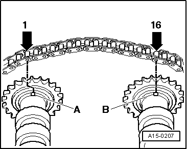

    Oh and one more thing... I did not have my bently with me so I had to search the internet for a how to. I stumbled upon this.
    http://www.passatworld.com/forums/61...tensioner.html
    Which I am sure many people have seen before. The instructions omit on VERY important part. The instructions say count 16 teeth... except VW/Audi in their A-holeness made that 16 teeth from a jog in possition. Which makes it 16/17 teeth-ish. So I counted 16 teeth from common sense vertical only to figure out that it was not the case. Which I should have know because I have done this WAY too many times. But hey, heat stroke in the dessert sucks.

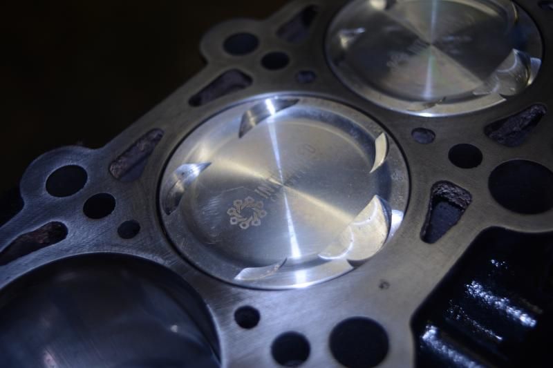

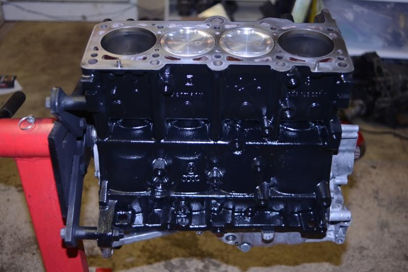

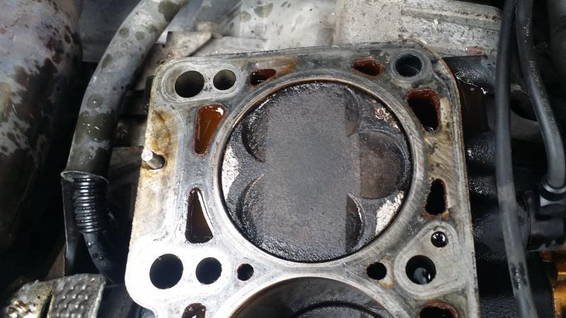

    GREAT NEWS!!!! I have sourced a new block to replace my old block. 2.0 block will find its home in the Avant. My old block met its death due to the CCT explosion. I will take it apart later and inspect. Most likely spun a bearing all relating to that stupid chinese part. I am not sure about what I am going to do with the old block. For sure I am going to take it out and take it apart to inspect it. This is what it looked like when I pulled the head.
    [IMG][/IMG]
    I am planning on taking the 2.0 block apart and balancing it. I also plan to put my ARP main bolts and crank bolt in addition to the new 4 bolt billet crank pulley from IE. As to turbo upgrade. I am seriously considering upgrading to an HTA 2868 elim. Definately more to come. Sadly the car is in Colorado and I am in Baltimore. So car fun will have to wait a few months.
    [IMG][/IMG]

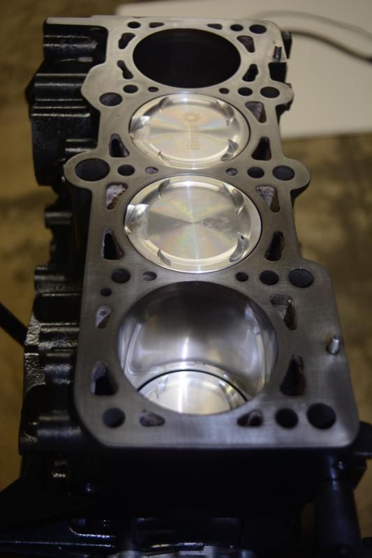

    I have been busy. I just got done dropping this into the car. I have now gone 2.0
    I am also debating getting a IE intake for my car too. I want to get it with a 70mm throttle body. Does anyone have some opinion about those two items. I also have to get the head done. I just bolted everything back together and the engine did not sound right. I am thinking I might have slightly bent a valve when my engine blew. Regardless, it was good to start the old girl up. She has not been running for over a year now.

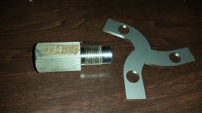

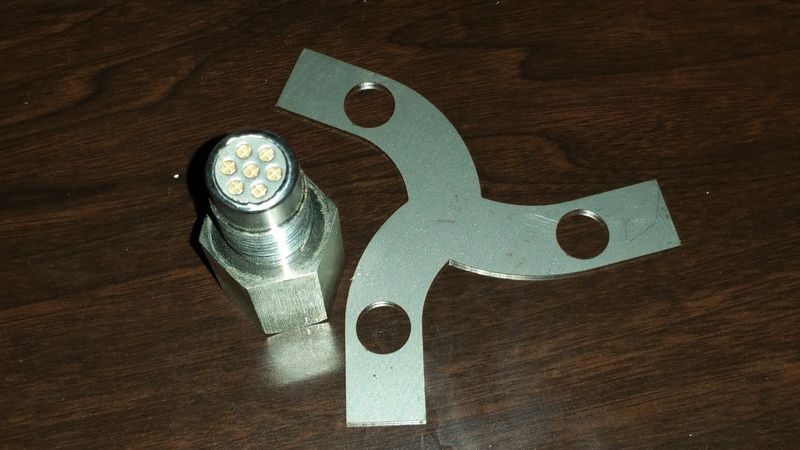

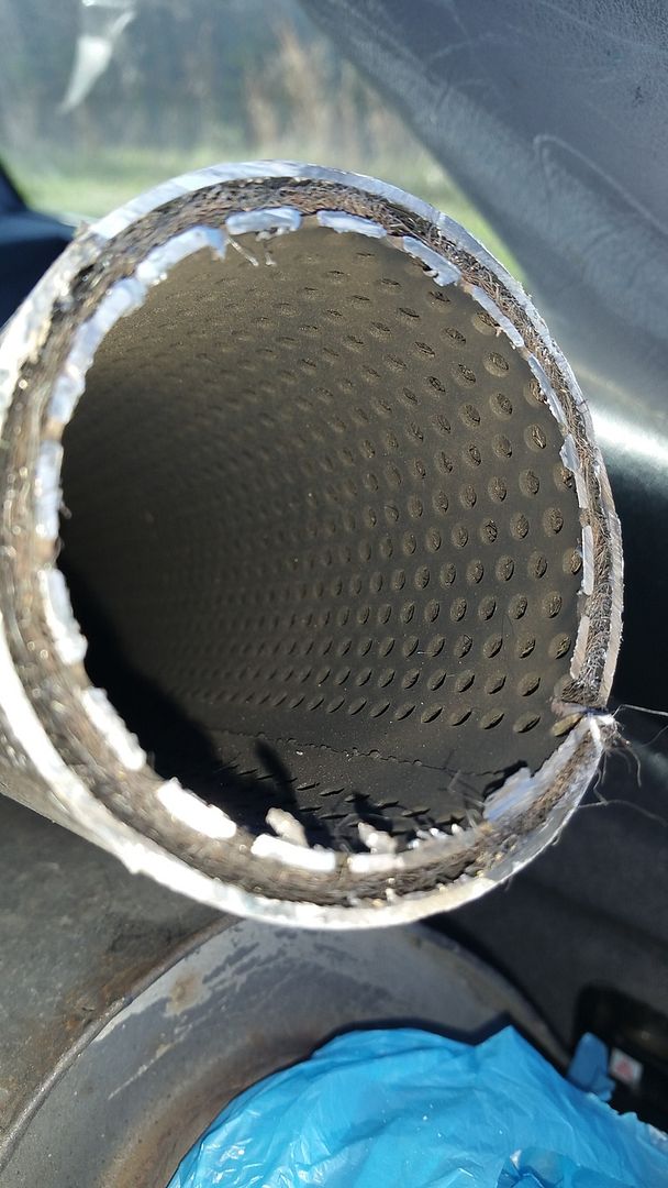

    I picked up a full Millteck exhaust from a fellow forum member. We both learned something about Millteck. Apparently the B5 A4 exhaust is NOT a 2.75 in exhaust. the outer diameter is 2.75 but the INNER DIAMETER is 2.5 even in the sections where the pipes look 2.75. This is why Milltecks have a 2.5 in down pipe. When I bought the exhaust it was welded together at all the joints so it was way too long to get into the car. So we had to cut it. I figured I would re weld it later. Apparently they whole exhaust system (at least where I cut the exhaust is baffled). Check it out.
    I also picked up this awesome O2 spacer from 034 Motorsports. Check it out. It has a mini CAT inside the spacer. No more CEL :) Plus I picked up a new bolt holder for my high flow manifold on my Elim setup. I highly recommend these. Keeps the bolts from backing out.

    Interesting find with the baffled pipes. I have a Miltek exhaust on my B6, and I didn't see any baffled pipe like that between the downpipe and y pipe as well as between the y pipe and the mufflers. It might be something with the B5 exhaust only?
    Where did you cut the exhaust?

    I cut the exhaust in the midpipe just before the resonator. I will take a pick of the whole system tomorrow.

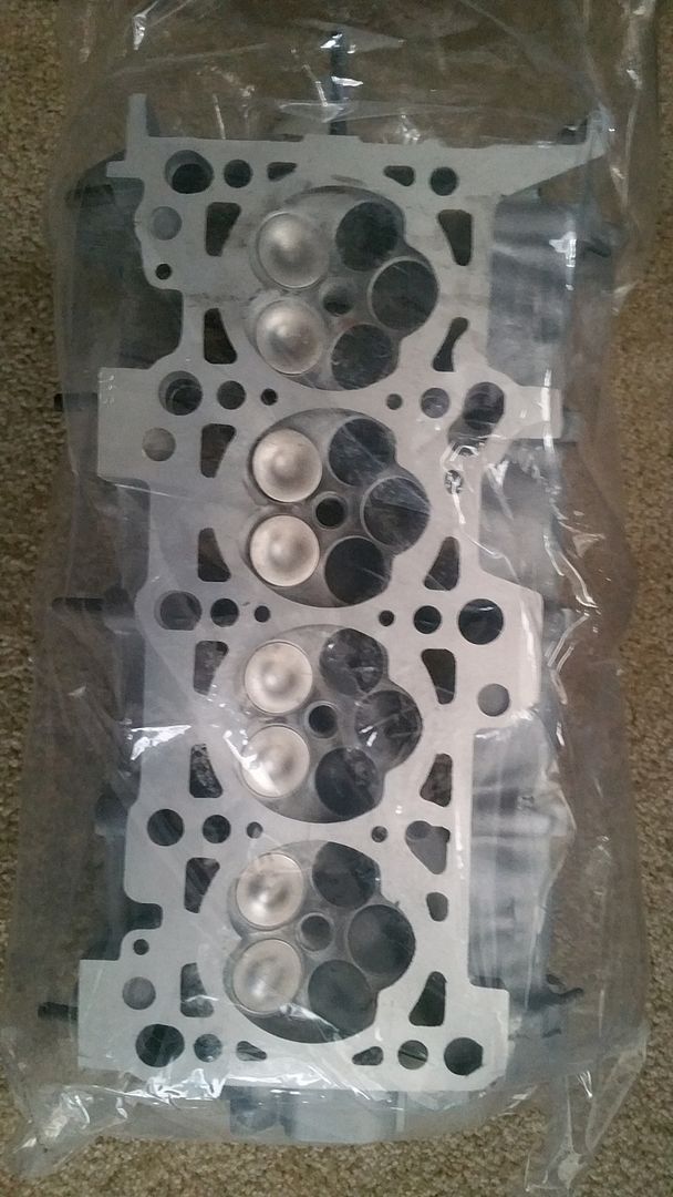

    My head is currently off at the machine shop getting ALL of my intake valve replaced. Apparently when the Cam Chain Tensioner went, it did a ton of damage. Warning to all... NEVER use the cheap Chinese cam chain tensioners. Reuse stock with new pads.
    So since I am waiting on that to be redone, my mind has been running. Should I upgrade the turbo? I have a GTRS Elim and I really liked it. But now I want to try a custom eliminator setup. I am debating either getting a GTX2863r or a GTX2867r. I like my eliminator setup because of the sleeper factor. Plus I might one day have to move to California so I want to keep it looking as stock as possible. If I upgrade out of the an Eliminator setup then it will be to a EFR or sorts. But I don't know if I want to invest that money for not that huge of a difference. (cost benefit analysis).
    I am also debating getting the IE intake manifold with the 70mm throttle body. I am currently running a 630 uni tune. Is it possible to use the 70mm with that? Also is it a waste to get the intake if I don't have cams yet?

    Got my head back from the shop 12 new super tech valves later.
    Apparently my keyway also nearly sheered off. So I need to get a new cam gear before I put it all back together.
    Sadly the weather in MD has taken a huge dip in temp. last week it was great. This week freezing with snow on the way. I am working outside on the street under a street lamp post not the warmest of options. But I will get it done, but I am holding out for a litter better temps. It always warms up after a big cold dip.
