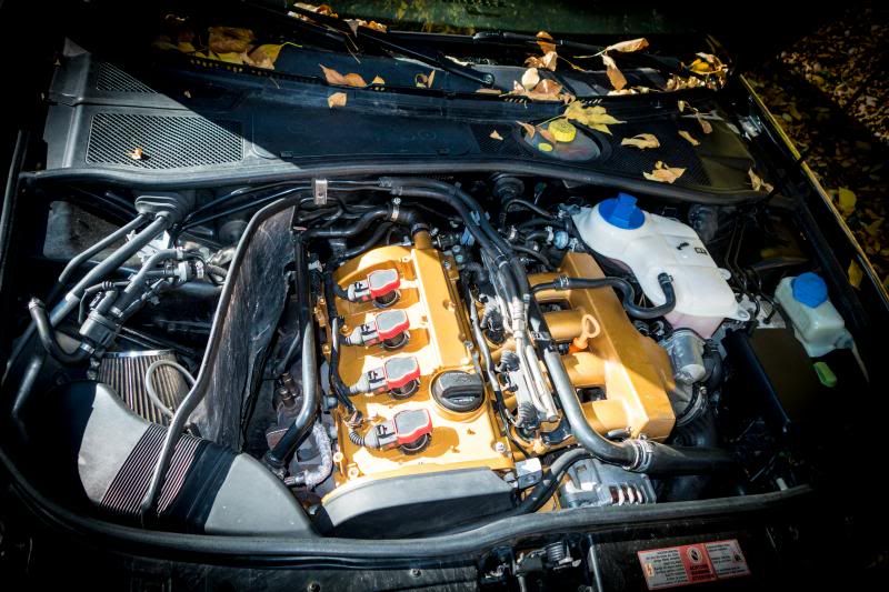

    Any picture of the engine bay? I have a feeling the black bay with those gold accents would look awesome.
  21. #101
    Veteran Member Four Rings nynoah's Avatar
    Jan 16 2006
    9725
    01.5 A4 avant Past cars: 95 S6, 85 Golf II VR6, 2 sciroccos, 92 Corrado VR6, 86 Euro BMW 535 Alpina
    LA CA

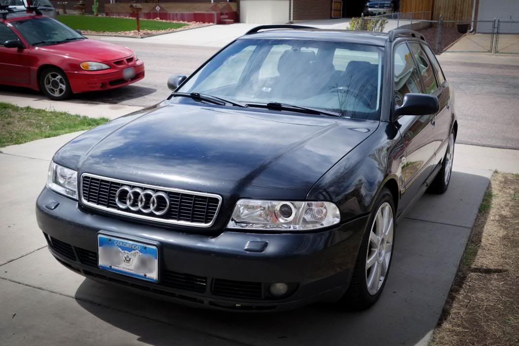

    Here are some recent pics... sorry about the mess, no time to wash and wax right now.

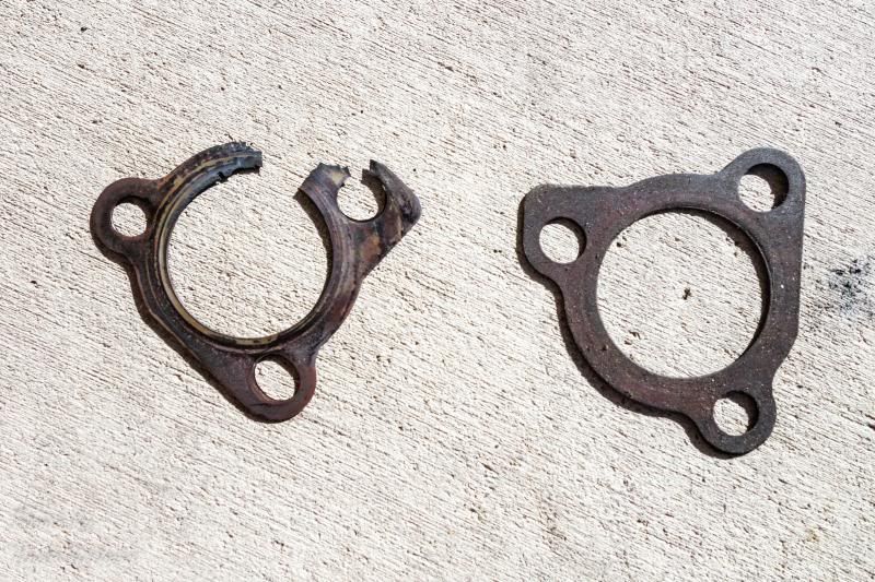

    Well I am pretty sure that my Franken Turbo manifold has cracked.

    I am not sure what the paint is. I know its engine paint I bought at an autoparts store. Its a metalic gold of sorts. If I find the can, I will post it up.
    Good news calamity averted. Seems the gasket between the manifold and the turbo was jacked. Time to throw the old 150K one back in. After market parts.... sigh. I have bought too many parts twice. Don't EVER buy after market rear coolant flanges or thermostat flanges. Ask me how I know... just spend the extra 20 bucks and buy from the dealer.

    Got the gasket changed out and that fixed my problem. I just went right down to the VW dealer and bought a stock gasket. Hopefully it lasts longer than the aftermarket one that lasted 1 year.

    After dealing with a lot of gasket problems, just go what is tried and proven. OEM for eliminator. Even cometic is junk.

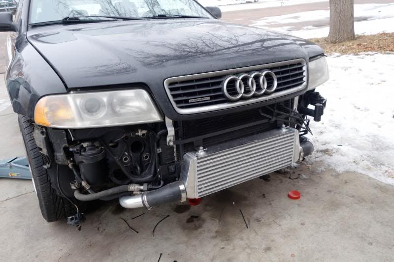

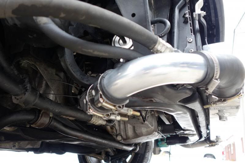

    Thought I would update this with what I did recently (2 weeks ago). I ordered the pipe kit from CXRacing for my 2001 A4 1.8t. They messed up and sent me the whole intercooler setup. Score for me. I already own the Treadstone 1.8T intercooler that Seerlah (Mitch) helped sheppard into being. Thanks Mitch for taking initiative and helping the community by getting that core created.
    Since I received the full CXRacing FMIC setup, I figured I might as well give it a try. Besides its winter and the ambient temp is pretty low. Its not like I am trying to cool stuff with 100 deg heat. My impressions of the CXRacing kit is pretty good. For the price point, it is an amazing deal. I would have no problem recommending it to anyone with a Franken Turbo or K04. Its built well, uses decent internal ribbing cooling, the aluminum tubes were welded well and fit, the hose clamps are top notch quality too.
    In order to mount this system to my car, I had to cut it and mod it. I am running a GTRS turbo and the hot side is differently located than a Ko3 borg warner. I had to cut about 1.5 inches out of the hot side and add a silicon bridge to it to make it work. I cut that from some of the older tubing which was removed. In the future I plan to buy some more replacement 2in and 2.5 in tubing with a flex hump to make it even better. Plus I need 2 more good clamps. For now the whole system is working great. I plan to pull the CXRacing core and use the piping kit parts to mount up to the Treadstone core. Of course I will have to go to town and cut the stock bumper core up to fit that. I will post pics of that later. For now this is what I did. I also spaced out the bumper shocks about 3/8 of an inch with washers to fit the CXRacing core. Notice how I wrapped those washers in tape. That little trick saved some stress.

    Looks pretty nice. My racetechbpipes had to be cut the same way. Think you could have gone above the ac lines?

    With those hotside pipes, there is no way to go above the AC lines as they come. It is debatable if I can in the future using a flex joint hump hose and other tricks. I will have to go over them when I mount my Treadstone. So we shall see in 3 months or so. I have to buy this and a 2.5 inch and see.

    I tend to use an angle grinder to cut plastic. Mmmmmm burning plastic smell. Its crude, but it gets the job done. I had to shave a ton from the lower valence on the bumper to get the CXRacing kit to mount up. I was on a time schedule and I knew the Treadstone would need more time than I had to give. Weather came in fast. Sadly even the CXRacing kit took more time than anticipated making it fit and I ended up finishing it all the next day after the temp dropped a ton and just before the snow came barreling in.

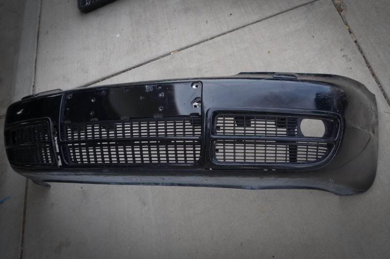

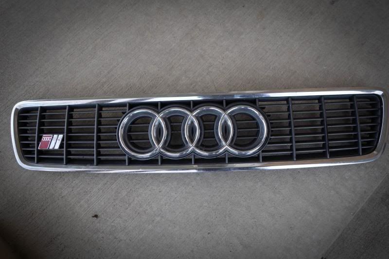

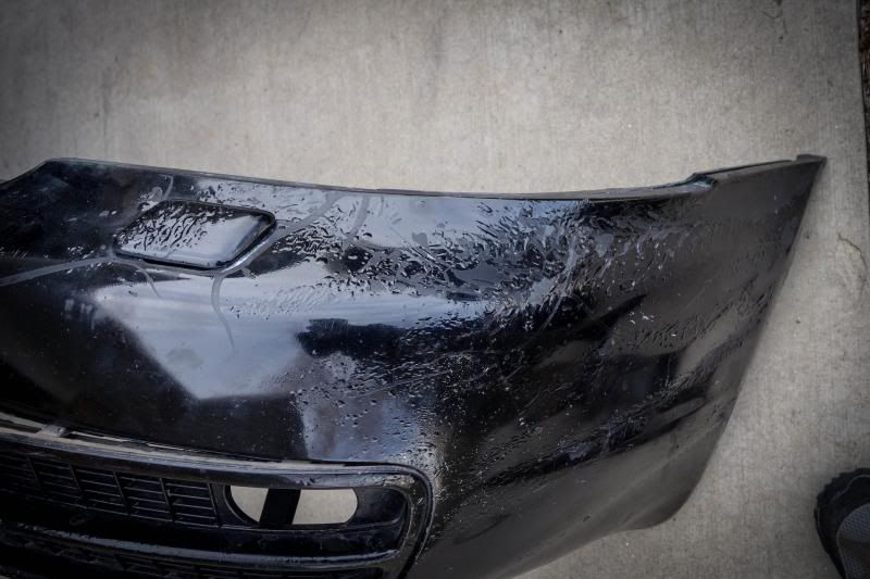

    Latest car work involves many new additions to the car. I just picked up some smoked chrome gauge rings from Ebay.
    Changed out the front brake pads and rotors. No more wharped pulsation.
    I then recieved my new Depo headlight bodies and had to make new brackets for my Mirimoto Mini dual xenon projector assemblies (can not recommend enough).
    I was then surfing the local craigslist when this popped up. The paint is all sorts of F'ed up. Guy claims the car baked in the Arizona sun for 2 years before he started to part it out. I am sanding off all the paint. Lots or work to be done. But I have an S4 bumper on the way.
    I also picked up an S4 grill which i painted flat black and mounted to the car.
