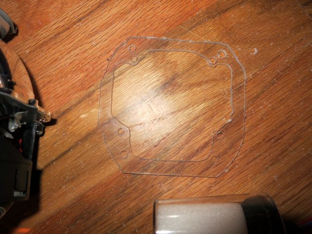

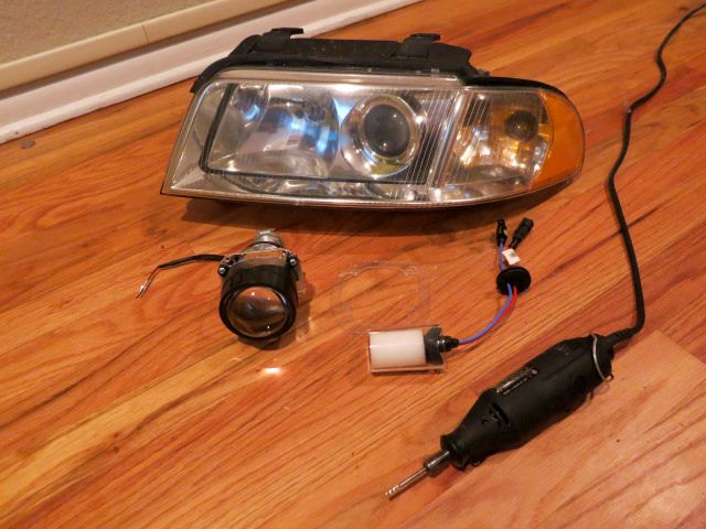

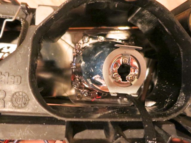

    Just about finished up with mounting my new Morimoto Mini H1 replacements for my burnt out OEM xenons. The bowls on my stock units had some nice scorch marks on them. Hopefully these will be much brighter. I am also looking forward to the face that they are dual high beam low beam xenon units. I had to dremel out the frames on them. That was kinda a pain. Mainly because they were not labeled right. I think the guy got the Depo and the Veleo mixed up. But I made it work so what ever. I am glad that he posted them so I would have even a clue it was possible. So enjoy the pictures.
    Thanks for the comments too. I enjoy reading the replies. I dropped off the pistons to the shop today. Hopefully they will be done soon.

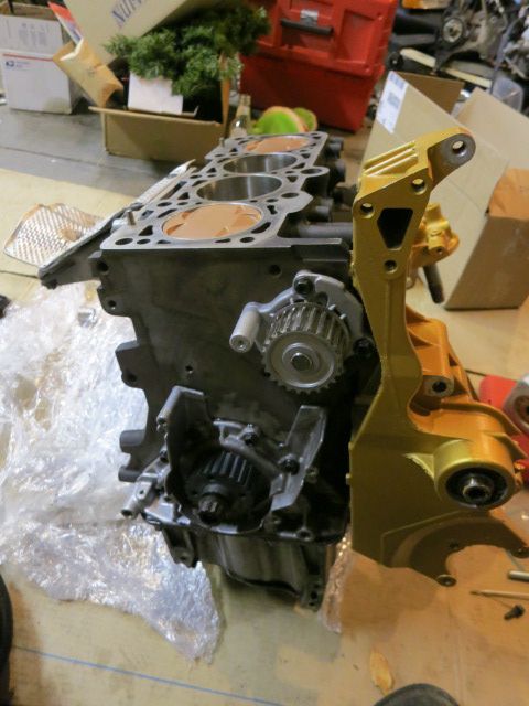

    Alright got it back, its on like Donkey Kong. I also ironed out my issues with 3zero3. So I still had them build my bottom end.

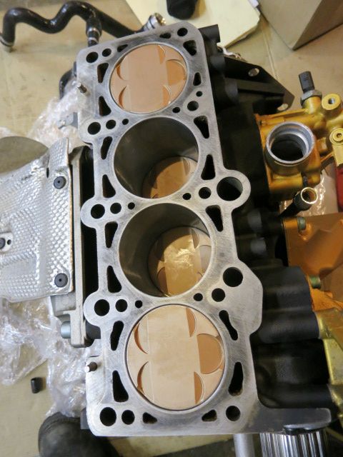

    That looks pretty. But if the block was decked, why does it still have that residue left over from the head gasket? I made mine cleaner than that with the 3m Roloc wheel.
  20. #60
    Established Member Three Rings morzechowski's Avatar
    Jul 20 2011
    78538
    500whp 1.8t, 2500HD Duramax
    Minnesota
    You are right, that block looked barely decked at all. Almost like they charged you for a deck but just ran a 3m wheel over it quick.
    Did you have it fluxed as well?

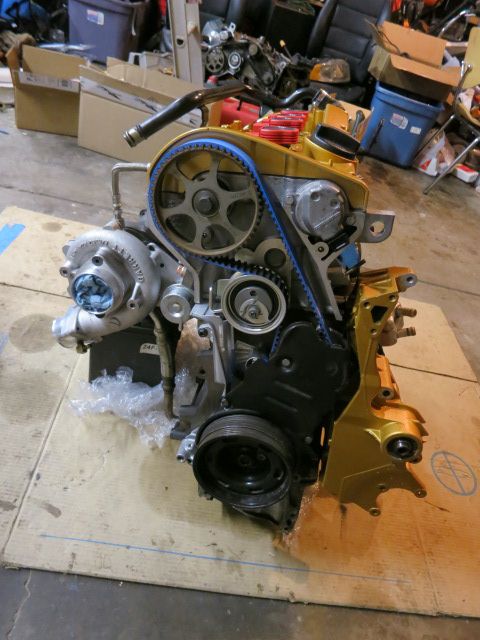

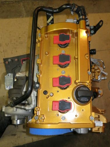

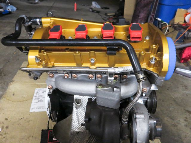

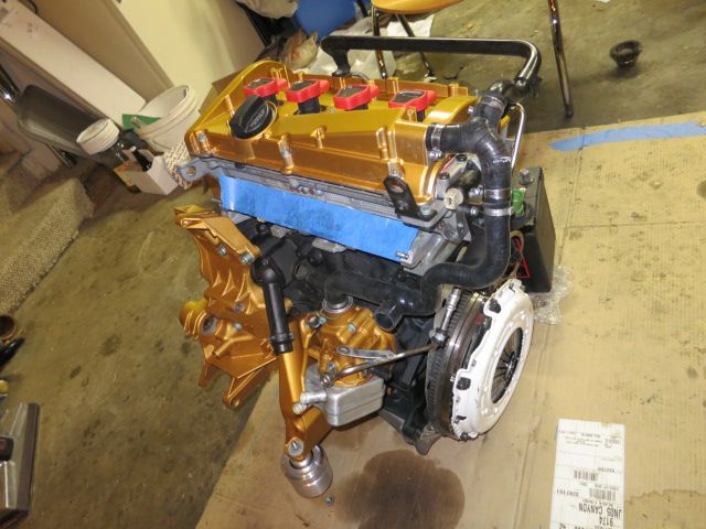

    I did not have the block decked. Hopefully, that will not be an issue, but I hate to take off metal unless there is a reason to take it off. Here is what I was up to today. I got most of the stuff mounted on the engine. I am going to stay up late and mount all the rest including the tranny to the engine and then drop it in early tomorrow. There is snow coming on Tuesday so I want to try to get it in and done tomorrow. Most likely will not happen, but I am going to try. Sadly the car is outside so I have to work during windows of good weather. I have a garage, but did not want to tie that up. This project was supposed to be done months ago before the snow. But... we all know how that goes.
    Let me tell you, that Franken Turbo Mani is a pain in the butt to get mounted up. Thankfully I had some of the 10mm manifold nuts from 034 motorsport. I don't know how anyone can mount a stock mount high flow mani with the 12mm heads. Its impossible. Even with the 10mm, I had to grind down a set of crows feet to get in there. In addition to using a set of swivel tip 3/8 extensions from sears. Not the jointed ones, but the wobble version.
    Here are some pictures of where it stands now.

    Quote Originally Posted by morzechowski View Post
    Also Morzechowski, your head had an issue I am not sure if you were aware of. One of the holes for the head bolt was tight. Hopefully that is something that has always been there and not an issue from when you blew your motor. But I drilled it out just a little and the ARP headbolts spun freely. It was around between the first and the second piston from the front.

    lovein the color and in the spring I have about the same setup going in. GTRS CM ect, I am waiting out the cold my stock clutch is slipping.
    Are you going to be using a High flow fuel pump ? I have one that was given to me and want to know if its needed on a GTRS setup?
    looks great good work!

    Alright I figured out the problem. I was trying to use the left over bolts from my suspension as the engine to tranny bolts. I got to two confused. Stupid me... I guess I was just really tired after wroking from sun up to sun down yesterday. Well next adventure. Find the missing bolts for the tranny to the engine. Time to rip apart the garage again. Sigh...

    sorry if I missed it but are you going to run a catch can ?

    No catch can for now. I am just going to be using the regular pancake valve setup with the GTRS. In the future, I might get a single inlet catch can from IE. I will keep all the other breather stuff because I upgraded to the 034 version with the billet catch valve.
    http://www.intengineering.com/integr...llet-catch-can

    yeah I dont have that, I plan on going with catch can, just been looking around what people use/ recommend/ suggest ?
