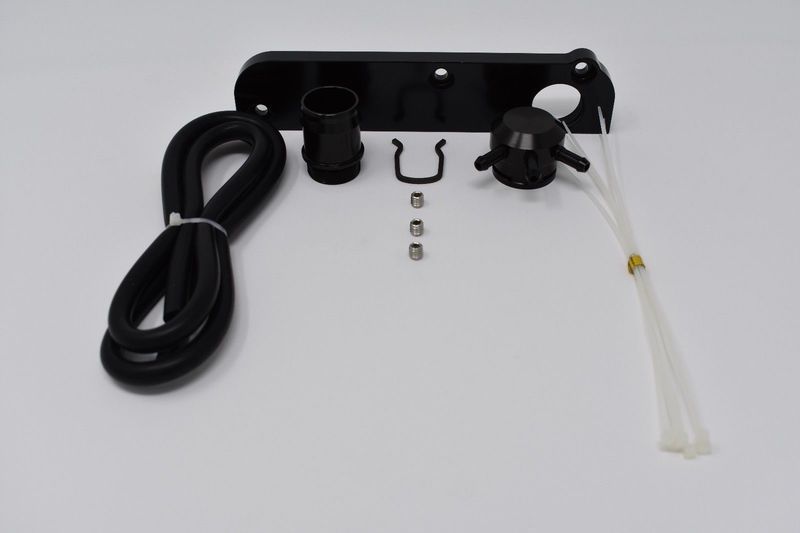

    Will this block off plate work for this application?
    https://www.ebay.com/itm/VW-Audi-PCV...VapK~z&vxp=mtr
