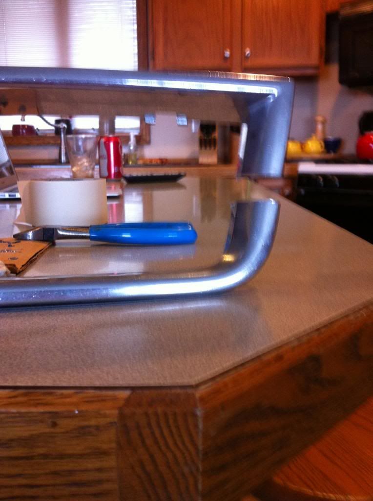

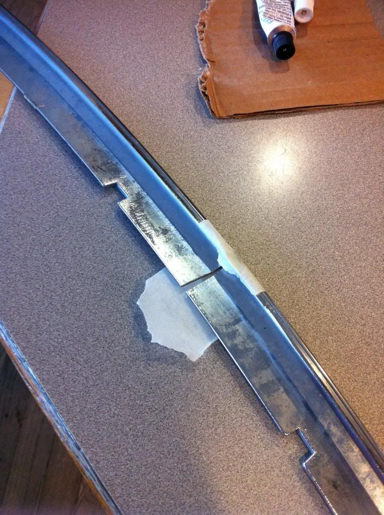

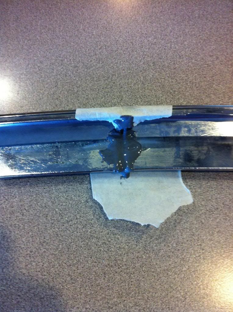

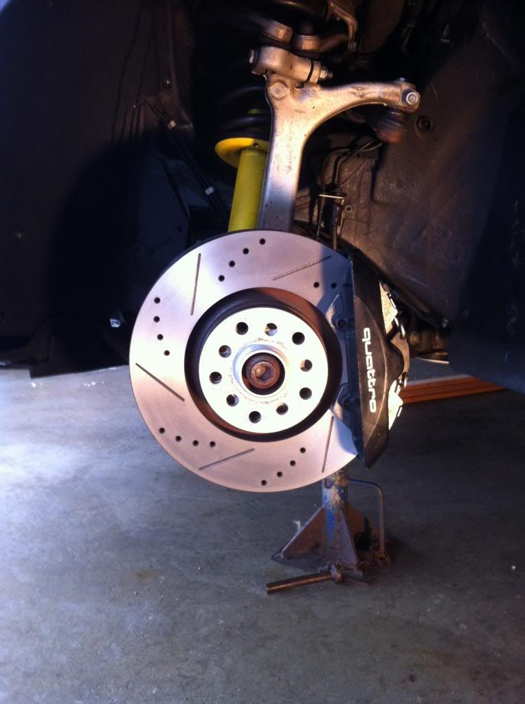

    So I was having a little vibration with the new brakes and figured it might be the rotors so I had them turned, cost me around 15 dollars per rotor and this is after I picked up the rotors from getting turned, they look new and feel brand new, no more vibration or pulsing. God I love these HP2's now. Well worth the money and there is no sight in pulsing or vibration
    I also got bored today and started to make my homemade center grille for my ultra sport bumper using my stock center grille and a DIY I found online. Here is just the beginning with fusing the botom halfs together with some plastic weld and now its time for some fitments test. it will be awhile until its finished but its a work is progress
    Making the grille wider
    It really looks good and will look almost identical to the stock one you would buy from the store

    hey, hint on the grill.
    tuck something up into the lips of the grille and epoxy it in place as well. its pretty brittle with out some kind of support.
    i used a piece of aluminum flat stock, but even that started to split.

    Yeah I did, The picture was just a little base to test everything out, it now has some support and then another 2 layers of plastic weld

    Wow those brakes look amazing!

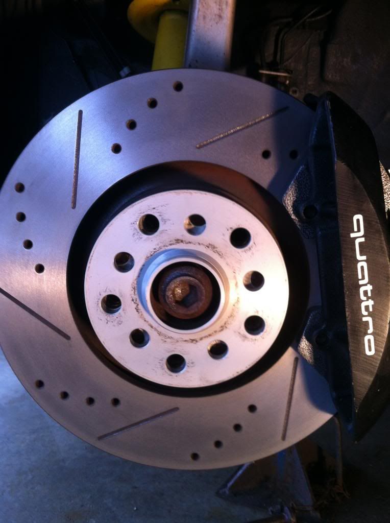

    And did you make the stencil yourself?
    Thanks man I love the bigger brakes and the improvement, as for the decal I had a local guy make me a set. cost was 5 bucks, cant go wrong

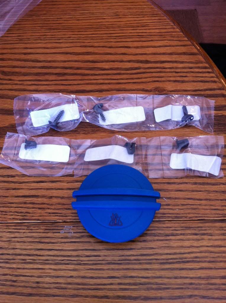

    So took some pictures of what came in my ECS package:
    As you can see on the table I got new center caps for my new wheels
    And then I got this for a coolant flush in the spring when the weather gets warm.
    Along with that I got a new cap and then clips
