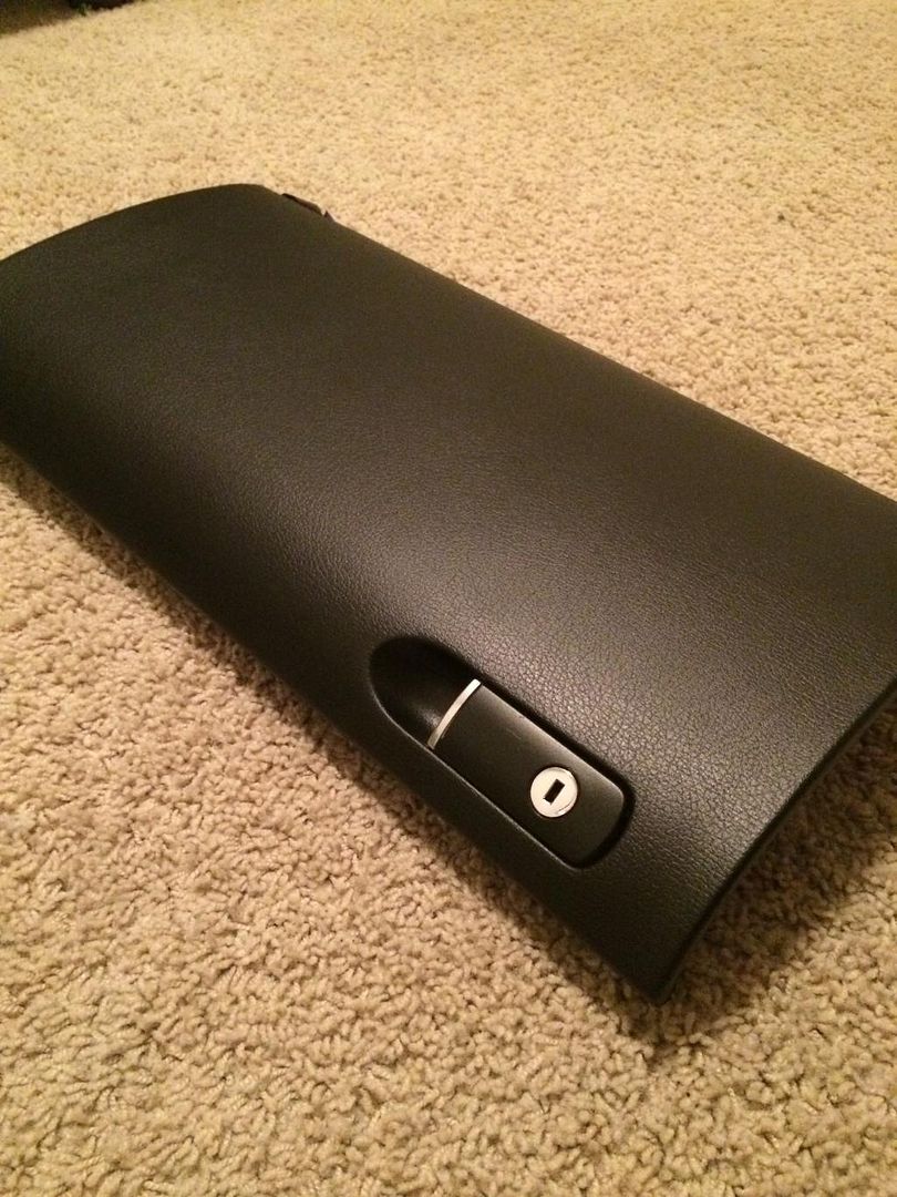

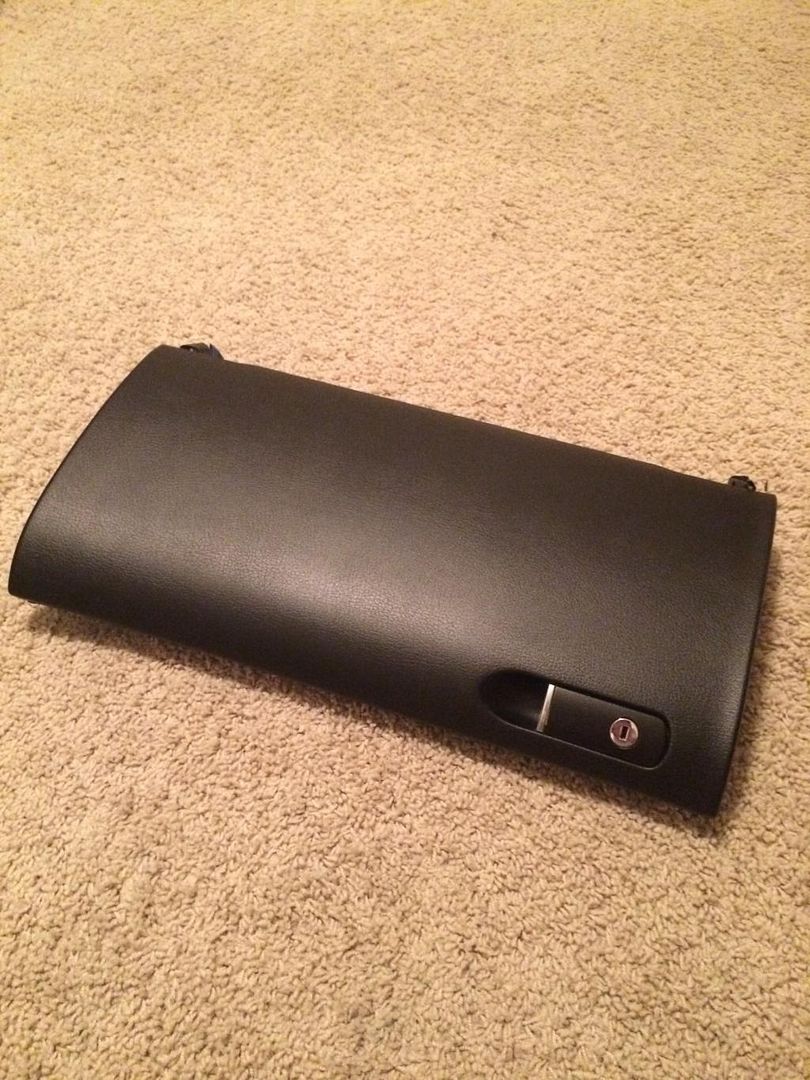

    So instead of paying the money for a glove box cover as they usually just sell the full unit for quiet a lot of money I decided to try some paint. I went to the local auto store after work and picked up some wax and grease remover, adhesion promoter, and some flat black interior trim paint. I took the cover off the glove box and masked it all up. went with 3 coats or promoter and 3 coats of paint. I have yet to install it as I want to make sure its fully dry before I mess with it. Over all I am really impressed with how well it matches. it was very easy to paint and did not take long at all. It beats shelling out all the money for a used one somewhere. Here are some pictures of the process and I will get some more when its installed tomorrow.
    Sorry for the iphone pictures
    Masking pulled off:
    200k daily tank
    My Build Thread
    "Like a fat chick in Yoga Pants...Mad stretch "

    Wow, that came out really good.
  35. #475
    Dec 28 2006
    14483
    '13 A5, '24 Tiguan SEL R-Line
    Western Maryland
    Outstanding!! Please let us know how well it blends in once installed. At some point in the future I need to refinish my center console. I have been pretty happy with the Krylon Camo Black for minor touch-up but it's maybe a 90% match. The Dupli-Color looks really nice
    Thank you, I am really impressed with it.
    I will be sure to get some pictures of it installed, I put it next to the center console when I got done and it was super close. I used the camo paint when I peeling window switches and on my headlight switch, When I got the S4 door cards they came with new switches
    X2 wayy better than I was thinking after reading the list of supplies
    +2
    I was skeptical, dang that looks good!

    Quote Originally Posted by DiertyEuroSpec View Post
    haha I was thinking the same thing then kept looking at pictures and videos and decided what the hell if its half ass I will have to buy a new one, if I leave it how it was I need to buy a new one, so after doing this I am very happy and I am money ahead. I will make sure to get nice pictures tomorrow morning. Its funny how it looks so textured in one of the pictures. The prep work I believe is what made it look so good

    That glove box looks great. I can't wait to see how well it matches. I'm thinking of doing the b7 console in black if I don't revert to the black b6.
    The interior swap looks awesome!!!! I'm in the process of mine and this has been good mentoring reading through this.
