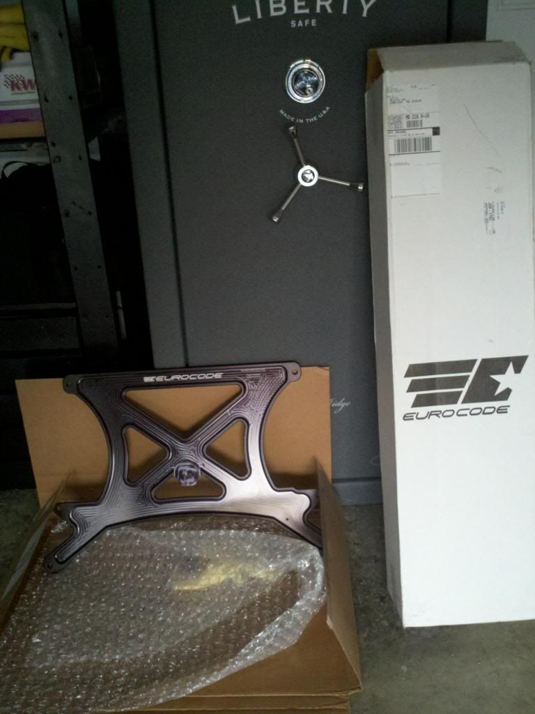

    Got my Eurocode goodies from the group buy in. Since I don't have the needed tools to do any of the work and I don't trust myself not to screw somethings up I wanted to get them installed with a good indie shop. Called up NGP in Aberdeen, MD. Well the dude on the phone quoted me something like $734ish dollars for install on the Alu Kreuz, front and rear sways (no end links, bars only) and alignment. Am I missing something. He said 2 hours for the Alu Kreuz, 2 hours for front sway b/c they have to drop the sub-frame, and 1 hours for the rear sway, then time for a new alignment. Are those times right? I'm no mechanic but the eurocode install guide seemed pretty straight forward and made no mention of dropping subframes. Looked more like 1 hour per sway and 30 min for Alu kreuz, not even sure of a new alignment is needed or just a good idea.

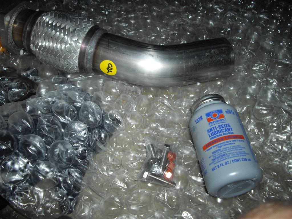

    So lets see. what has happened since my last updates to this. Well a couple things. Mostly good, one BAD! for which I'm still pissed at the Maryland State Police for. So that story is hilarious actually. Was on my home from work about 2 months ago on a friday. It's a good 1.5 hour commute for me so I usually take the 5 just on Fridays cause it's a half day (dentists schedule). Leaving my way out of Salisbury, MD and have to go through some shadier parts of town, but that's just where the main road takes you. Cop pulls out behind me. I'm not worried cause I'm not speeding or anything at all, but me being me I kept my eye on him. Well he pulls me and simply says, "You know your tint is illegals!". I grunt a "nuh uh", while thinking, 'of course it is ass clown, but I bet you didn't think there'd be a white guy with a suit on in it!' Give's some run around, doesn't even check my tint but gives me a work order. So I had to pull my 20% and put on MD legal 35%. It's not bad, but it looked so Bruce Wayne before that I tear up sometimes.
    Anyhow, grabs some goodies from Eurocode and Mops hooked me up with some Adams stuff. Off we go.
    Did a little jog up to Brooklyn for a wedding. Sad I couldn't hook up (literaly) with Bk, I hear he's sexy.

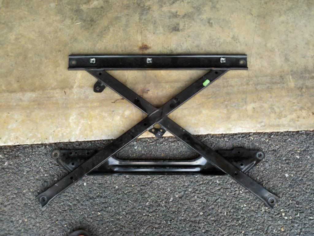

    Out with the old. Which I must say, every OEM part I pull off this thing is hideous looking! At least the outside is gorgeous!
    In with the new
    Yes that is a Adams box next to a very bare wine rack and a mini fridge full of Makgeoli and Soju
    About to do some serious business this weekend!

    Nice! That oem brace is really shitty huh. The state po po got me for tint one time. I only had to peel and take and show him. Re-tinted the same the following week for lulz. What is that to the far right in pic of detail supplies? Good ruck with the detail. Let me know if you have questions. One quick tip...if you have issues with removal of anything, a couple sprays of detail will work. Btw, you dont need much detail spray. I hit the entire car at once after a wash. Say 3-4 sprays on hood, one on fender, two on doors, two on quarters, etc.

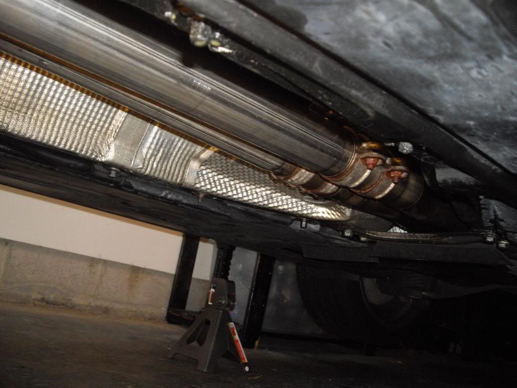

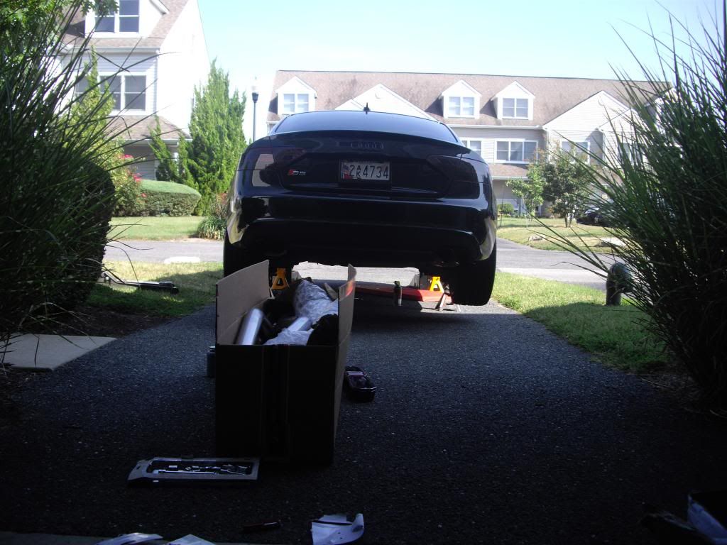

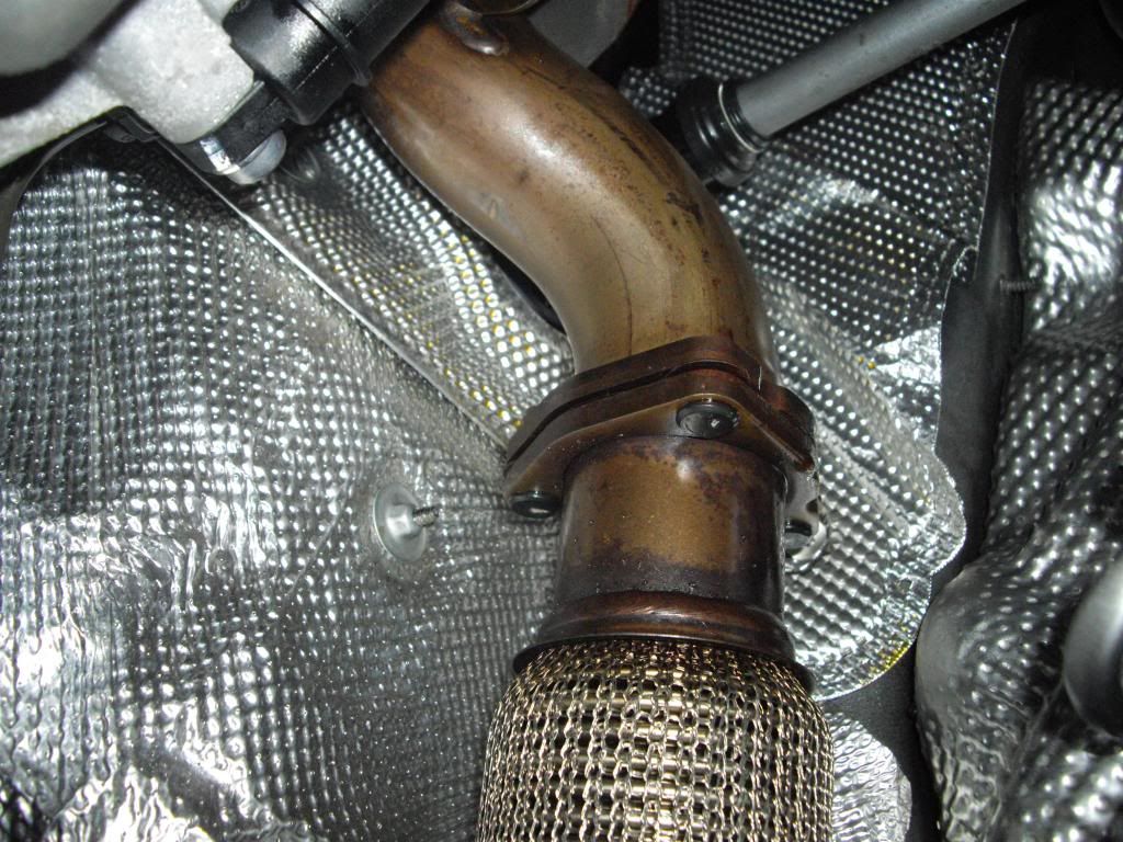

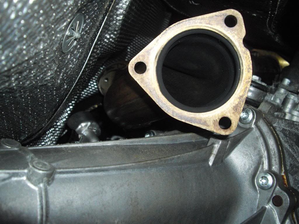

    So for you guys that put on your downpipes yourselves. How long did you soak the fasteners in penetrating oil. I sprayed and left for 30 mins and the 3 bolts will not budge. AWE says to soak for several hours. I hoping that this makes a big difference?
    Had everything all set. Up on stands and the connectors to the rear of the car loosened. Then the ones that attach the the exhaust manifold completely screwed me over, special AWE tool and all. Any advice would be appreciated. I'd hate to give up and call a shop for something so seemingly simple.
    ~ 4 hours later... Just resprayed the bolts with penetrating oil and going to let sit overnight, hopefully this does it.
    S5 4.2L V8 6MT, Ti Pkg,, CF, Sport Diff., Michelin PSS, Tunerdomes, Full Dip, Lamin-X, 35% tint, H&R 20/25, K&W v1, SPC CA, VAG-Com, AWE S-flo, AWE DB Touring, AWE Non-Res, Eurocode Sways & Alu Kreuz
    Build Thread FTW!
    Veteran Member Three Rings H20pologoalie's Avatar
    Sep 26 2011
    81748
    01 Honda Accord.... still going
    Kalbi Province, TX

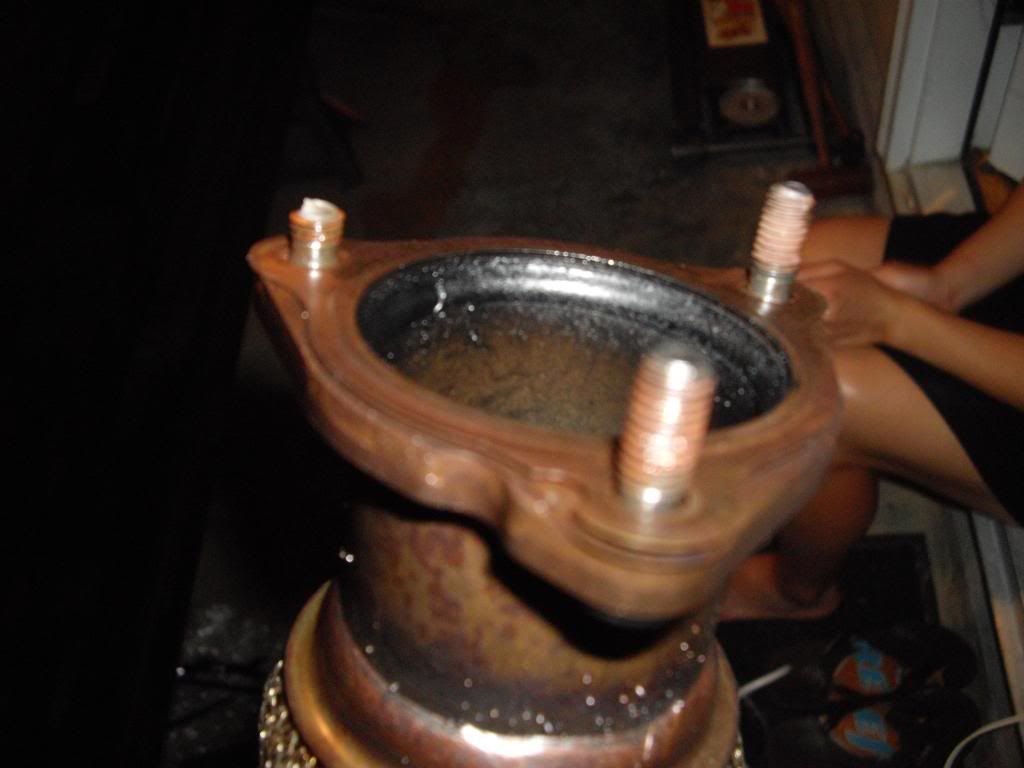

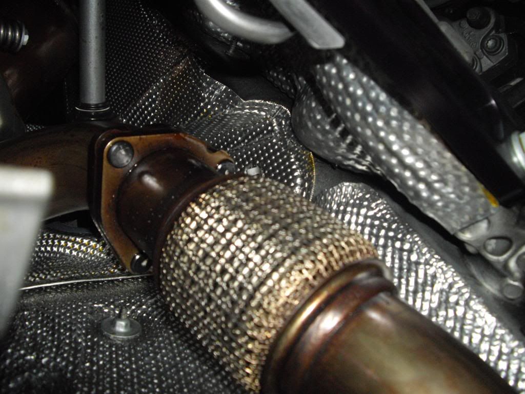

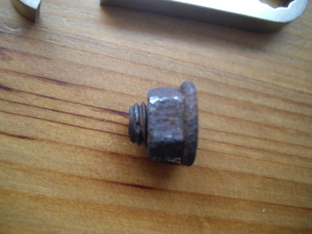

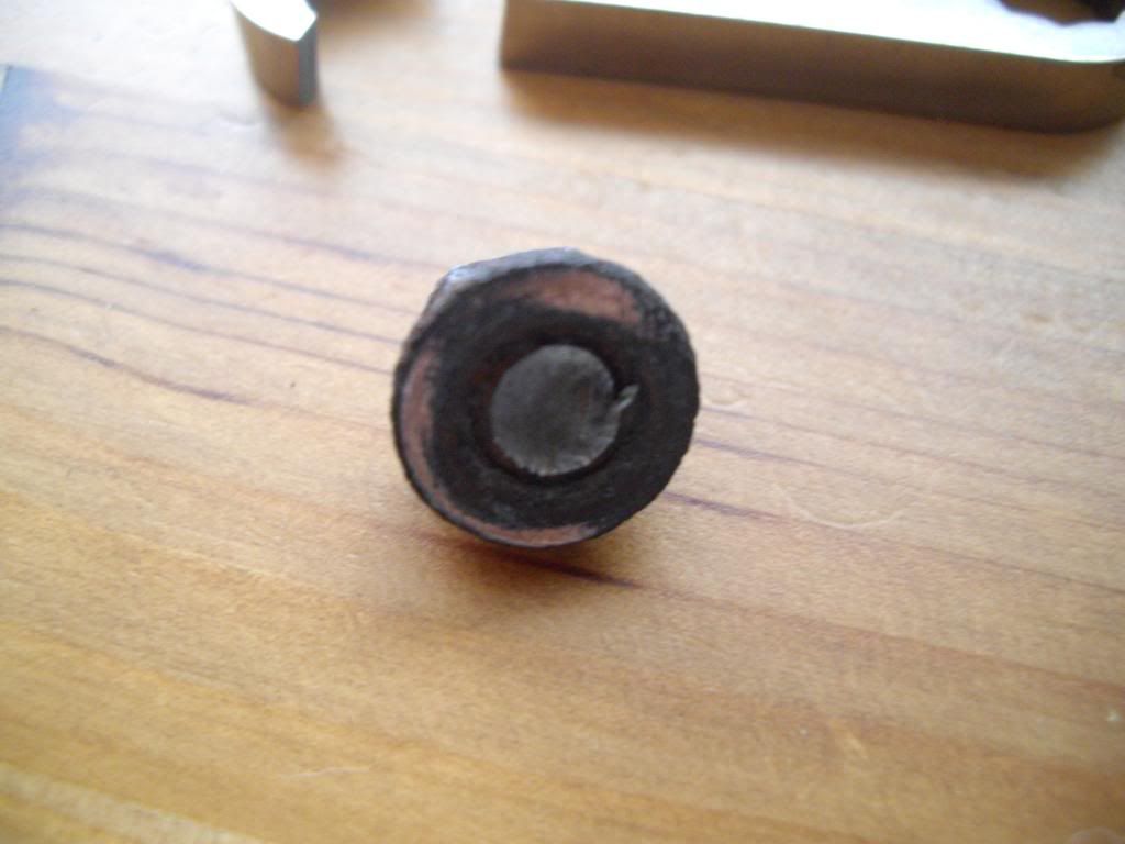

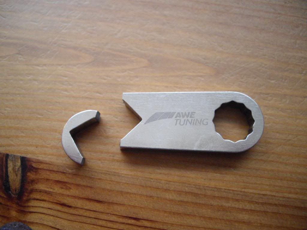

    So after an exhaustive two days adventure I am still no closer to getting these downpipes on. Which really sucks. Cause after yesterdays effort I did a full respray and let the bolts sit in penetrating oil all night. So in total 28 hours of "soaking". Woke up and got back to work bright and early.
    So far things are going nicely. Up on stands and no the real work can start, all over.
    Then once again after getting the clamp from the stock DP to the rest of my AWE tuning exhaust (already installed) loosened. I get to work on those 6 bastards.
    Then my first disaster strikes. Sort of a disaster since this is still not really an issue with a little grinding from a drummel and prying later on. Needless to say the bolt sheared off in the nut, but I got the nut off.
    So I soldier on and actually loosen a couple more nuts (2) one on each side. Then the other disaster strikes which halted my progress for the day, and possibly my DIY adventure (unless I go get a crowfoot attachment 12mm and 14 mm I think it what a A5OC write up says).
    BOOM!!!
    So tightened back up the other nuts at this point and set her back on her feet. Called it a day. Suggestions and pointers welcomed.

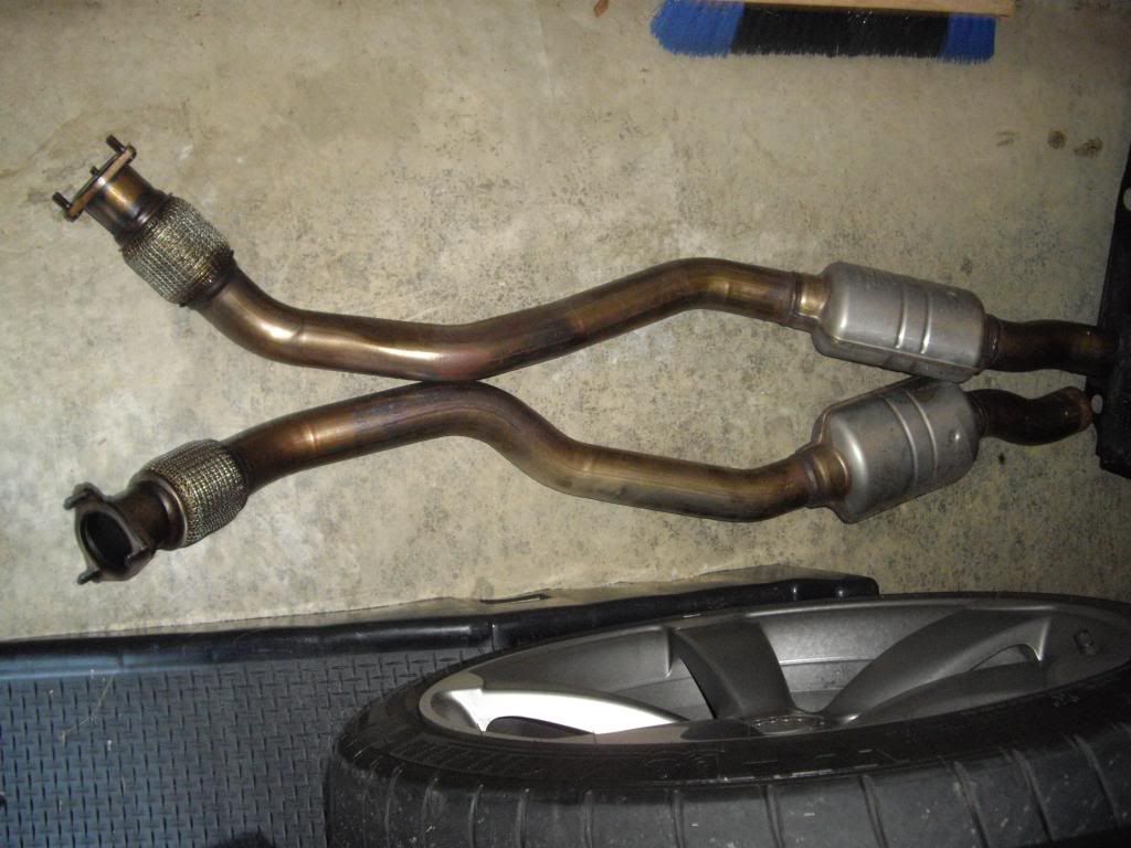

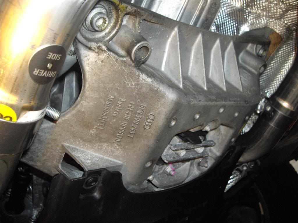

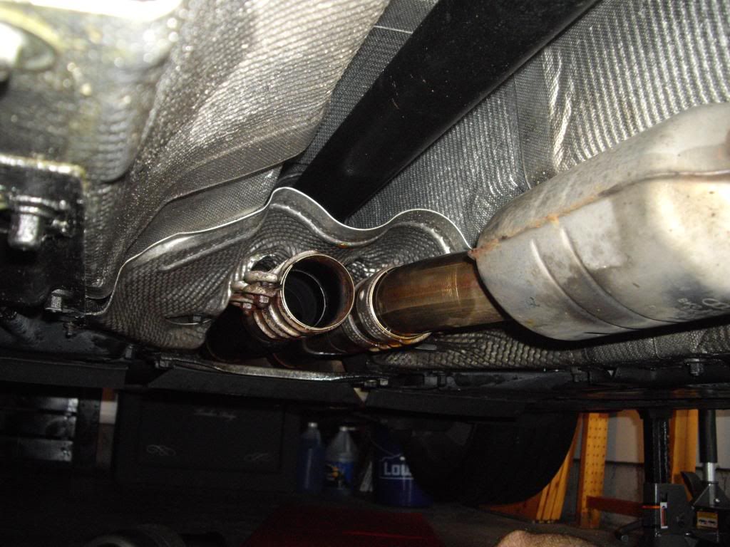

    Made some nice progress on the Downpipes today. There have been a few hiccups along the way, but first off, big thanks to Will at AWE. I had an unfortunate failed dp removal tool and they are all over replacement, even tossing in a shirt or something. That's awesome customer service right there as all I was doing was letting them know what happened in case it was a bad batch or something, who knows, they are looking into it.
    I only get about 30 minutes a day working on this during the week, so hopefully it will be done by weeks end. Anyways, here go some pics of progress being made.
    This is the crazy driver side dp, my nemesis. 1 bolt to go, facing up towards the cabin.
    Finally out!!! Actually didn't use the crows foot with the ratchet for this, kept slipping, so I went with a regular hex hand wrench and basically did a pull up on the damn thing to get it loose (after 2 days of soaking in penetrating oil). Ridiculous.
    More ugly ass OEM stuff. And the bane of my current existence.
    So this is the drivers side stock pipe that I sheared off the bolt, cause you know, I'm so big and sezzy.
    Drivers pipe up, half way at least.
    And while I was at it. I noticed that my dual clamp exhaust sleeves are nasty, and rusty and just need to be replaced. So I went to ECS Tuning to see what the replacement part would cost. The OEM one was going for $70 something a piece. Screw that. So after verifying that the pipe diameter was indeed 60mm, I ordered the HJS clamp that was $18.06. Much better price and well, it's just a clamp.
    The clamps should ship soon, but if I get this thing buttoned up before they get here so be it, I'll toss them on later.

    But props to you on tackling the DP install Polo. I tried and when the bolts did not move for me after letting them soak like you did I said F this and sold the DPs haha.
    2009 Audi S5 | 20x10 AG M510 Wheels | H&R Sport Springs | APR Carbonio Intake | AWE Touring Exhaust | AWE Non-Res DP | APR Stage 1 Tune | StopTech | FL Shift Knob | RS5 Grill | Satin Black Vinyl Roof/Diffuser/Splitter | Tint
    Sep 26 2011
    81748
    Kalbi Province, TX
    DP install is officially ovah!!! Was a major headache, but what's done is done. Readuy to go hit up H20 International end of this month. Next up on the Mod list is definitely E-codes, it's been a long time coming but I've had to prioritize my modding as of late. Not sure when the the deeezcodes are going on but hopefully sometime w/i the next six months or so. Depending on how long I then have to wait for ECS to get them too me cause I'm not dropping 15 hundy for them.
    Also the dudes at AWE, as I've said before definitely stand behind their products and step up in customer service. Then sent me a nice little get well soon package after my tool breakage. Replaced the tool, got a nice shirt, and a lp frame (I'm going to stick with my cf one, but it's a nice gesture for sure).
    If any of you guys are going to be at H20 this month, hit me up with a PM and maybe we can hook up, since it doesn't seem yet that Audizine has put forth an official meeting spot. Not sure what that's all about.

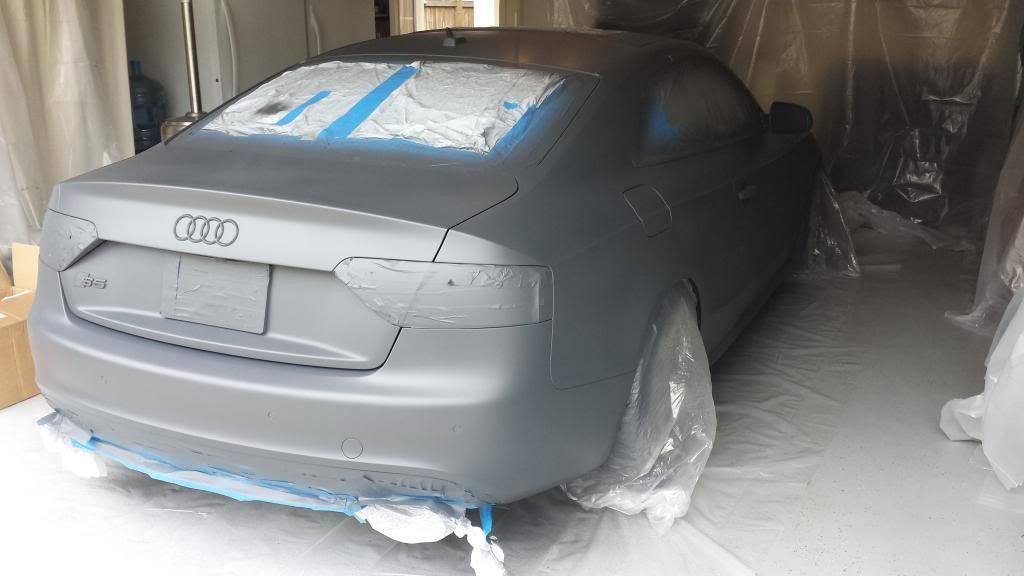

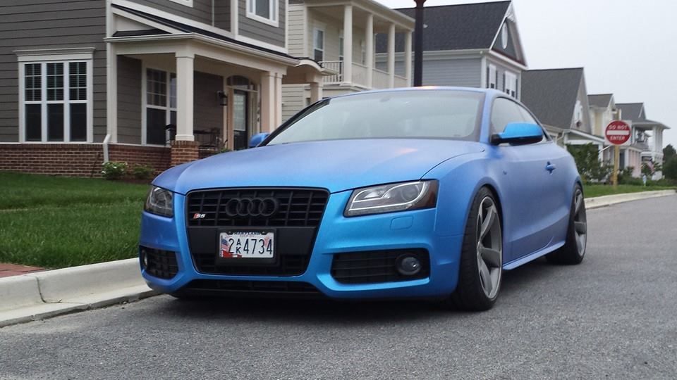

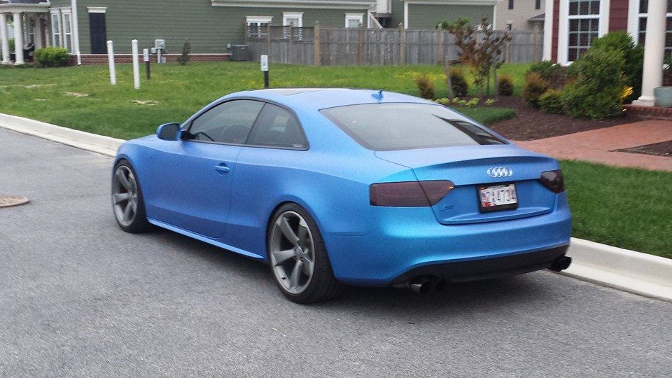

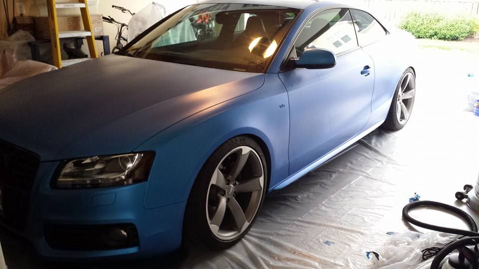

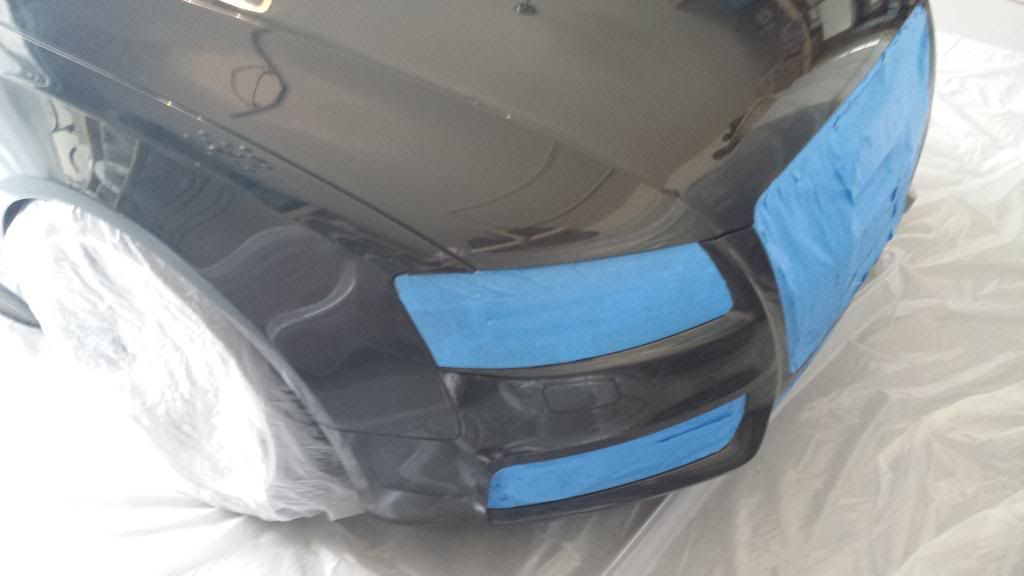

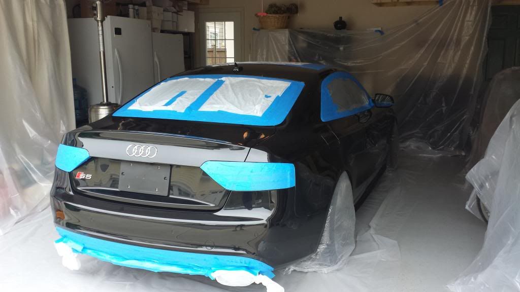

    So it's been a little while. I don't have any new hardware upgrades to speak of. However, since my wife and I are moving to San Marcos, TX, I decided that I needed some paint protection for the drive down from MD and the TX sun. I debated between a couple of different routes to go but landed on a full car dip. I'll probably catch hell for it by some, but that's ok. It's just a temporary thing anyway. I would have opted for taping it up but it will be daily-ed for a couple years and without a garage to call home while we house hunt for an unknown time frame... anyways I cataloged the full day adventure. Mostly I'm pretty happy. That hardest part for me was peeling the lines. I ended up with some gnarly edges in a few spots on close inspection, but since you need to peel when the last coat is still wet, it's a tall task to pull off when you are doing the whole job solo. All in all the job took me about 8 hours. 3 taping, and 4 spraying, and 1 cleaning the gun between coats. I used 1 gallon of black rds, 1 gallon gunmettal rds mixed together for my base coat, mainly because I wanted good coverage for peeling later (achieved 5-6 coats). Then I used 2 gallons of clear rds and 1 gallon of glossifier mixed together with 100 grams Sapphire blue pearl and 50 grams Suzuka Blue pearl to get my final color. I laid down about 6 coats of final color and only used 2 of the 3 gallons ( I could have sprayed the last gallon but I had gotten full coverage and it was getting late (so I saved the last gallon to do touch ups later if I need to). So here goes the pics, sorry no close ups for no, I was in a hurry to get home from the borrowed garage space.
    In the booth
    Taped off
    Base coat
    Pearls in packages
    Mixing it up
    On the 5

    Awesome prep work!
    You should join us on Dipyourcar.com/forums!

    Thanks, I'm a member over there but I should probably post this up in the custom colors or pearls section. Guys are always wanting to know exactly how you got what color.

    Yeah your color turned out amazing. You should enter the dip of the month contest over on the dyc forums. I would def suggest you get a good rubber cloth or the dipwasher, it makes it so much easier to clean a dipped finish.
