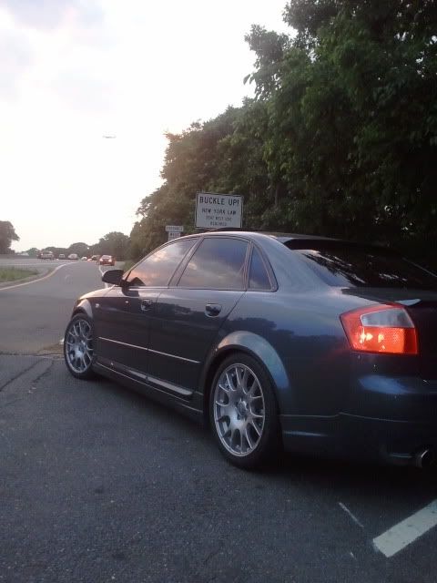

    here is a pic of the mean babe;)
    <a href="http://s1123.photobucket.com/albums/l551/carlitosny/audi/?action=view&amp;current=2012-06-10201215.jpg" target="_blank"><img src="http://i1123.photobucket.com/albums/l551/carlitosny/audi/2012-06-10201215.jpg" border="0" alt="Photobucket"></a>

    Nice bbs wheels fellow az member, and long island buddy.
