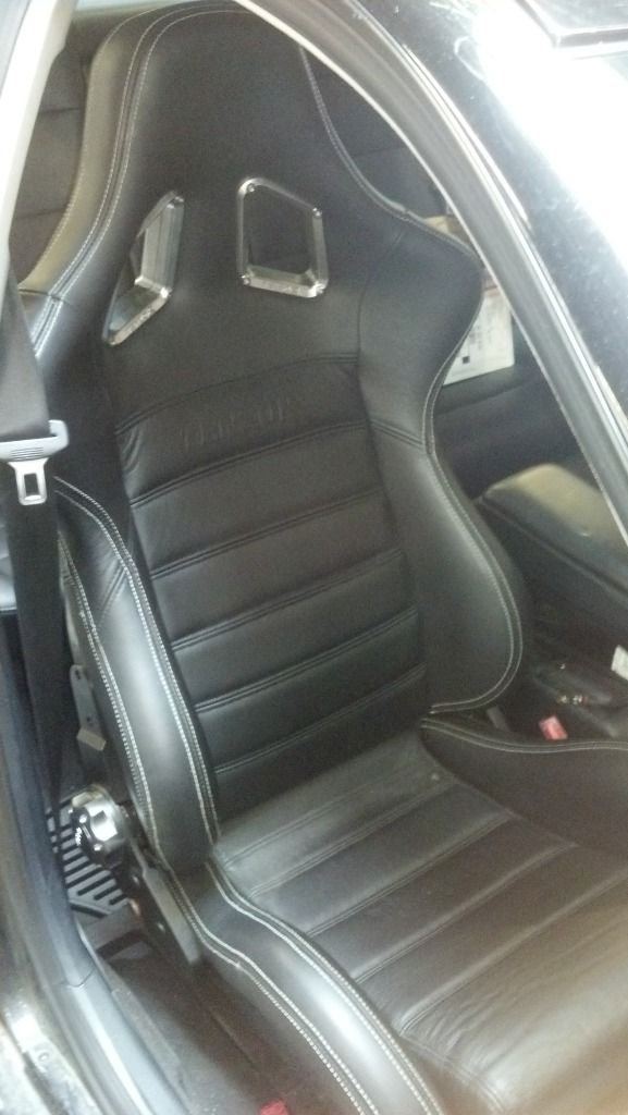

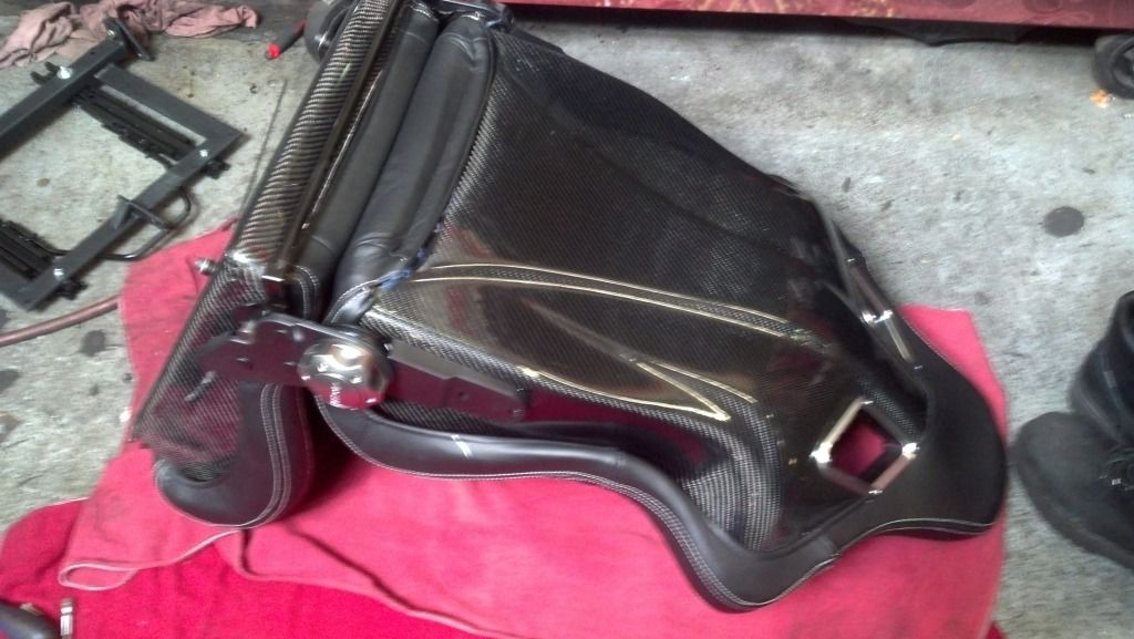

    Some interior stuff
    So anyone that has sat or driven in the stock pleather A4 seats know that they are the suck. I got tired of sliding around the car whenever I wanted to go around a corner so I got some replacements...ready for this???
    Tenzo-R GT Leather Seats
    Full carbon base and back
    I was skeptical when i bought them cause they're Tenzo's...Come on!! I was very surprised though when I found that they were decently made and really comfortable. I got a good deal on them so they were about half the price of the Recaro Sports I had my eye on. They came with some brackets and sliders but I didn't like how they were set up so I bought and modified some new Corbeau sliders for them.

    dude those are sweet. where did you get them

    Got them from a guy on Vortex. According to what i've read they were discontinued a few years ago

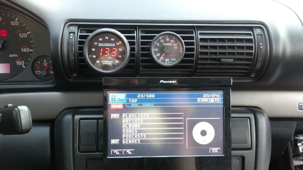

    Thanks Dillon. Yeah i'll give them a try. I imagine my tune was part of the problem cause I kept fouling out plugs. with the coils and a few tweeks to the tune its running alot better now...not perfect but better. Really need to get it on the dyno but it's hard to find time.
    Anyway... I was running an Innovate LC1 from when I put the engine in up until recently. Some people really like Innovate's stuff but mine was junk! It only worked half the time, the other half it would just blink. I went through 2 sensors, recalibrated at least 10 times, checked and redid the wiring a few times and it just got worse and worse. I got to the point where every time I would get into boost it would cut out. My friend had one on his A4 too and it started doing the same thing.
    Sooo...I pulled the innovate and went with Zeitronix. I could not be happier. Simpler to install, better guage imo, and haven't had one problem with it.
    Im running an Innovate myself. It does act silly sometimes. lol. I think its interference in the wiring. If it acts up worse than it is, I might be joining you on that choice. Looks good.

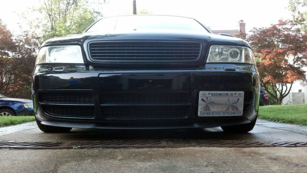

    Finally put a filler plate in the front bumper and made a bracket for the tag

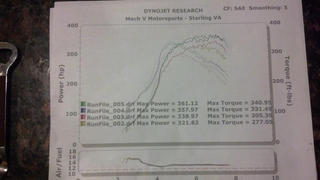

    Finally got The car back on the dyno after fixing a few small problems. I'm still running my rough Eurodyne tune but have some new stuff in the works so I just wanted to get a baseline to work off of. 361awhp, 341 awtq at 24psi

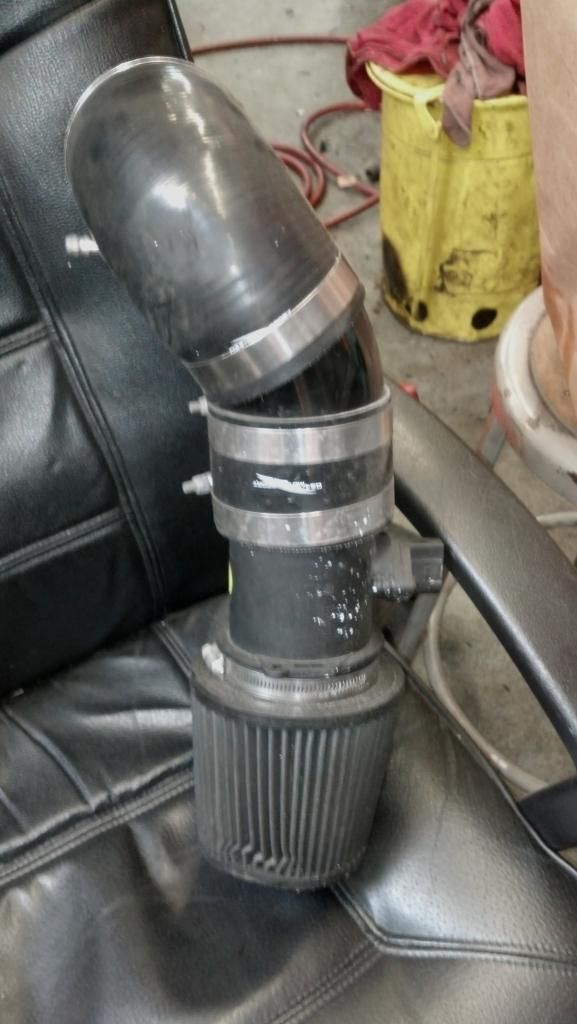

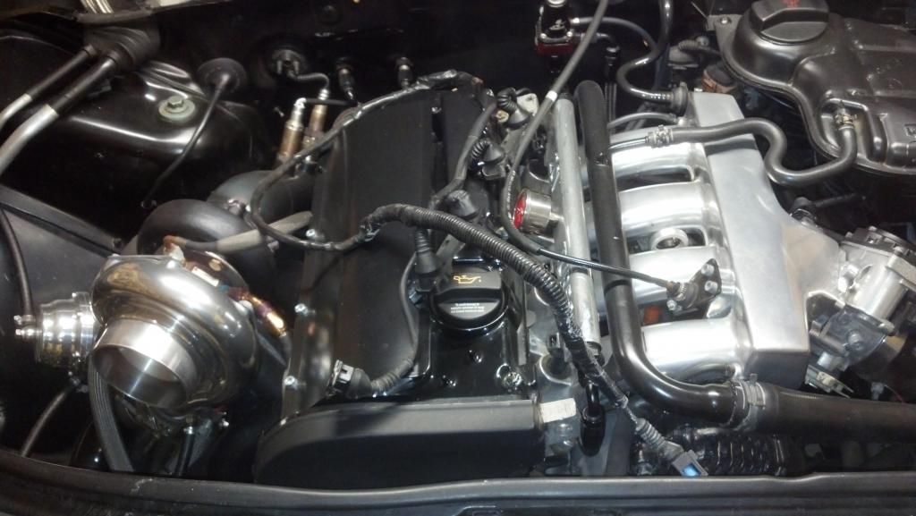

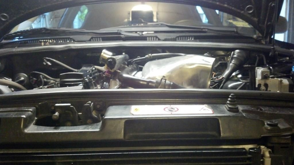

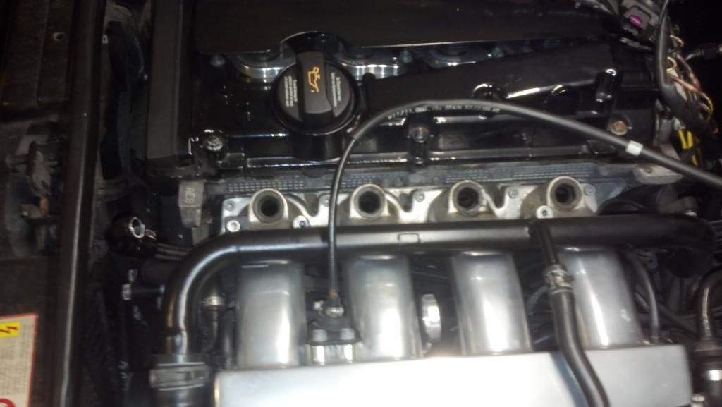

    There was some interest in what my intake setup looks like so here you go
  18. #58
    Established Member Two Rings DG NEMESIS's Avatar
    Dec 23 2008
    36680
    2000 Silver A4 1.8t, Nissan Altima, MK4 Jetta VR
    Nice congrats on the new numbers is the ith the new semi manifold? Where did you dyno at?

    Looking good bro, the build looks solid.
    You should go back to RAI dyno to compare.

    people don't realize how hard it is to make 400awhp. Every build making 330whp always swears up and down they are making 400 but usually never prove it

    Thanks man. Dyno was at Mach V motorsports in Sterling. Still the stock Aeb mani, the SEM isn't on yet...doing some work to it before it goes on.
    Quote Originally Posted by Don Supreme View Post
    Thanks. I will eventually make it back to RAI to get my heart ripped out but Mach V is closer so I will probably do more tuning there.
    Yeah I know. Still shooting for the 400 whp mark though. I've got some new management coming soon for it which will hopefully get me there.

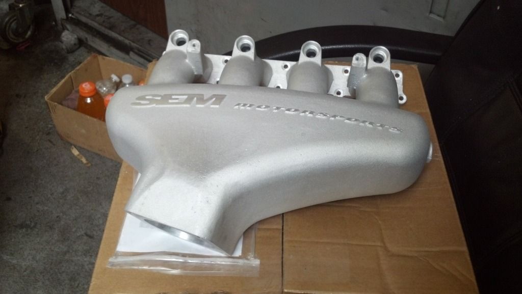

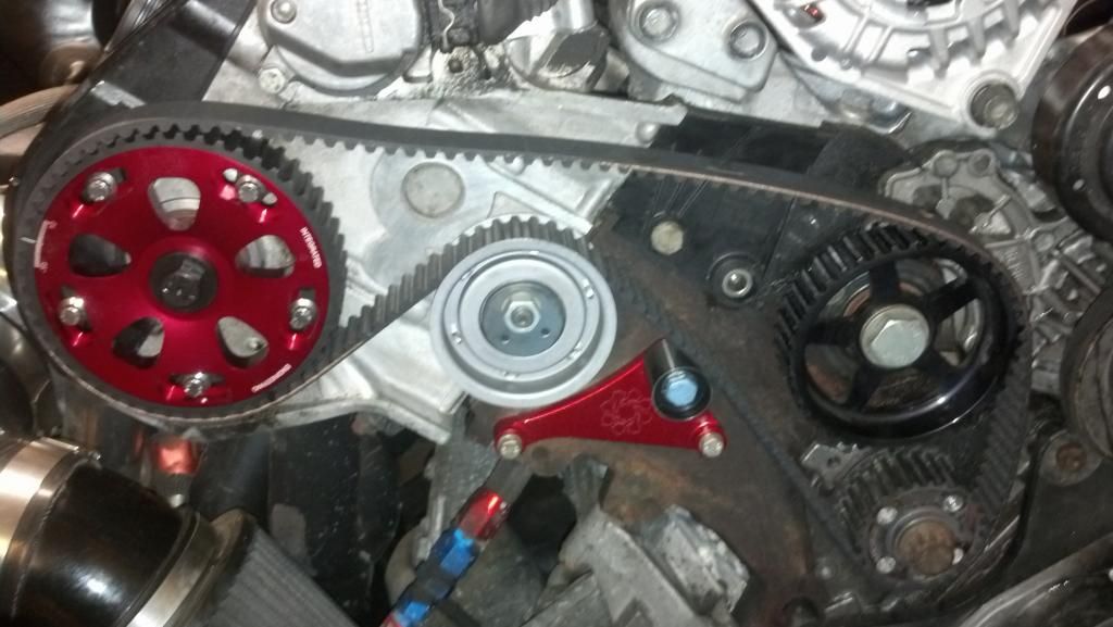

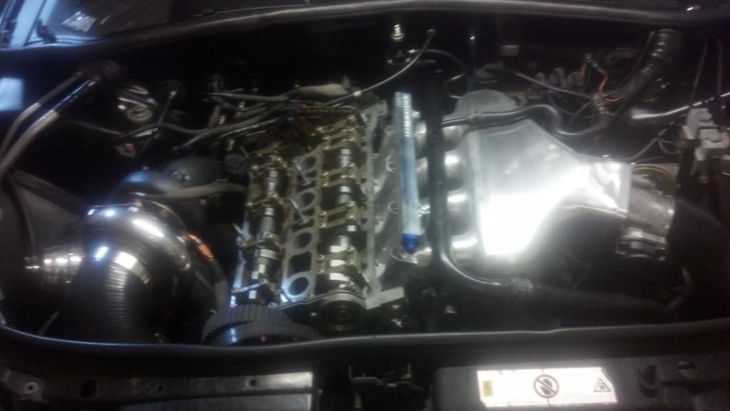

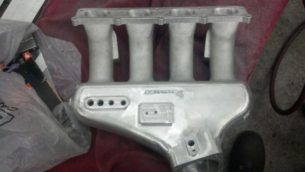

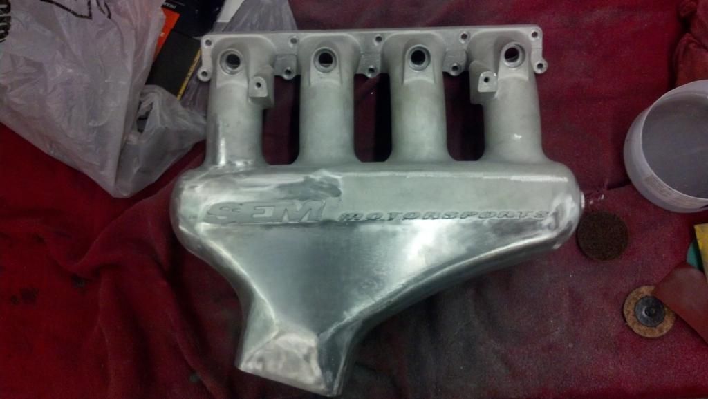

    So here's a little update.

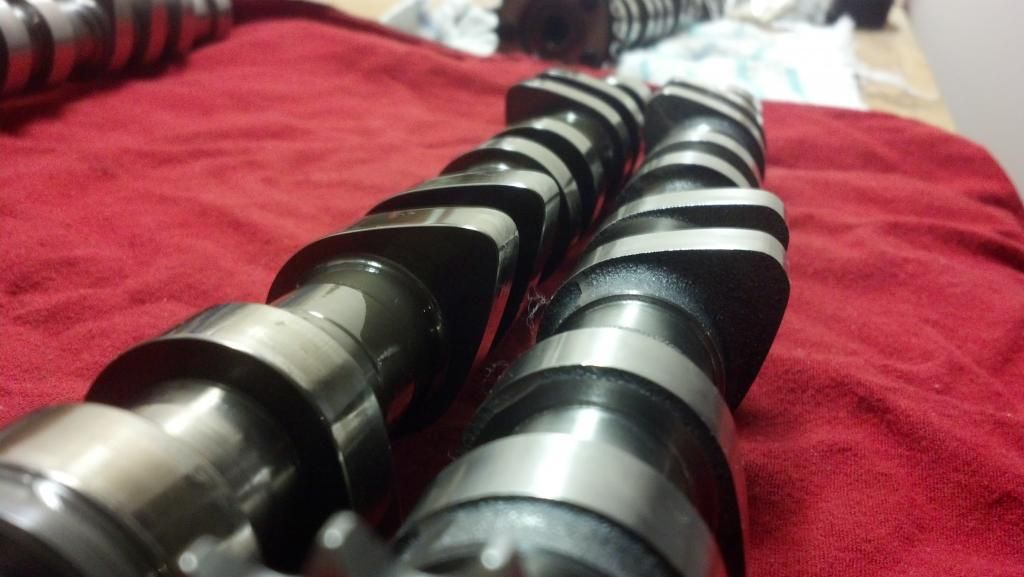

    I was changing the oil yesterday and decided to take a look at the timing belt just to make sure everything looked good. I was a good thing I did cause i found that the cam position sensor bolts had backed out and the sensor was just flopping around. No damage done but it could explain some of the roughness in the power curve on the dyno printout

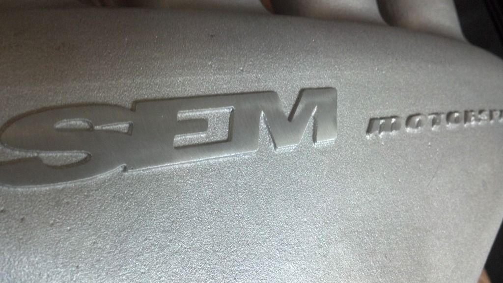

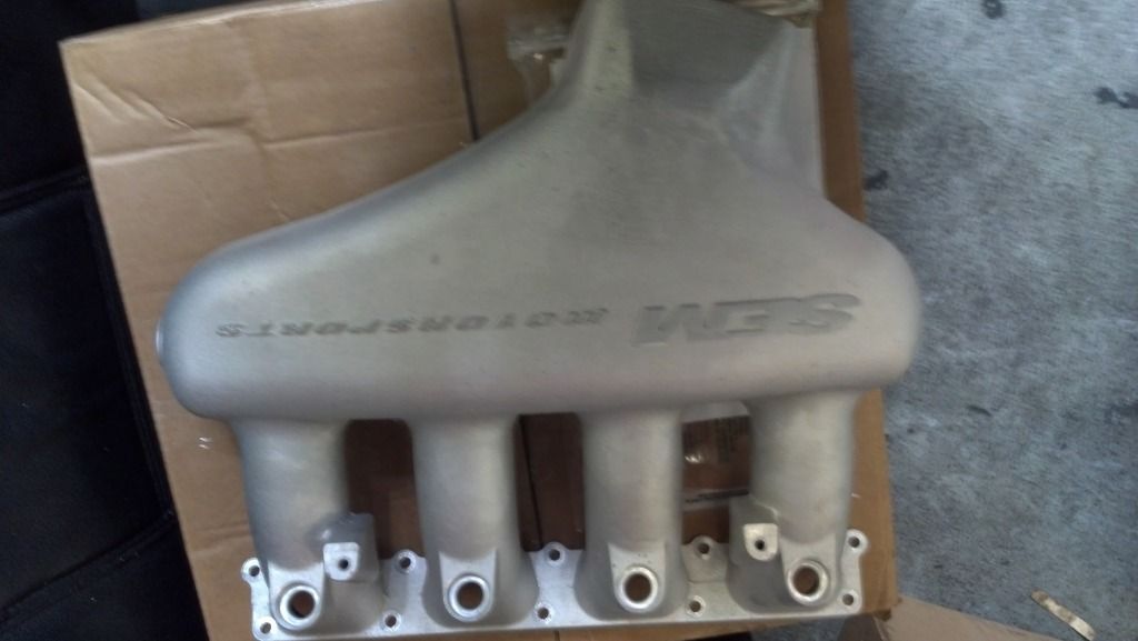

    Started the polishing process for the SEM manifold. Its slow going but should look good in the end.
    Before:
    Currently about 4 hours in:
  23. #63
    Jan 25 2006
    9902
    A4 2.0T
    MD
    I remember desperately waiting on this manifold when I had an A4... Now they are out and it doesn't seem like many people are running them? Am I wrong?
    What kind of gains do you expect?
    It seems to be getting harder for the shops to get them from SEM, there also seems to be a big issue with running them on the B6 because the fuel rail ends up hitting the hood frame even with 48mm injectors. To fix the issue one person ended up going with a set of Stern B6/B7 S4 4.2 motor mounts which are shorter then the standard mounts and also went with a shorter transmission mount.

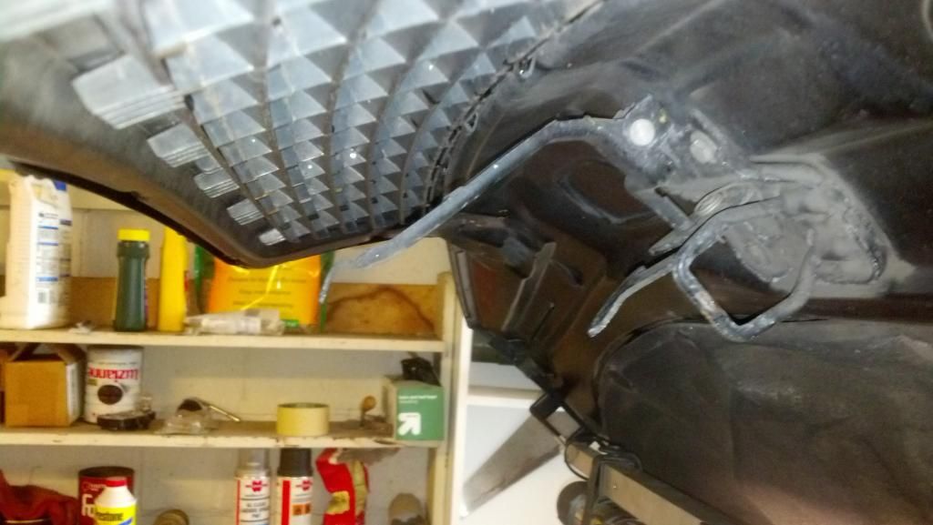

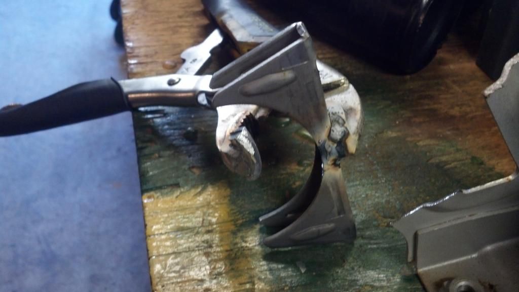

    By any chance do you have a picture of your hood latch? How you modified it to fit the badgeless grill
    Why is it so hard to get? Are they still in production?
    I got mine directly from SEM back in June, took about 2 weeks to get. As for gains... don't know but I'm interested to see. I will probably dyno the car once more before I put it on then again after to compare. I know that conditions change between dyno sessions but it should provide an idea of gains. 034 got a max of 44whp more then the AEB on their timeattack car so I will guess 20-25whp on mine.
    Yeah I'll snap one next time I have the hood up.

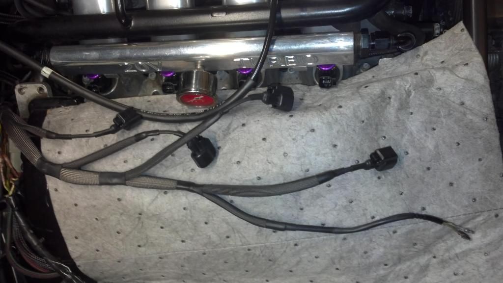

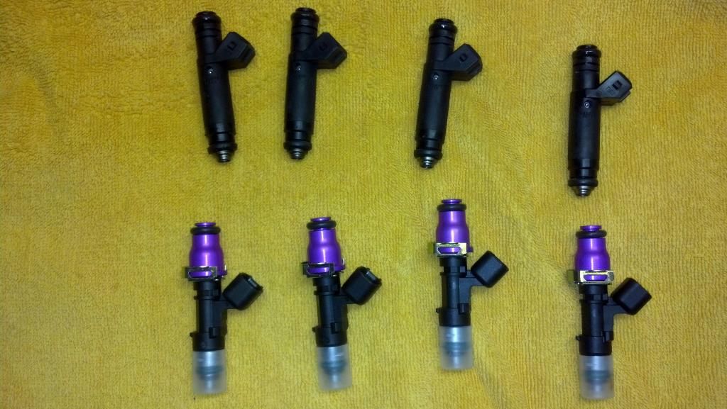

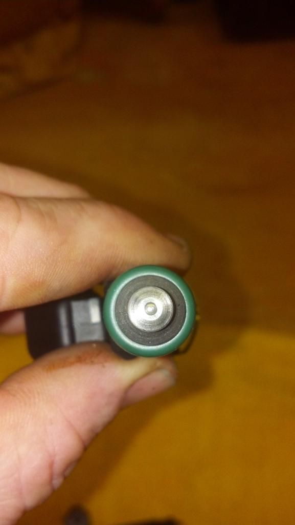

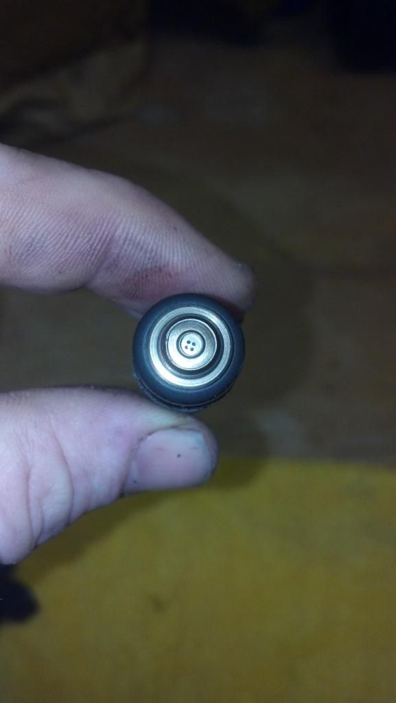

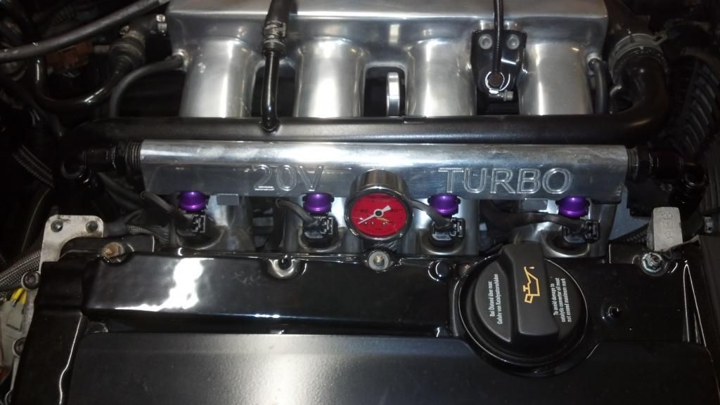

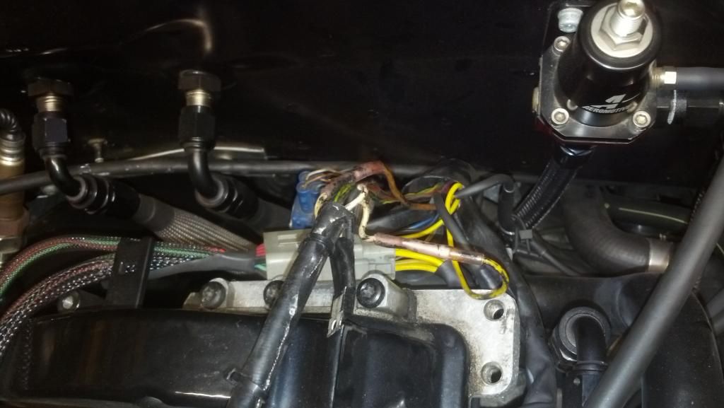

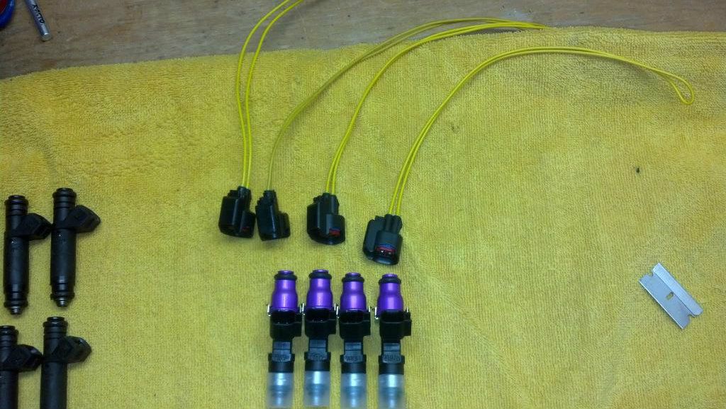

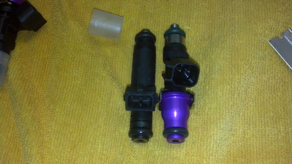

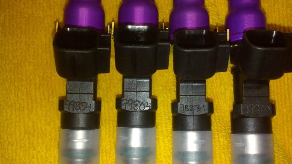

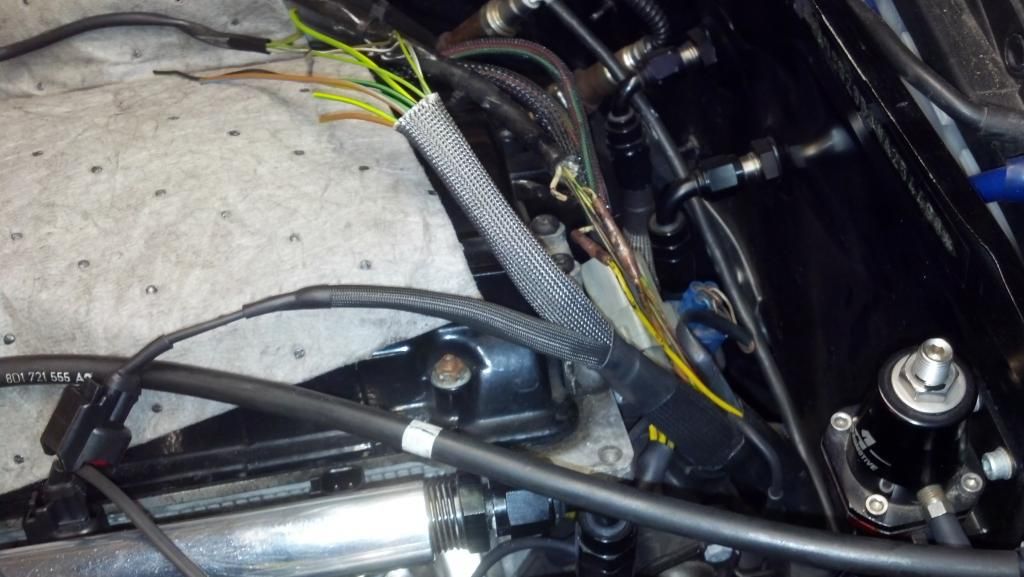

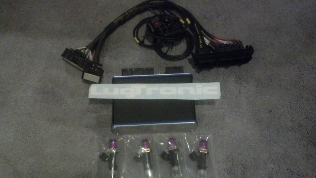

    So here's what I been up to for the last few days:

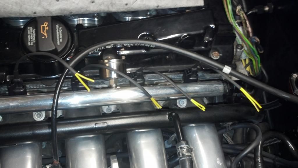

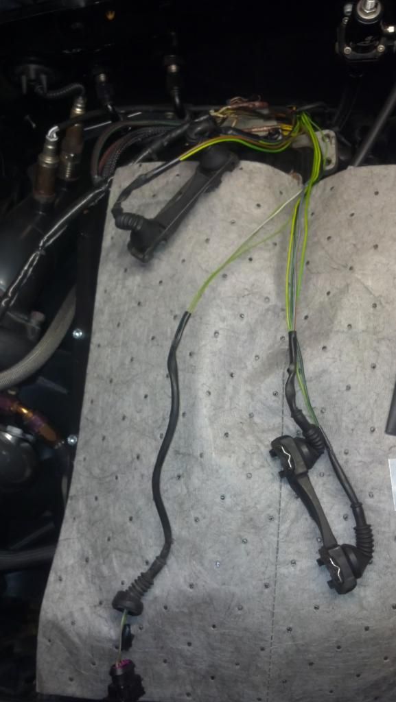

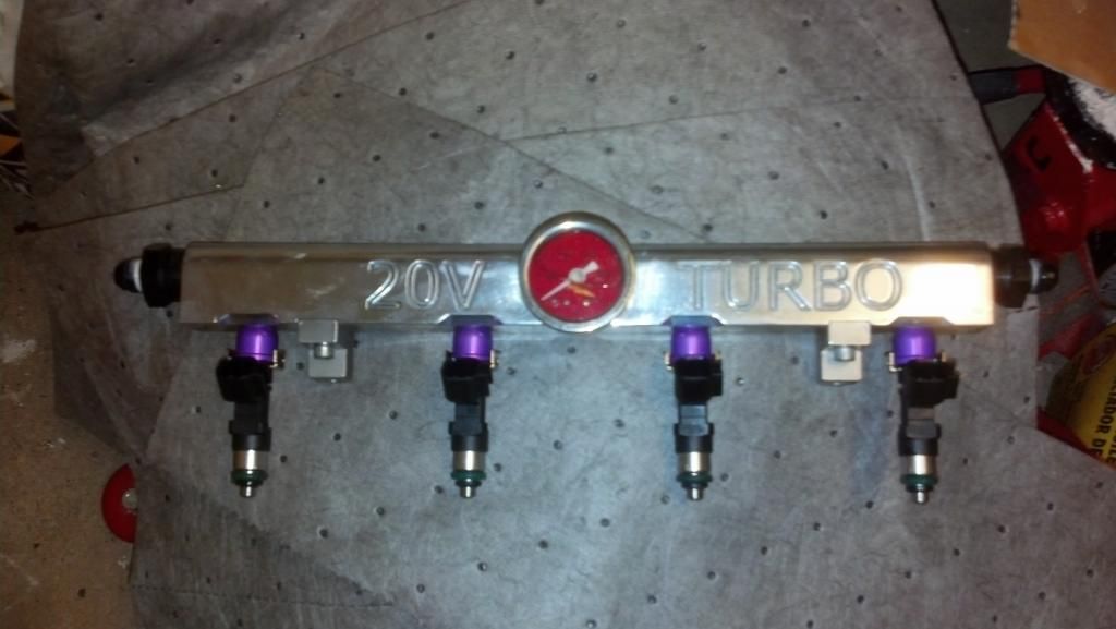

    Started pulling everything apart for the new injectors
    I'm sure this made more sense to me when I made the MAF harness for the TAPP tune
    New ID 1000cc's next to the old Siemens 630's
    ID's
    Siemens
    Flow Matched
    New connectors
    Made a new injector harness and routed it under the intake manifold

    Quote Originally Posted by NeedingAnAudi View Post
    BTW...

    Decided to finally put on the intake manifold even though I'm not done polishing it. Time to make some power not care what it looks like.
    She's a big bitch

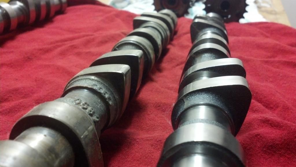

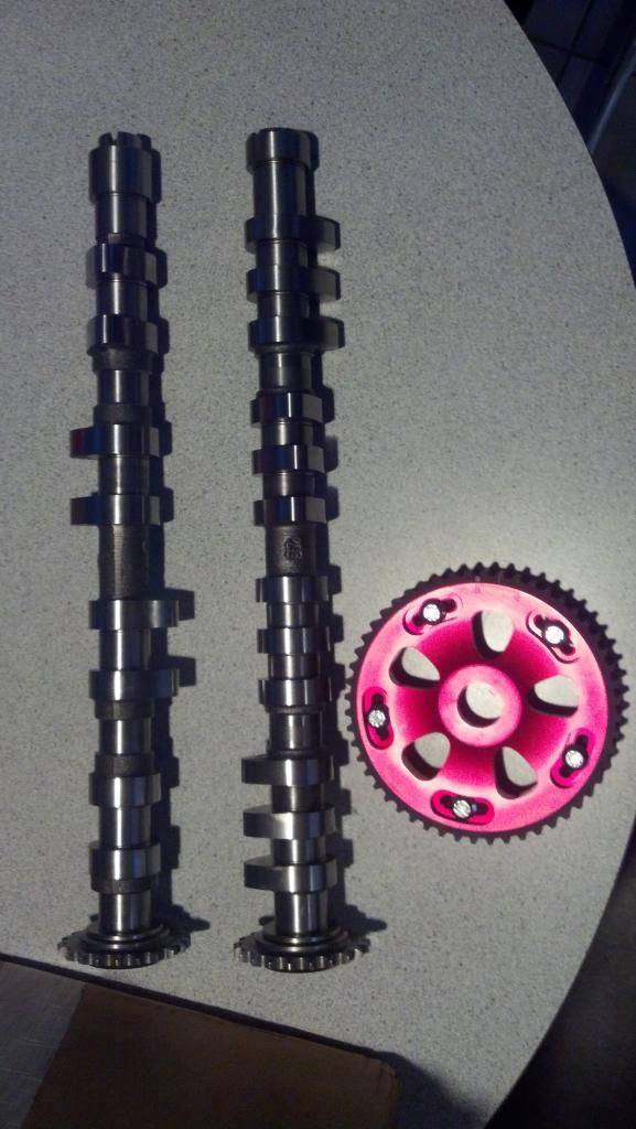

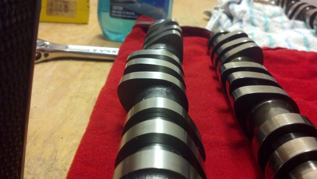

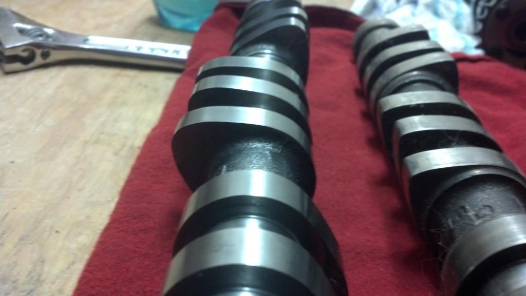

    And since I'm doing that, might as well put some new cams in. IE IECVA1's
    IE's compared to stock
    IE's compared to the Schricks
    Fuel rail was hitting the hood so I had to get a new 034 rail. It's about 1/2 an inch shorter.
  34. #74
    Dec 05 2007
    23104
    Was just going to ask about the clearance with the SEM manifold, but you already answered that question.
  35. #75
    Senior Member Two Rings stunner247's Avatar
    Dec 06 2006
    14009
    98 a4 2.0tq, 86 vw cabby, 91 V8 Quattro (sold), 98 328is, 1970 C10
    DC
    I had to take the foam off from the under side of the hood and now have about 1/4 inch of clearance between the manifold and hood brace. I might clearance the brace if it shows signs of hitting. I found that you can't use 60mm injectors either or the fuel rail will hit (even the shorter one). My ID's had a billet extension piece on the top that I was able to take off to get them to the 48mm size needed.

    Wow! I also never knew the difference between the IE and Schrick cams.

    Also found that my timing belt stretched. tensioner was all the way out and still could move the tensioner pulley by hand. Very glad I caught that.
    Anyways...got a new manual tensioner from Integrated and a new belt

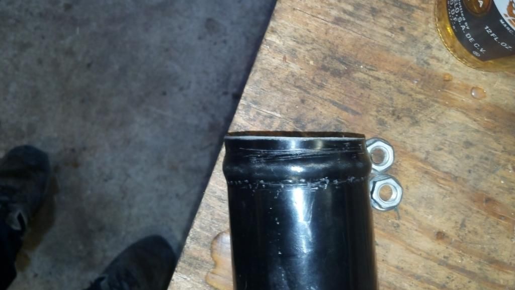

    Also had to redo my cold side charge pipe for the new manifold. It was one piece but I had to cut it and ad in two 45 degree silicone hoses. Made a tool to put some beads in my pipes
    End result after 5 mins of work
