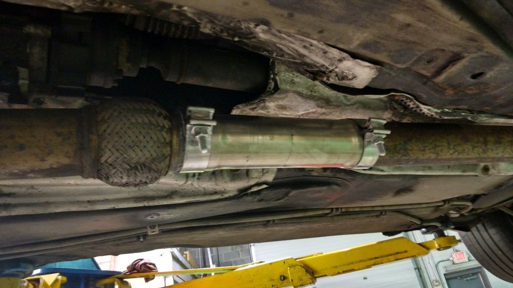

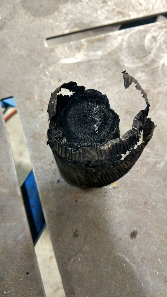

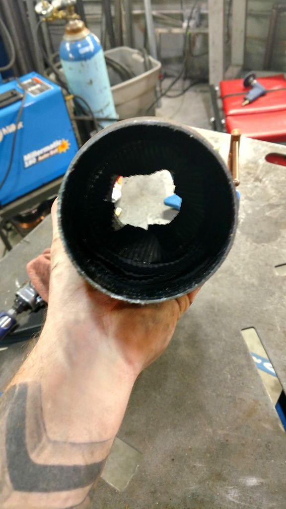

    So I have around 1k miles finally. I turned the boost up and went to do some logs when I found that the pressure would not go above 14psi. After some diagnosis I found that the CAT had blown apart internally and was lodged further down the exhaust causing a huge restriction. I ended up deleting the CAT temporarily and found that it has probably been partially blocked for some time because the car is WAY faster then its ever been now!

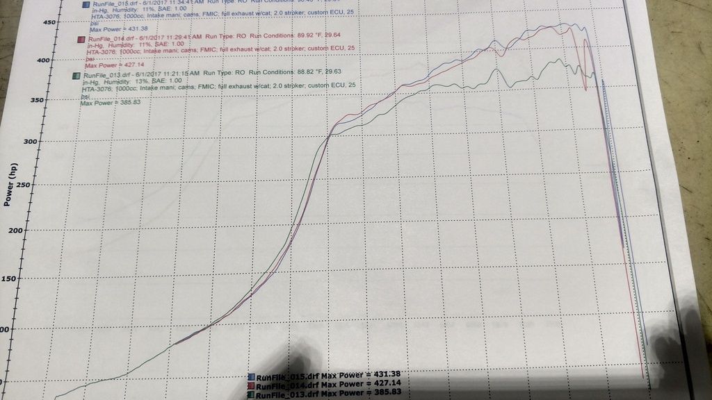

    Finnally got her on the dyno again with much better results. 431 awhp and 352 awtq @25psi on 93oct pump. Still needs some tuning. It was hitting some strange rev limit at 7500rpm even though nothing is set to that but oh well...making progress
    (torque graph not included on print out because of rpm pickup problems)

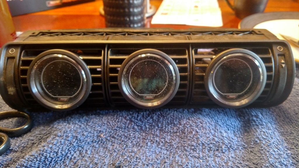

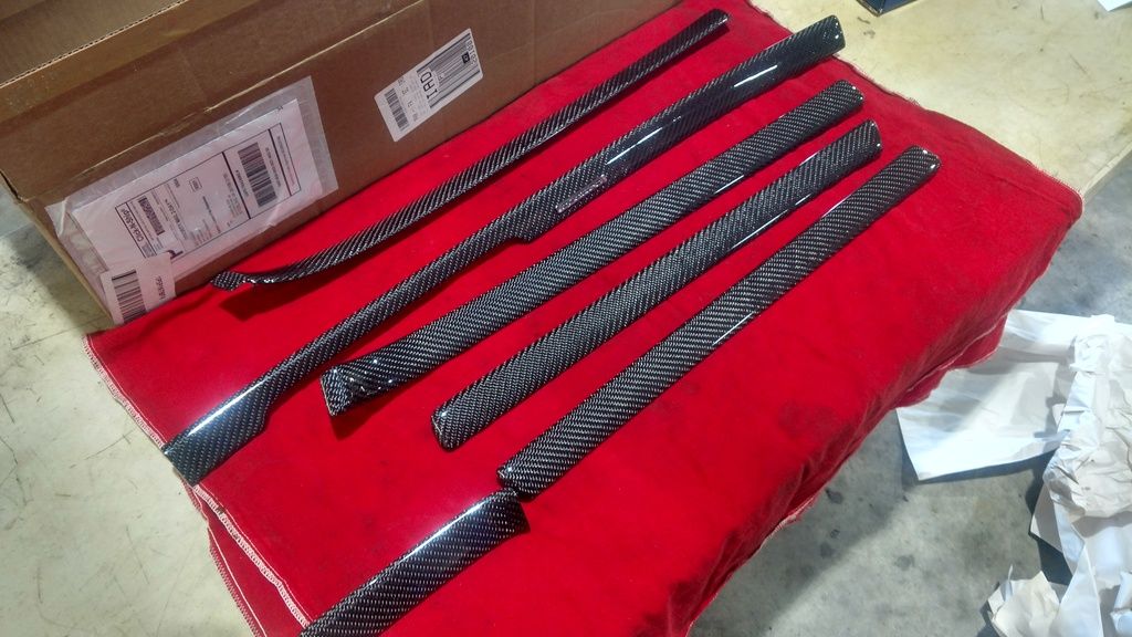

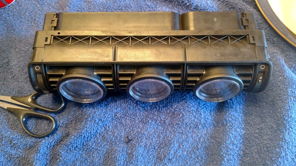

    Also started doing some updating to the interior
