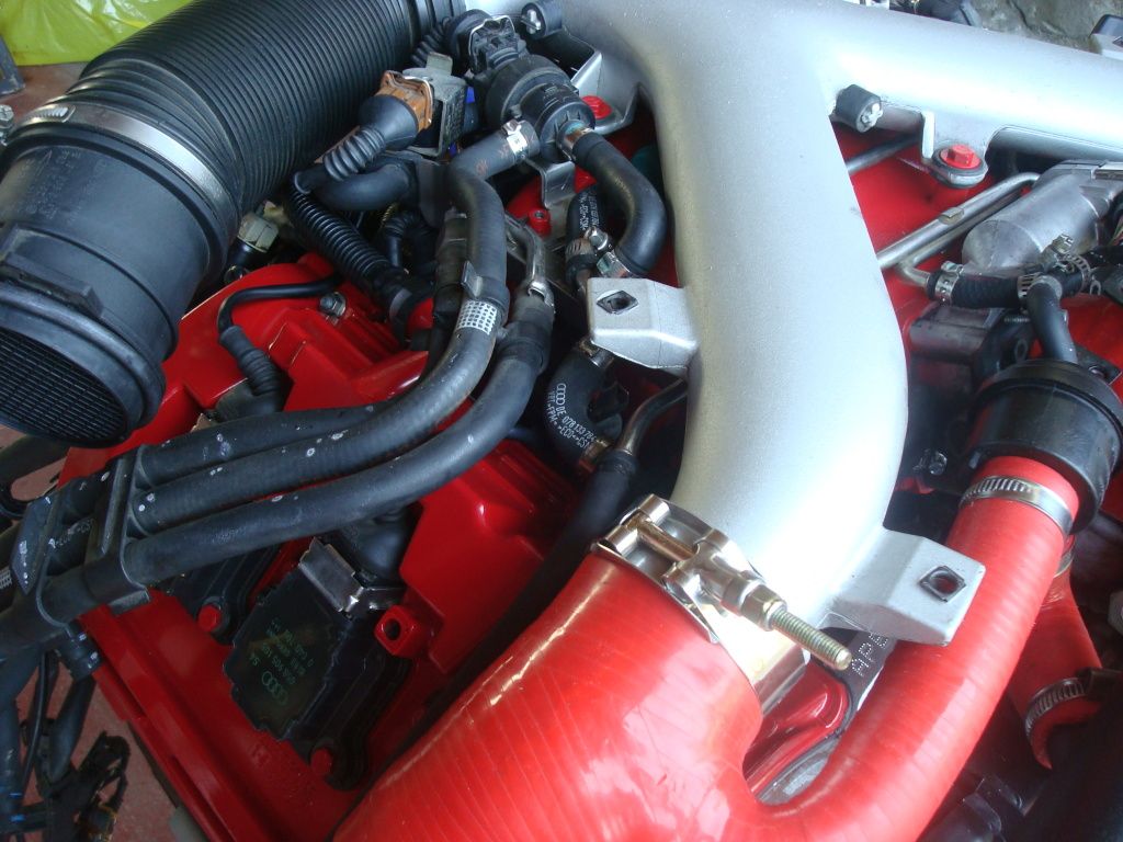

    im still waiting on a 034 tbb and the correct t-bolt clamps. inside is a Gates blue racing timing belt and all new OEM wp, tstat, tensioners and seals. i have piggie pipes to go on with a true dual catless 2.5" exhaust. stage 2? ill need good DV's and a Hitachi MAF.

    Quote Originally Posted by quattroloco View Post
    What exhaust? B6 S4 one?
    Also, yes the 034 kit will fit
