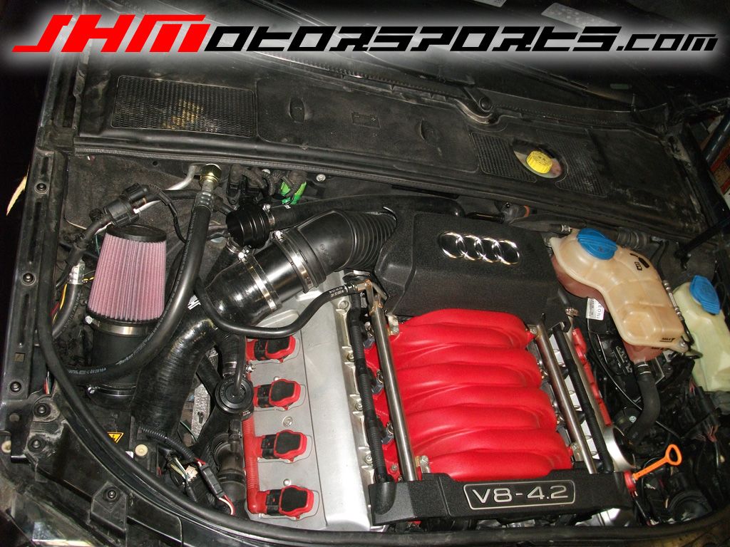

    I powder coated my VCs black and got the JHM IM powdered wrinkle red. I love the way it looks:

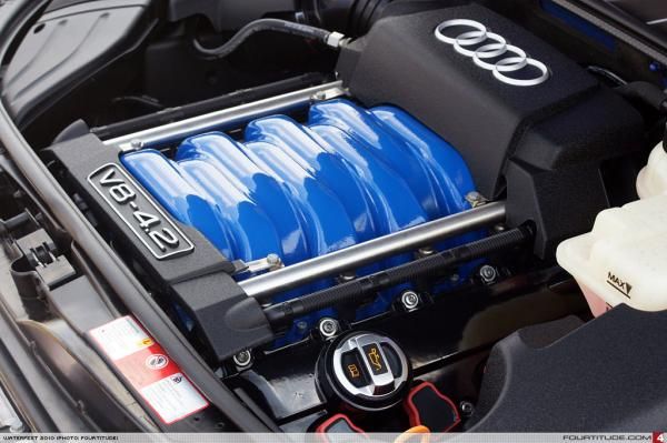

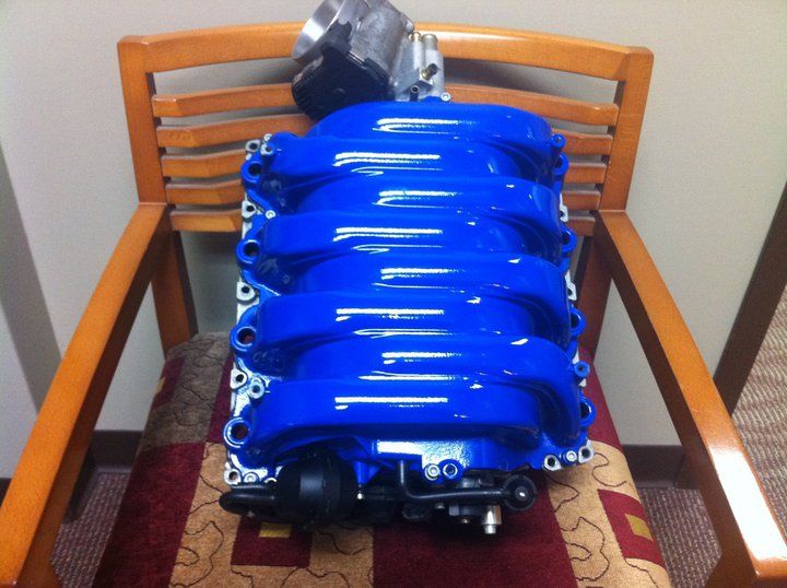

    Yeah it can be done and after a few seconds of searching on Google images I found the four below. Red and Blue seem to be popular colors that people choose when they get their intake manifolds modified by JHM but you could always remove the intake manifold yourself and paint it. Plus it is a hell of a lot cheaper that way too!

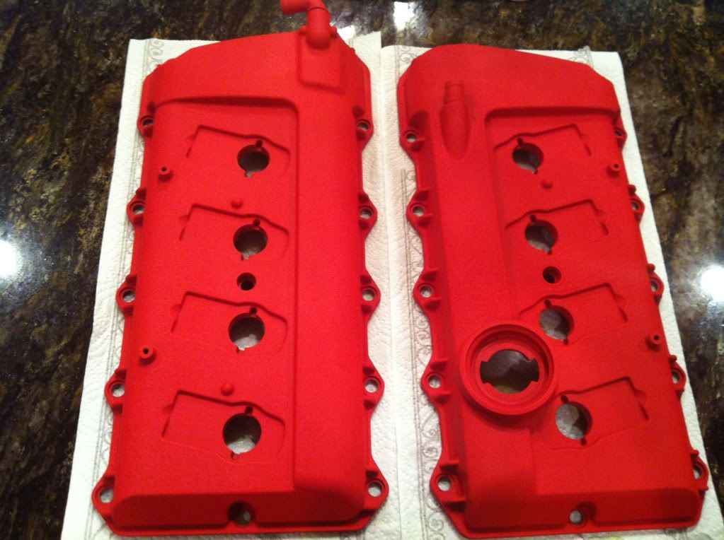

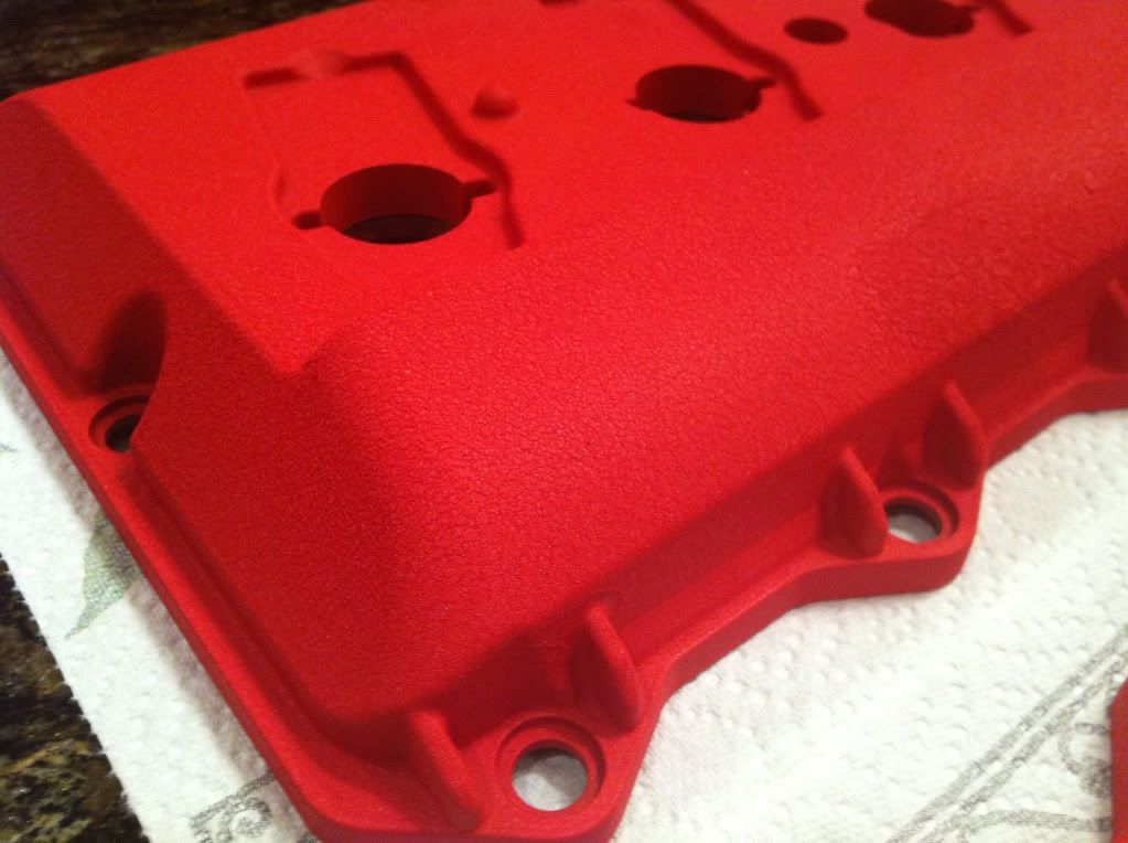

    like I said, not my thing but B6JoeS4 did a bangup job when he painted his VC in wrinkle red
    This was done with VHT Wrinkle Red. It's really popular in the JDM world but a lot of the Audi guys think they're too good for simple paint.
    You basically apply one heavy coat and then either pop it in the oven and stink up the house or just hit it with a heat gun to produce the heat gun. Allow it to cure for 48 hours and presto - all done.

    Hmm is that really all it takes? I know I said I like the oem style above, but if its that easy.....By the way, what color is that?

    M|R: It's the same color as clifford, the big ____ dog

    Hahaha. Blue right?
    Seriously though I was wondering if you used any special paint or something along those lines because that looks MINT. Cant believe a heat gun made it look that professional.
