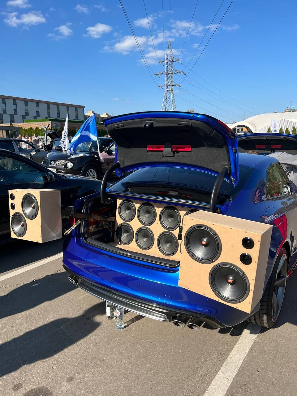

    So far. Added mid bass speakers (PRV), steering wheel couple months ago. Building 4th order enclosure, about a month ago, and will be converting to a 192MM crank on Friday/Saturday with supporting PLM HX, along with suspension refresh.

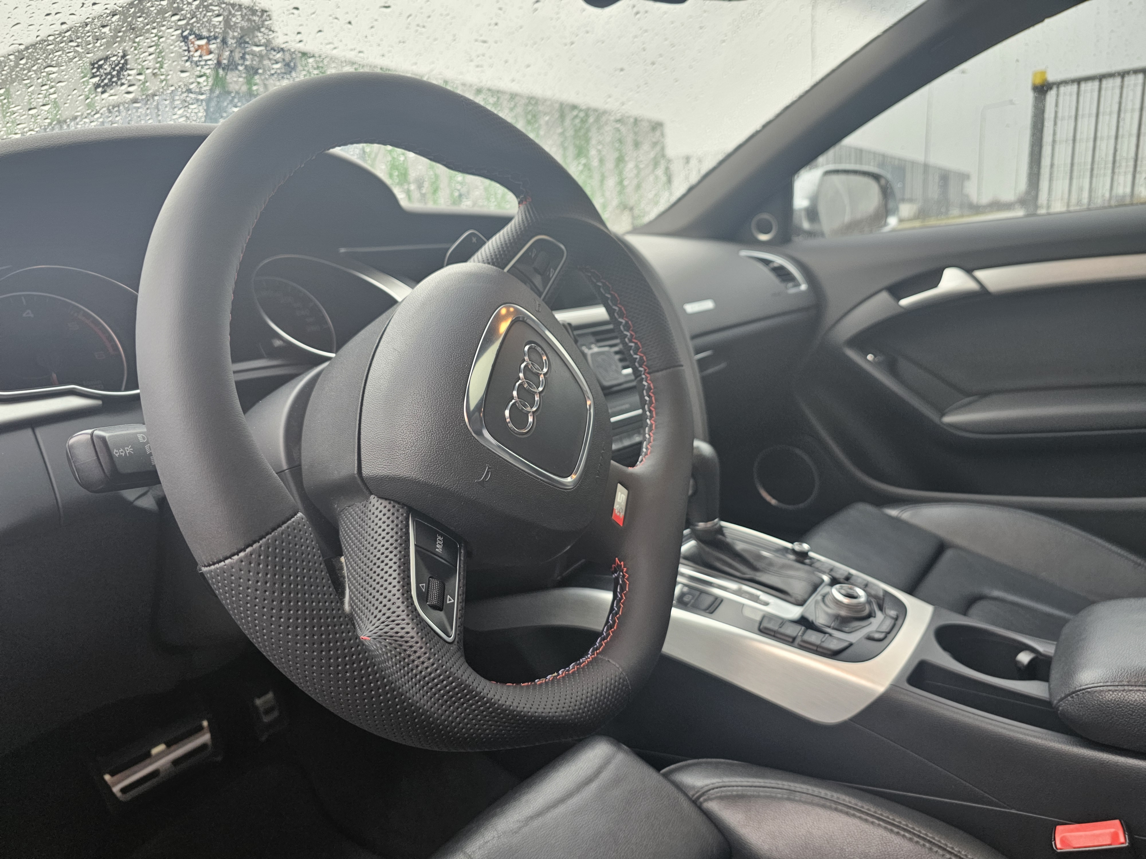

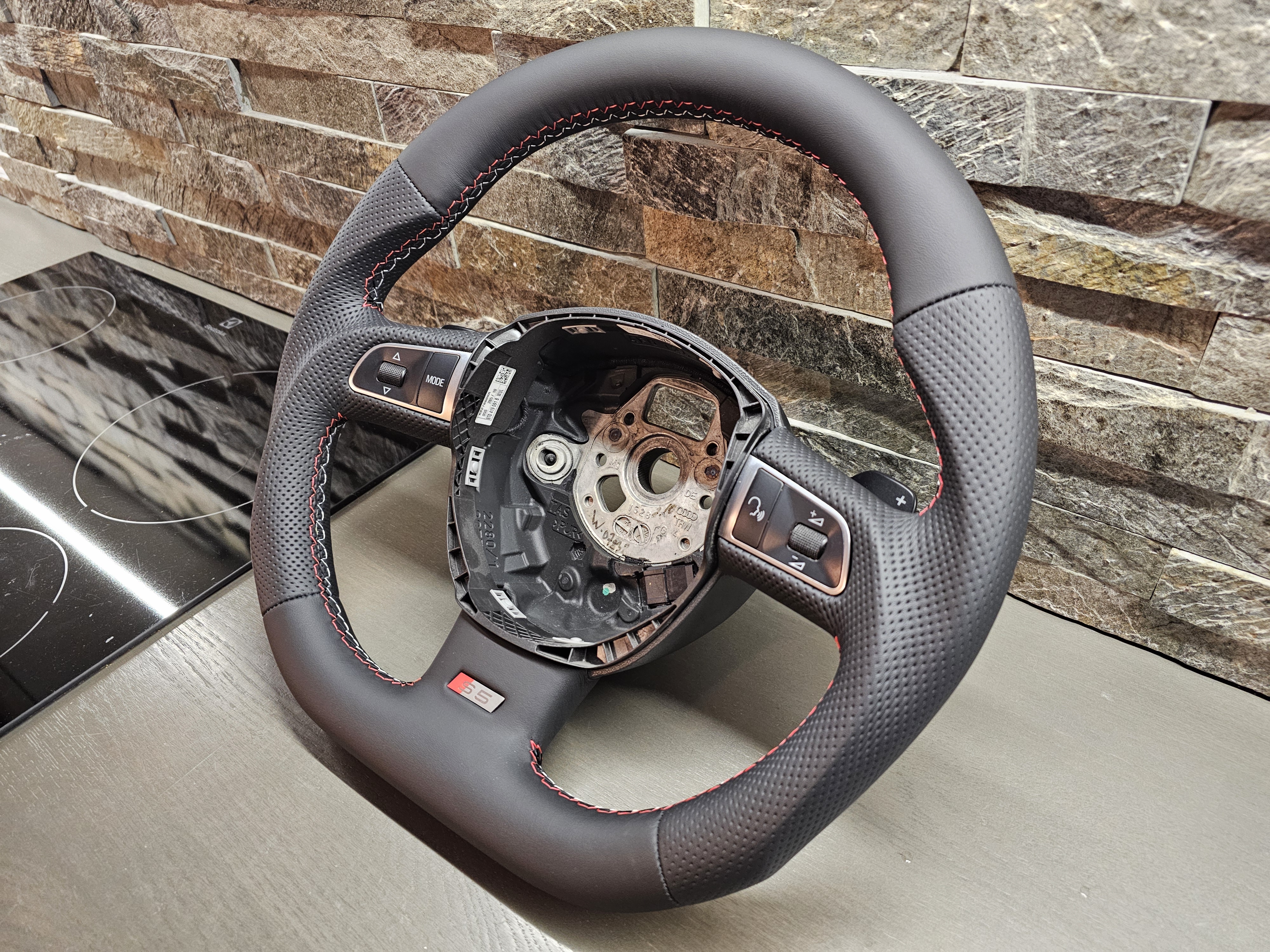

    Bought a flat bottom steering wheel from ebay seller aacars14. Looks great and everything, but the S5 badge is a cheap knock off. Will replace it with oem badge soon. Other than that, really love it.
    Took 26 week days from paying to deliverd to my door.

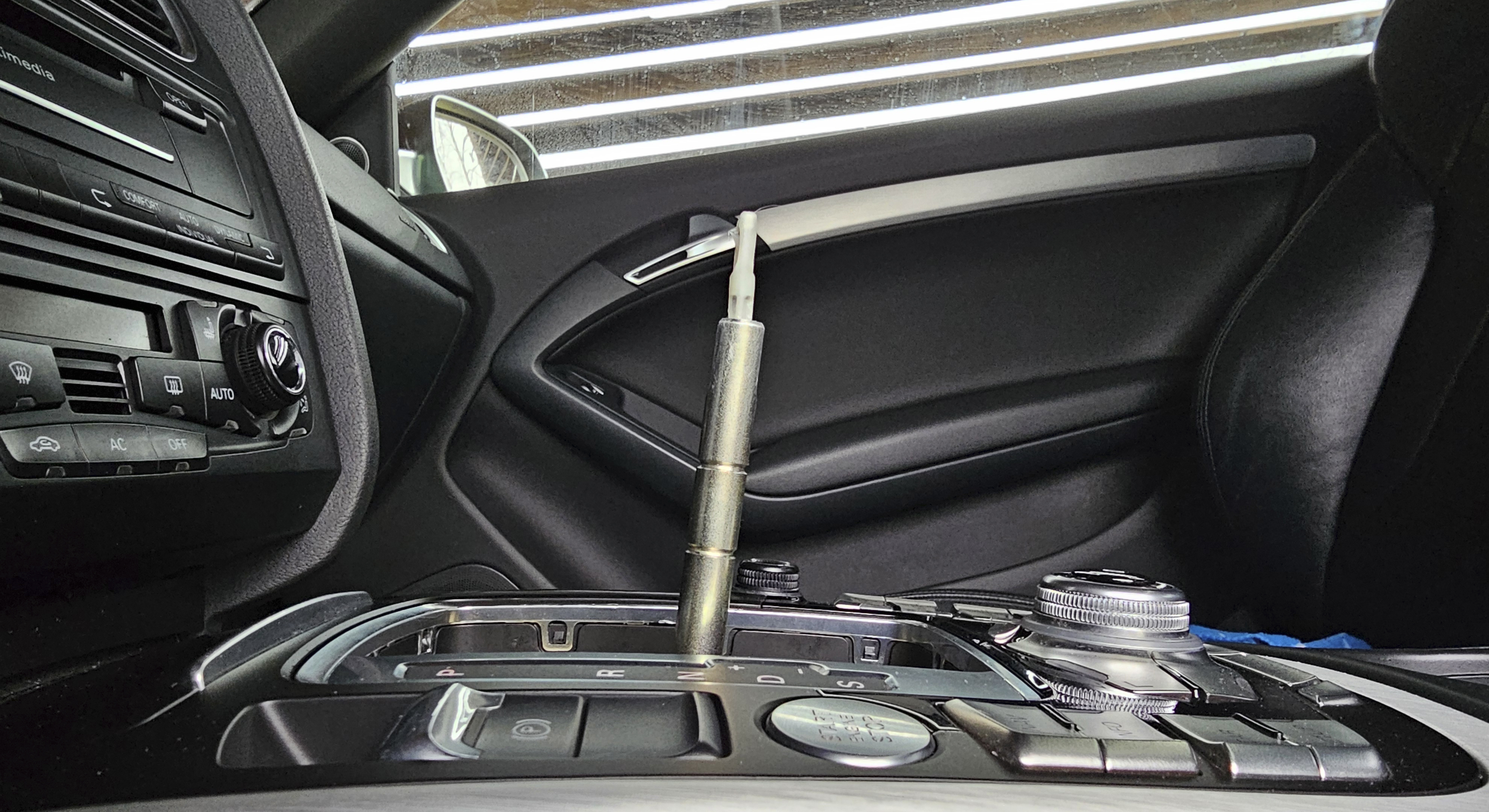

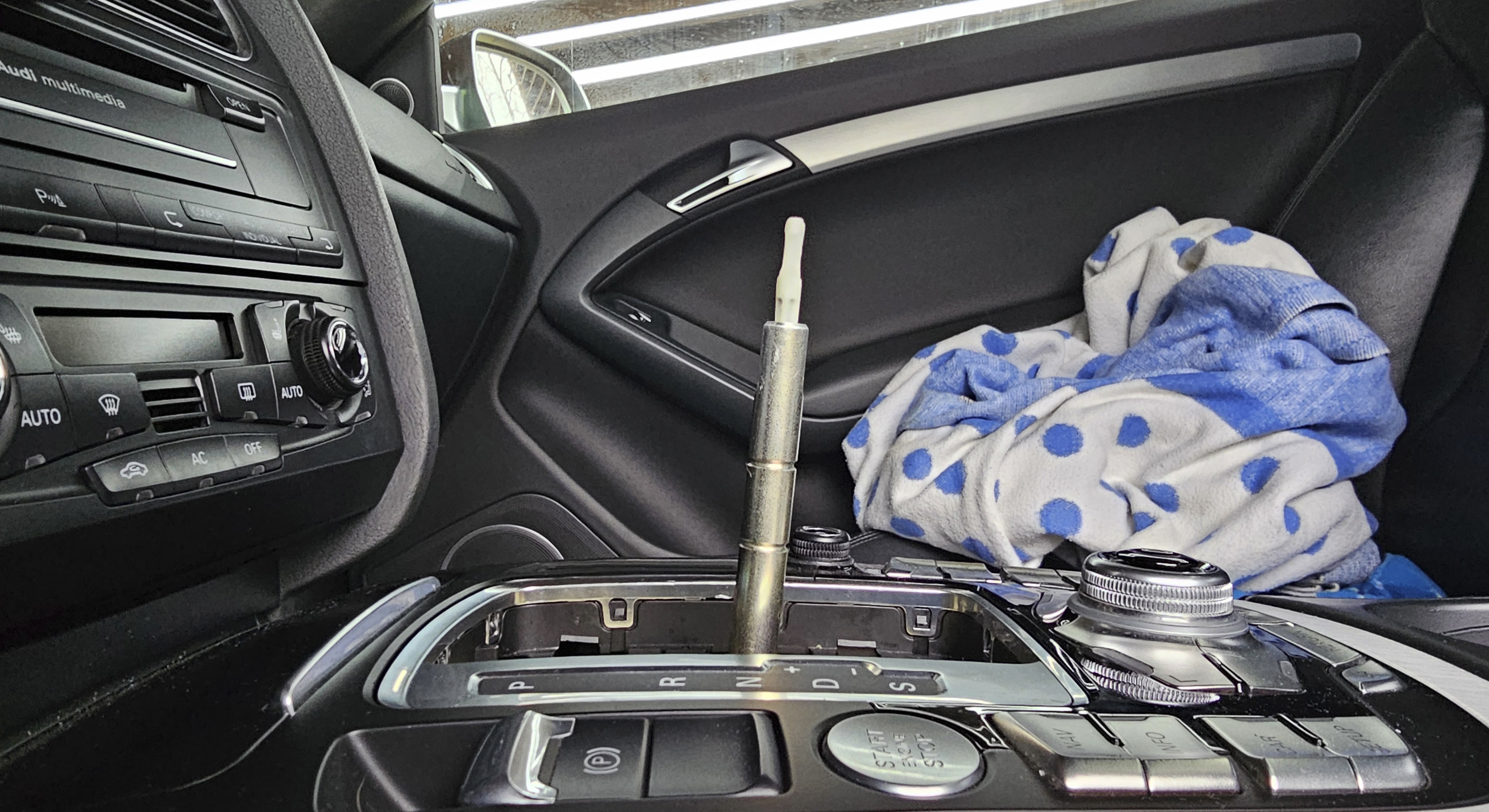

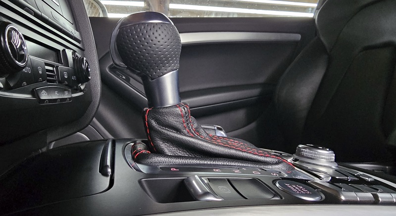

    Took me days and days but installed S tronic knob. Had some issues installing the knob. Heating and twisting went great, but the button got stuck in. I had sanded the white plastic down a lot, but still installing the knob after the hard press to engage the lever, button went in hard and stayd in. Also, while messing around one of the few springs popped out. It looks like the spring only mission is to not make button rattle when installed and has no other task. Now with only one spring it should work just fine.
    Anyway. Sanded the plastic down a lot. After hours and hours I finally figured out the problem. The white plastic rod was not 100% straight. Before I looked at it from the top and it seemed to be straight from every angle, but looking it from the side it was obvious that it was bent forward. So brought out the heat gun again and after 5 minutes the rod was straight as an arrow. And guess what. Popping on the knob, it worked perfectly. So, if you have problems. Make damn sure it is straight in all axes.
