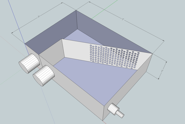

    You have an 01, so you really just need to think about a mounting place. You trash the hard metal piping coming from the 3 way breather hose on the valve cover, but keep the PRV (pancake) valve. Then run a line from that to a catch can. Then run another line from that catch can to where the PCV originally went on your TIP, with the PRV still in the same place (on TIP). And for which can you get really depends on you. But preferably you want one with a baffle, to catch the oil and just let the air get recirculated back. People also place steel wool in theirs, for added baffle. For example, the 034 Vortex one does not use a baffle. The design of that catch can is to have the blow by spin on the inside walls of the catch can, and have the oil stick to the walls and basically drip down and collect at the bottom while just the air goes out the top port of the catch can. Below are some examples of a baffle, but they come in different configurations (such as how subwoofer boxes are configured).

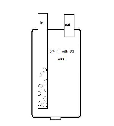

    so can i just run it like this?

    Yes, you can do that. But you would need to do something about the pcv port under your IM. It tee-s off on the crank case breather tube. You can just plug the port that the PCV valve goes into.
