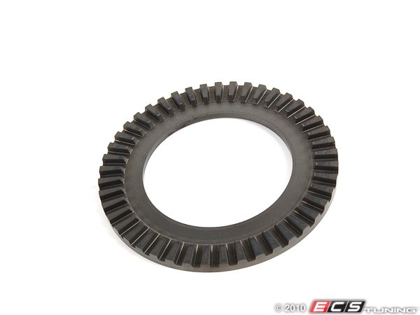

    Oh, but it can!
    http://www.ecstuning.com/Search/443614149A/ES8683/
    Cheaper one: http://www.ecstuning.com/Audi-B5_A4-...sor/ES2535280/
    Part# 443-614-149A "Rotor for Speed Sensor / For ABS"
    Fits rear wheels of Audi A4 (FrontTrak only), 1996-2001

    It is called as ABS Ring and I replaced mine a year ago with the below cheap ones from Autopartswarehouse..
    http://www.autopartswarehouse.com/sk...gs+Best+Seller
    When my previous owner did the brake/hub, somebody actually forgot to put these abs rings back. My ABS light was constantly ON for a long time. I then took it my mechanic and he said it is missing two rear ABS sensor/speed rings. I bought the above one, installed and everything was back to normal..
    PS: $12 more for the same branded part in ECSTuning????????
