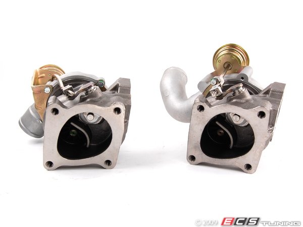

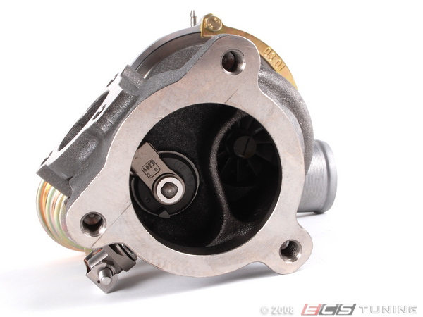

    K04 internals will not fit inside a K03 without machining. Basically you would then have a K04. K04s bolt right on, you just have to make sure you have the right exhaust housing flange as it differs from 2.7T to 1.8T applications See the images below.
    2.7T K04
    1.8T K04
