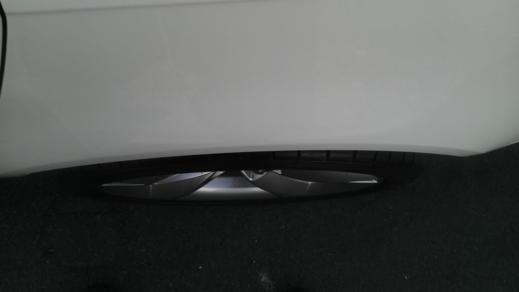

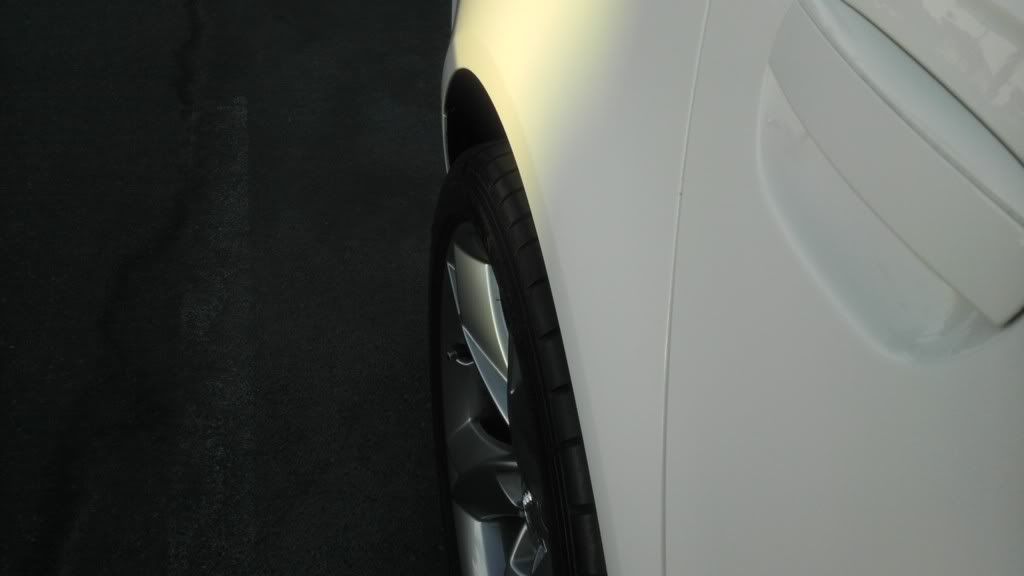

    I am running 19X8.5 with an aggressive et32 offset and Tires are 255/35/19. The tires are pushed out to just about flush with the fender. Ride quality is not demenished, if fact I feel the car rides better with this setup.

    Hey guys thanks again for your help, and SinCity your car looks great! Thanks for the picture to give me an idea.
